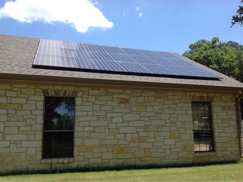

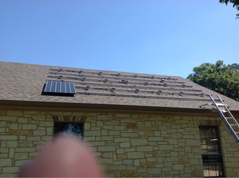

Made 693.987 kwhs in June, system started on the 8th of June, so July should beat that easy. A question, how often should the hardware on the racking system be checked and tightened. HS
Give it few month and then go over it. Rap the panel and listen for a rattle. Or listen to it during windy weather. I would recommend to use a torque wrench because of the stainless steel bolts are easy to strip and it is a pain to replace them. I don't know what the required torque is but I went through the pain of replacing few bolts.
How about picture?

Give it few month and then go over it. Rap the panel and listen for a rattle. Or listen to it during windy weather. I would recommend to use a torque wrench because of the stainless steel bolts are easy to strip and it is a pain to replace them. I don't know what the required torque is but I went through the pain of replacing few bolts. How about picture?
I think I put one up, but here you go. HS

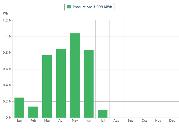

HS - we have the same 21LG300 with solar edge optimizers and this is the first six months - Jan and Feb this year we had 9' of snow so abysmal performance. Then in March-June we hit pretty decent numbers 1042KW the highest. It looks like we will make about 7800KWH this year.
