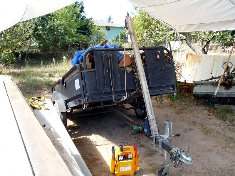

I used the camo remote winch to make a lift for my dump trailer. I used it for the first time today. It works great.
This is real simple: aluminum channel for a mast and a HF 3" block (pulley) hooked to the top of the mast. The mast has a inch-deep notch at the bottom to stay on the trailer tongue. Power is a HF 650/1200 amp jump start battery.
This little winch is easily worth the $70 cost.
Oh - After this photo I added a two ft rope to the winches hook to pull out cable so my hands aren't near a pinch point. This is not a tool you want to get close to.
