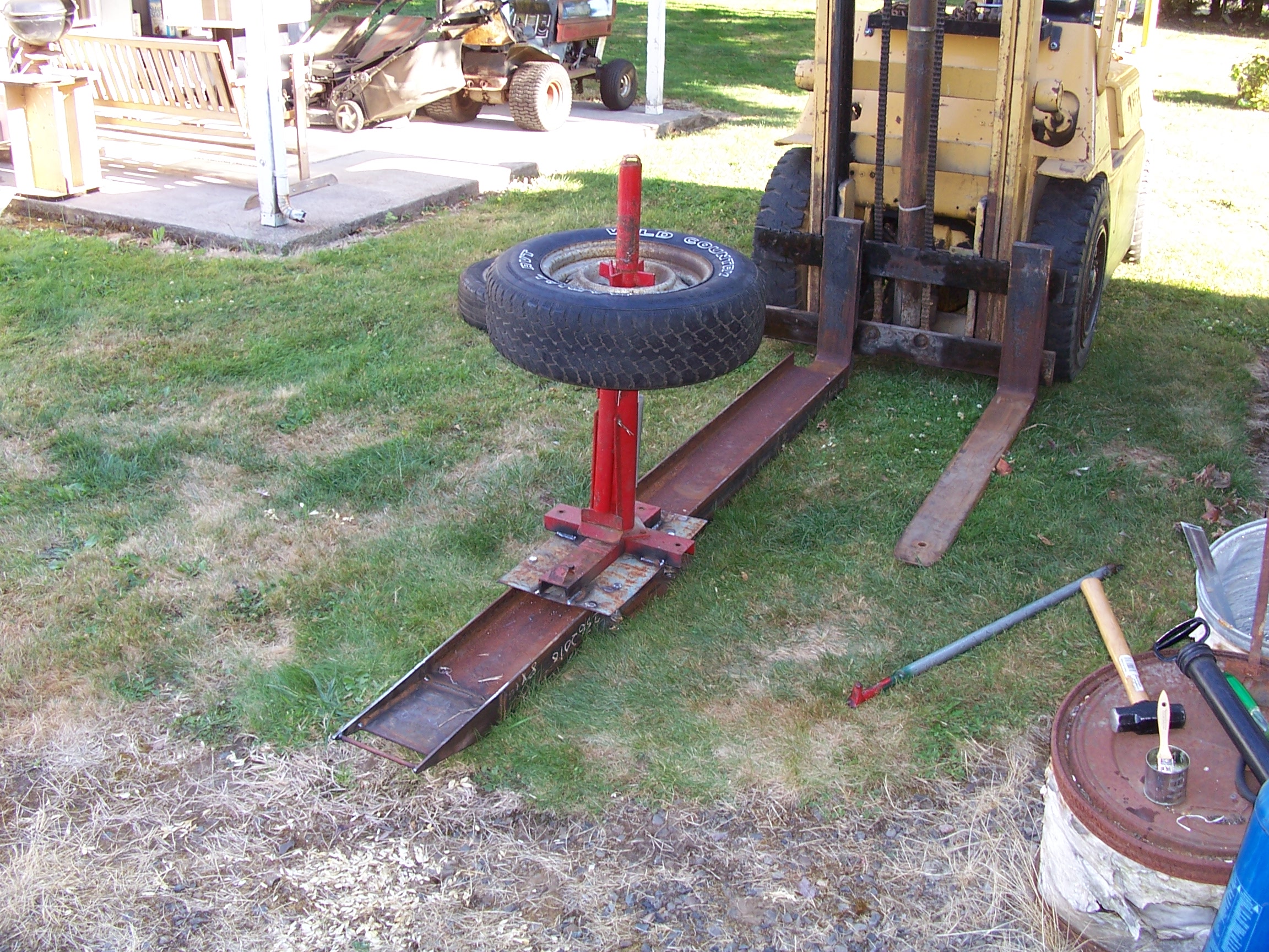

I will add that the HF manual (full size) tire machine is a winner, so long as you use plenty of bead lube (I use Dawn dishwash liquid and water, 1 part Dawn to 4 parts water). It has to be bolted to the floor, forget mounting it on a pallet, that don't work well. I also have the motorcycle tire changer that goes with it. Bad reviews on the HF website for a reason and that reason is, the upper arm needs to be welded to the vertical arm, not bolted. Once I welded mine, all was good. Changed a ton of tires on it.
   / Harbor Freight Tools that don't suck #13,849
Have mine bolted to deck of trailer, to the floor would be better.
   / Harbor Freight Tools that don't suck #13,850
I've got mine welded to a bracket that slips over one of my big forks, it holds it quite solid and can be tucked away when not in use. Last use was on a 15" full size Ford wheel, works fine for my purposes.
