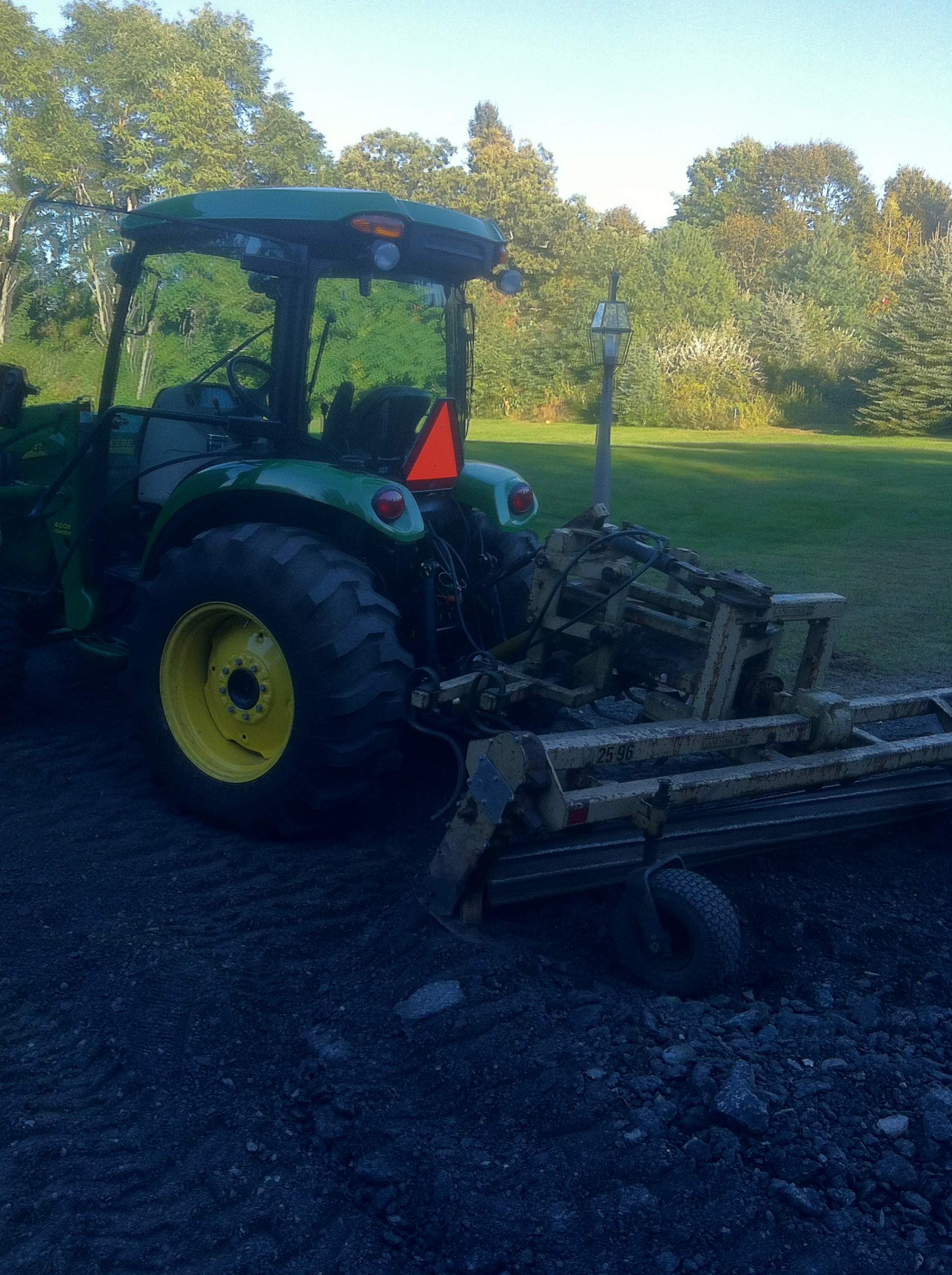

IMG_0417.jpg IMG_0419.jpg My two cents- I think you are getting a lot more than a tiller- most versions have a power angler left and right, some have adjustable scarifiers in front of the roller and they are rugged. I've used a friends old Harley on grading and it works like a charm. I did my driveway with asphalt millings last fall and borrowed a friends 96" Landpride- a serious rake-see pix. this one doesn't have teeth but rather blades-which was ideal for breaking down asphalt chunks as it pulls them up against an adjustable "screed bar".
