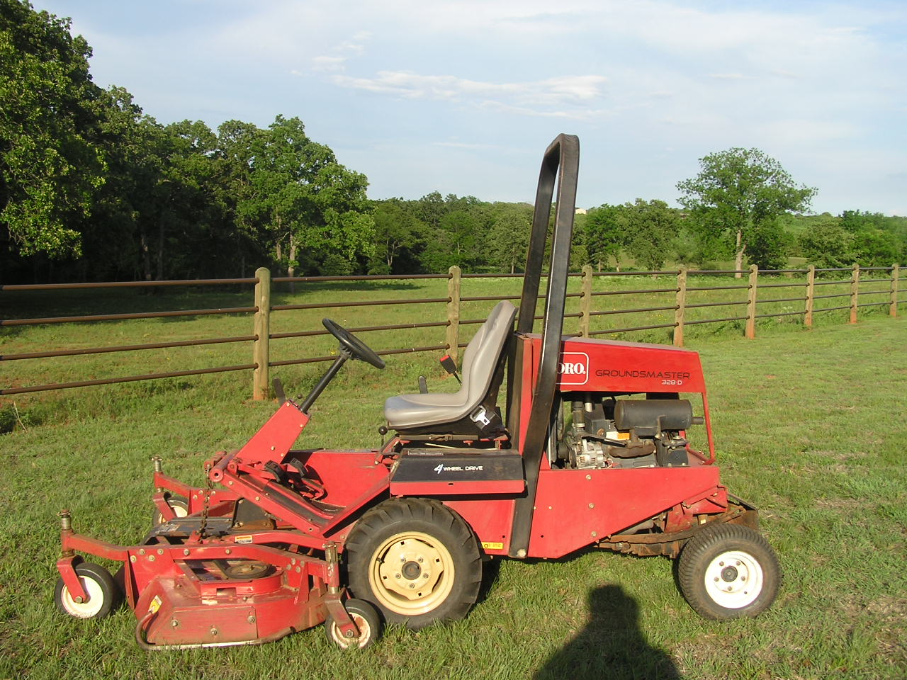

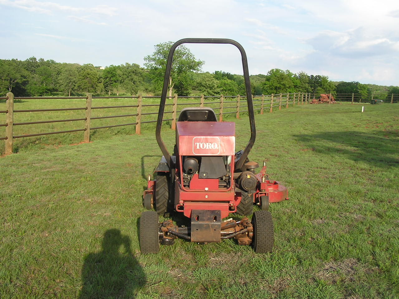

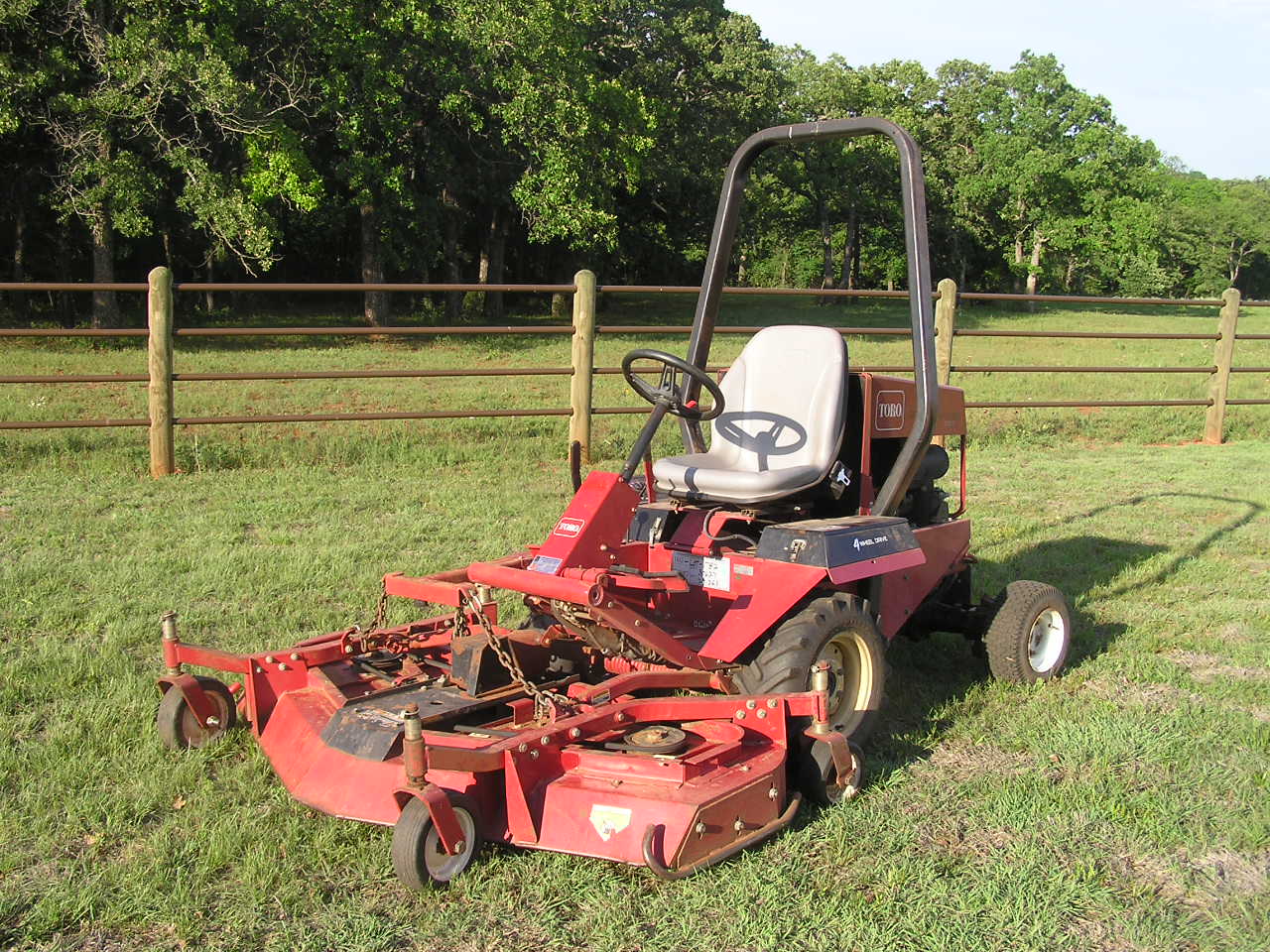

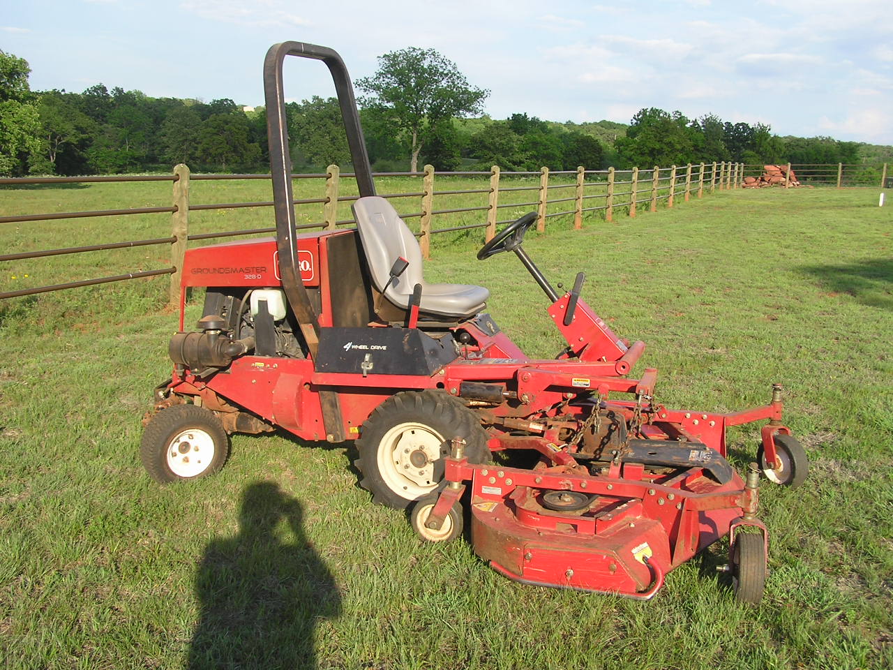

Re: Having problems with traction on your lawn tractor? Nope!
Found two Ditch Witch wheels and R1 tires on craigslist and the TORO is 4x4!

   / Having problems with traction on your lawn tractor? #8
I think if you have weight and lug tires on it, you have done all you can with that machine. I guess you could try chains, but maybe you need a different machine.
