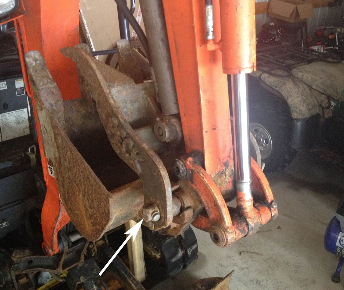

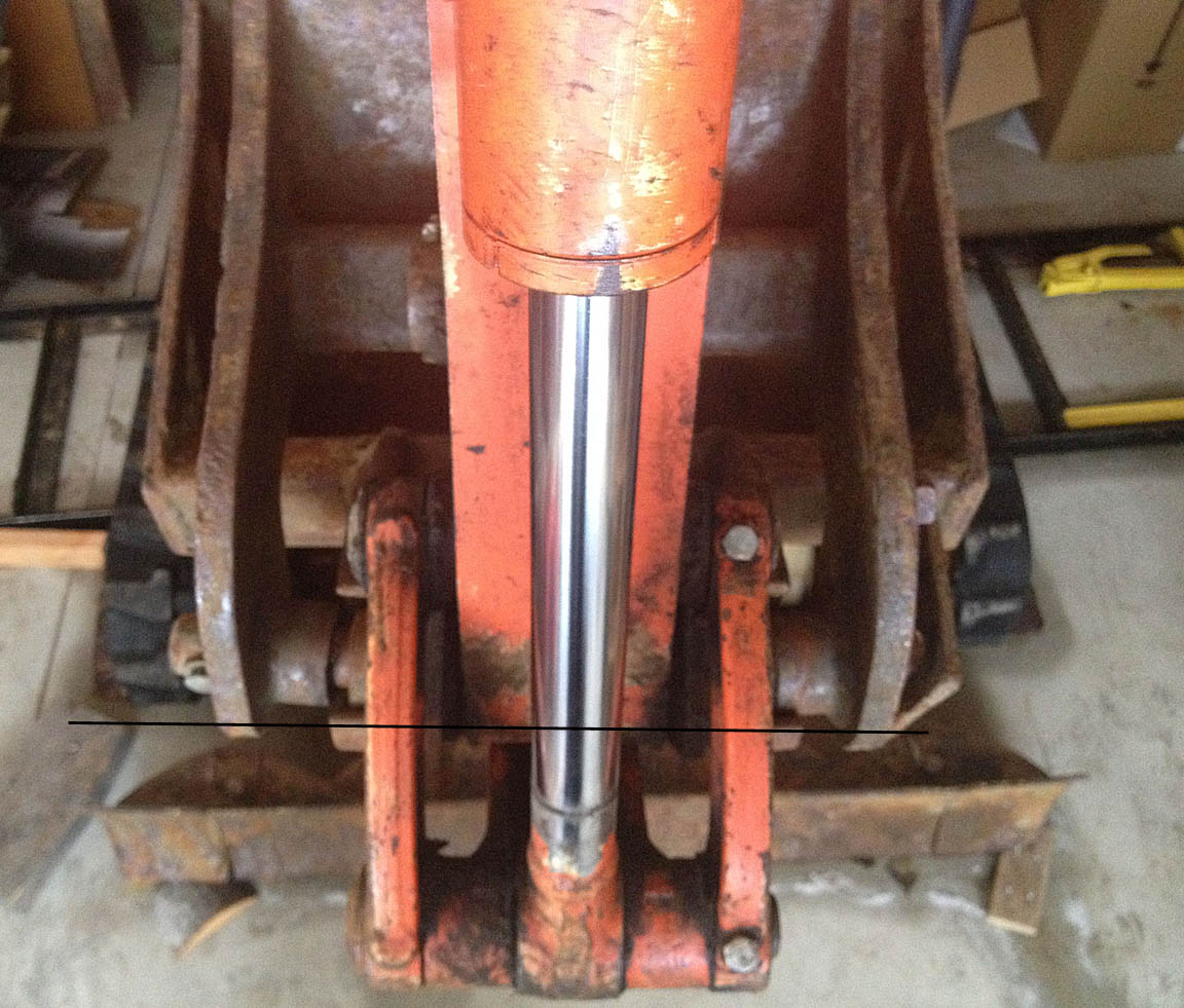

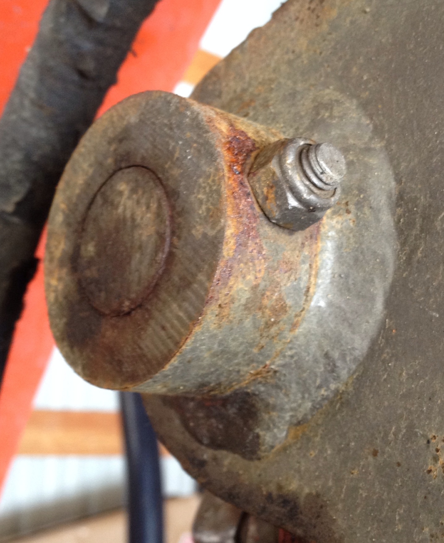

Looking for ideas here.
I recently purchased a Kubota KX41 mini Excavator. It has an aftermarket hydraulic thumb by PECK. The thumb pivot pin is bent.
I see 2 options:
1) put a Sawzall blade in the gap and cut it at the bend, replace it with a new pin. (seems to be 1 3/16" diam.)
2) Think of a way to use the bucket and thumb hydraulics to bend it back straight without removing it.
#1 is pretty straightforward. Cut it out, & excavator is disabled until all the elements fall into place. Bend the thumb arm back straight too and re-assemble. "Bend back straight" is easier said than done.
The reason I'm considering #2 is that it might be possible to complete #2 in a half hour, which is a fraction of the time to even locate suppliers of replacement parts. Has anyone had luck using tractor hydraulics to fix itself?
It seems worth a try so whats the risk? If it bends back halfway, it the gap may close then I can't get a Sawzall blade in there (to cut it at the bend). I know about bending pins they sometimes squirm & rotate themselves to avoid bending.

/ Help bending Bucket pin straight #2
It's hardened steel. Bending is really tricky and is best done red hot and in a press, then correctly heat treated.
Id just replace it.
/ Help bending Bucket pin straight #4
Just replace it, least down time to do that than work half day trying to straighten it. Might be worthwhile to figure out how it got bent so that it can be avoided in the future.

Looks like the collar bracket is bent, too. That may prevent you from pulling it out. A new pin isn't just going to slide in. Heat that bracket part orange+, too, in order to straighten it. You can buy short pieces of steel rod in sizes like that on eBay. All you then need to do is drill a hole for the retaining bolt. I'd pull it if I could, heat it up orange and peen it on an anvil. Put it in a charcoal barbecue for 10 minutes using a leaf blower or air line to get it uniformly hot.

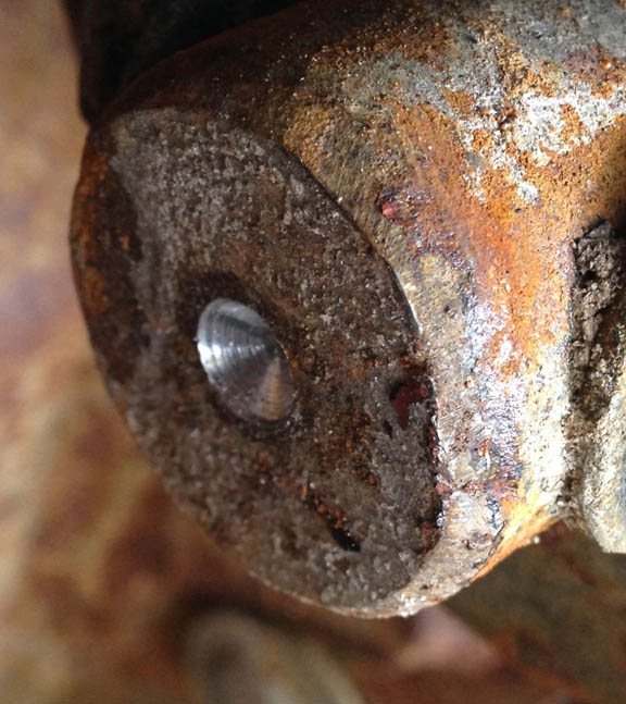

If it was hardened I doubt it would have bent. It's just a little excavator. But the hardness was worth checking so I put a drill to it and it drills like butter.
To "just replace it" I first have to get the bent pin out which may be the biggest part of the problem. I have to either bend it straight first then pound it out. Or cut it at the bend and get the two halves out, then dial 1-800-custom-pin and order a new one and spend half a day or more on that. :D
Or 2) bend it straight and call it good. Or straight-er. OR
If thumb still works ok I would leave it alone
That may happen if I can't figure out a way to bend it back with the tractor hydraulics!
Anyway I'm still interested in ideas to bend it without disassembly. No idea how it got bent, maybe it got hit with a larger excavator. Its possible it bent because a collar was lost, I'd expect it to have a collar to prevent the thumb clevis fro spreading not just that carriage bolt.
Good idea about the BBQ. I can blow with the shop vac. It would be ideal if I can get it straight enough to pound the pin out, then I can straighten everything even the thumb clevis.

I don't think it has shims in the 'middle', there is no rotation there because the pin has an anti-rotation tab. A shim or shims under the end cross-bolt collar is likely.

So I goofed around with the hydraulics for about 20 minutes then realized that since all the hydraulics available?.ALL pivot around this same pin there isn't much opportunity to put a force on the pin the way I need it to go. (Actually there IS a way, I figured out out what action bent the pin, so it seems I could rotate the pin 180deg then? dang thought of it about 18 hours too late!)

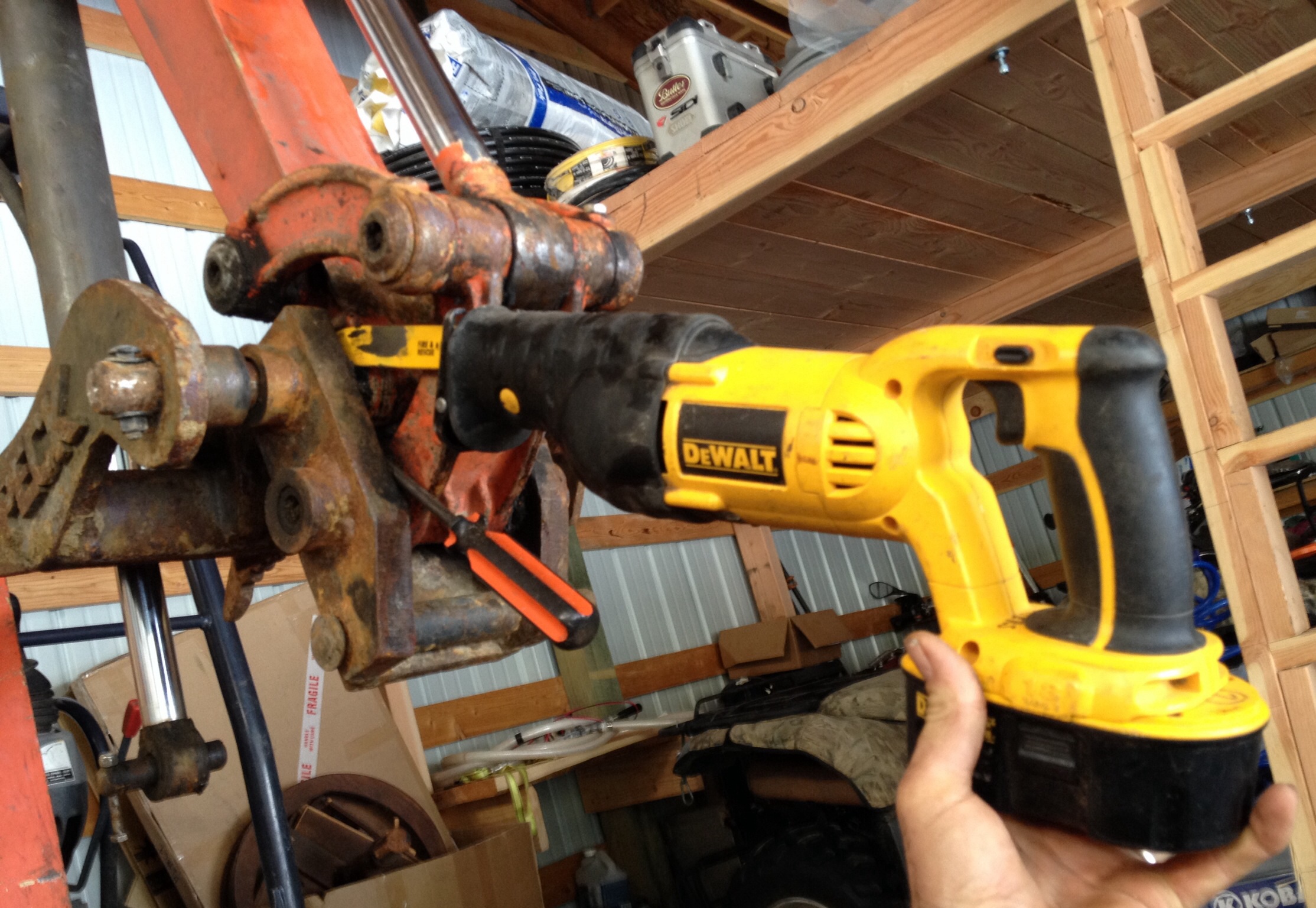

SawZall out and one 18v battery later, the pin was cut. It did NOT cut like hardened steel, the saw was pulling hard and sawdust was flyin'. I was all ready with 4 batteries, and it only took one battery. But it was so bent it still wouldn't come out so I had to cut it again. I changed batteries for the second cut and that one went even faster. Or maybe I have one wicked Sawzall?.or the pin was about as soft as steel gets. The 14" pin was bent about an inch high in the center at 7" (and a surprisingly sharp bend).

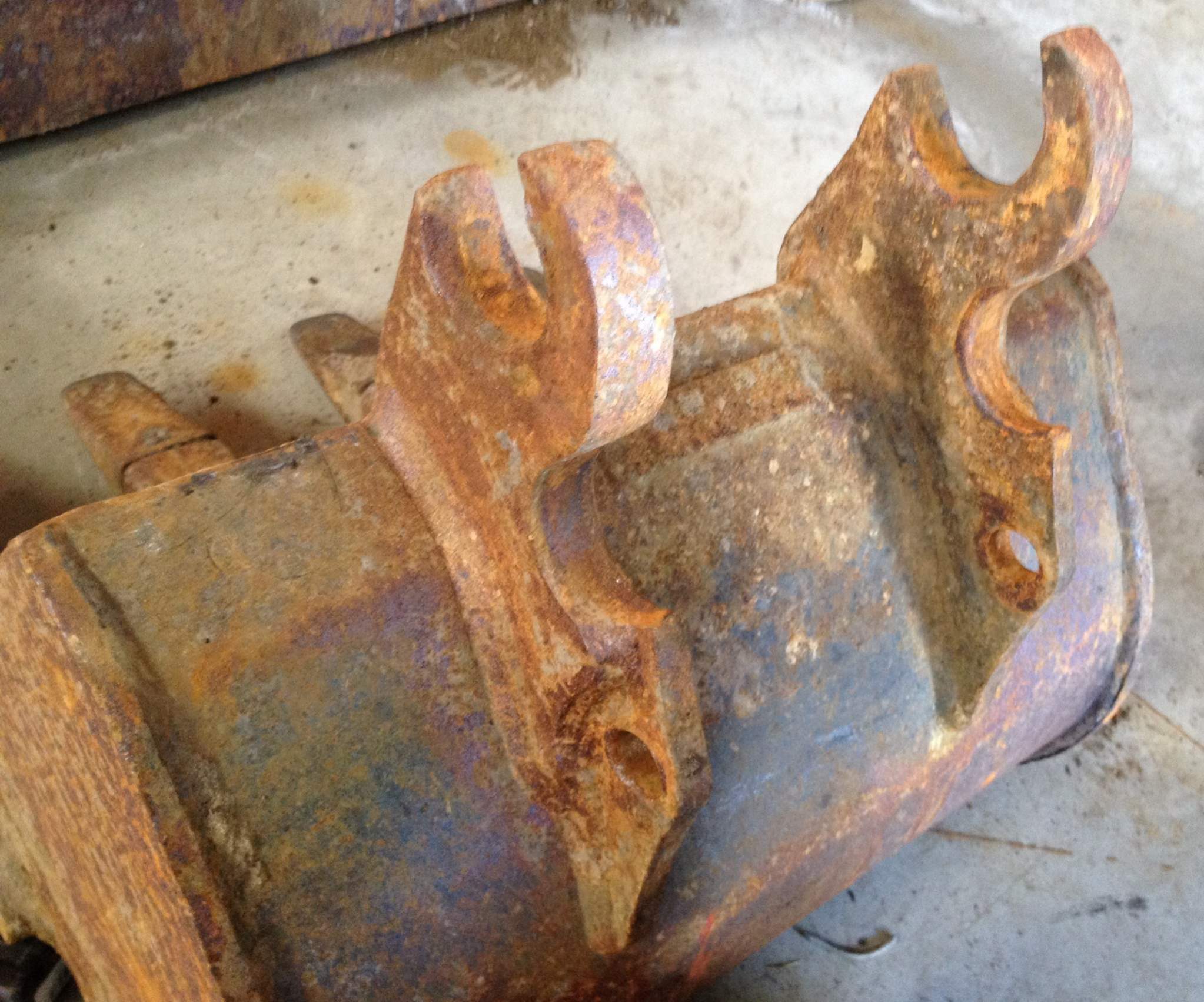

With the bucket off, I noticed the quick-release clevis (on the bucket) was spread out almost 1/2 inch! The problem was getting a little worse at this point so I called a buddy in town with a repair shop to ask if he had a hydr press. He said "maybe 40 ton, what do you need?" I explained it and he said bring it in so I loaded the bucket & thumb on the snowmobile (!) & headed to town. Well 50% D.I.Y. Is better than paying for the whole repair.
attachment.php
Pic of the quick-attach lugs on the bucket. The clevis plates are 1" thick steel and are spread 1/2" wider at the top than at the root. I'm quite happy that the whole bucket/thumb area is reasonably simple to tighten up.
That 1" plate was a bit more than I wanted to bend and you can see in my pic with 2 feet of snow theres no place to build a fire.
