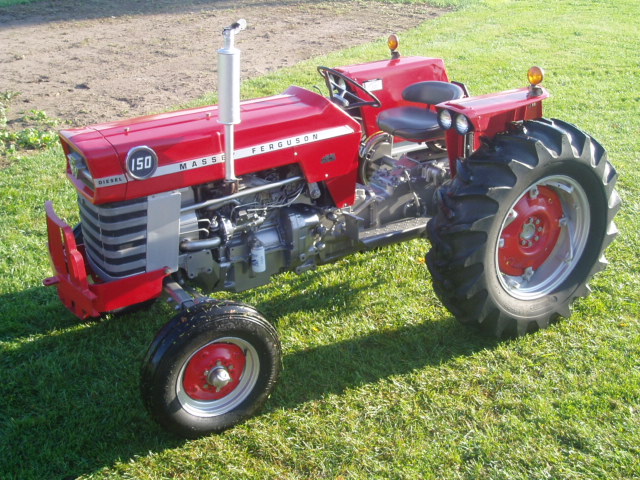

I grew up on Fergusons and Massey Fergusons. I lived in an area predominantly Deere and IH. Just us "small farm" kids had Massey and Ford. When one grows up "different" than every one else, you better know your opponents and know your own game or be prepared to take a LOT of abuse from peers. I had to know my Masseys to keep my friends in check.
Here's what that MH 50 evolved in to!
