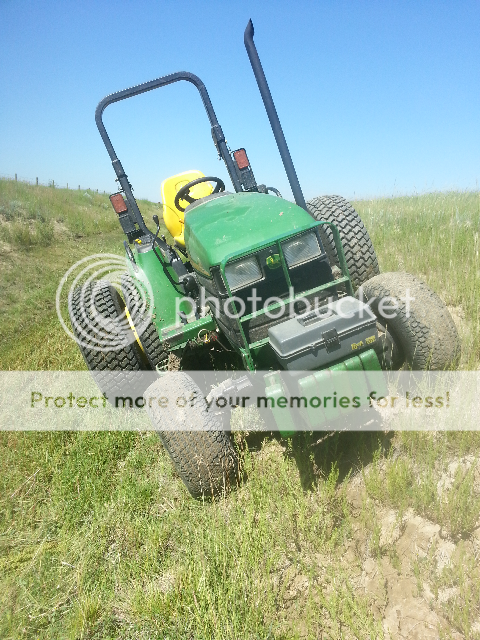

See if this helps

See if this helps
While that is a nice photo, it is not nearly as interesting as the tractor hanging upside down off of the hillside of the original.:D

The duals are not an aftermarket option from Deere or anybody else for that matter. I was given an opportunity two years ago to mow approximately 10 miles of irrigation ditch for the local irrigation district. I wanted to do the job because it was good money and I could save them money over using their own equipment. So I bought a matching set of tires on ebay and made my own duals. I seriously doubt that John Deere would recommend duals on my tractor but I can't say for sure as I never asked them. I looked at the job I had to do and the weight that I planned on carrying and the diameter of the axles and said I can make this work. I believe recommended tire pressure is around 16 lbs. I run at about 10 on the insides and 8 on the outsides just so that there is some give somewhere. If you want I can post pictures of what I did along with an explanation and what I would change if I was to do it again. Also the front tires aren't a John Deere option either. The tractor came with 27x8.50x15 tires. I bought rims from John Deere and made them an inch wider and installed 26x12x12 tires.
Very interesting. Thanks for the info, it looks like it is working very well.
