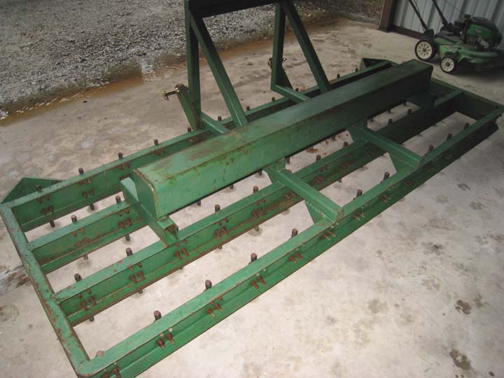

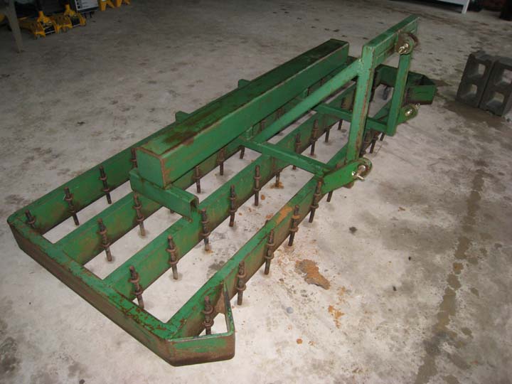

Does anyone know what this is called and where I could buy one? It looked exactly what I needed to rework my pastures after the disc work. I was told it was mfg by John Deere. However, I never got to inspect it in person. All I have are these pictures. Any help would be greatly appreciate. I asked the guy who sold it before I got there and he didn't know what it was. He just flipped it for a quick profit. Said he paid $450 for it and flipped it for $950.
My guess is a spike tooth harrow. However, I can't track anything like it down on the internet. Any links, pointers, leads would be greatly appreciated. Thanks.

It is a heavy harrow/spike tooth harrow.
Looks homemade.
   / Help - what is this and where can I buy one? #3
Arena rakes look different depending on the manufacturer, it seems, but I have seen some that look exactly like that.
Do a search for arena rake and you'll find some similar and might find something that will work better.

Spike Tooth Harrow
General information on "Spike Toothed Harrows":D
Cultivation may be required to get the field back to a reasonable level for working on.:D

in the UK this implement is known as a 'Dutch Harrow'.I use one of these behind the tractor when we are going to seed what was a corn field back to grass.on the front there is a wooden levelling board followed by 4 rows of height adjustable spikes.when used correctly i can achieve a seedbed for the seed as level as a football field,a highly underated piece of kit.
