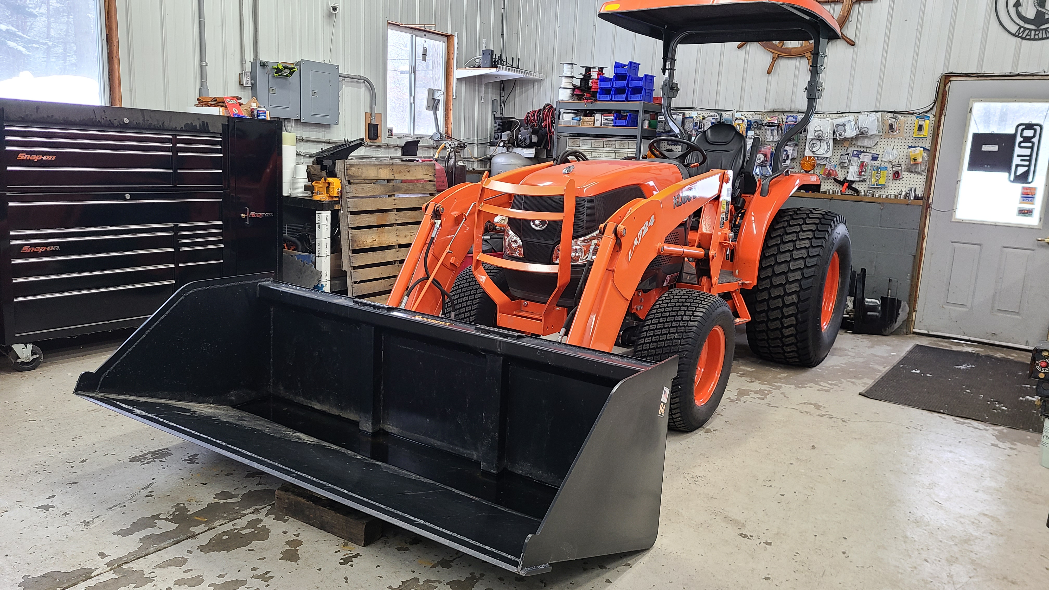

I can take measurements of mine later today if you wish
If it's not inconvenient. I'm curious about the bucket front edge to the back (interior dimension), and the height of the back piece from ground to top. Thanks!

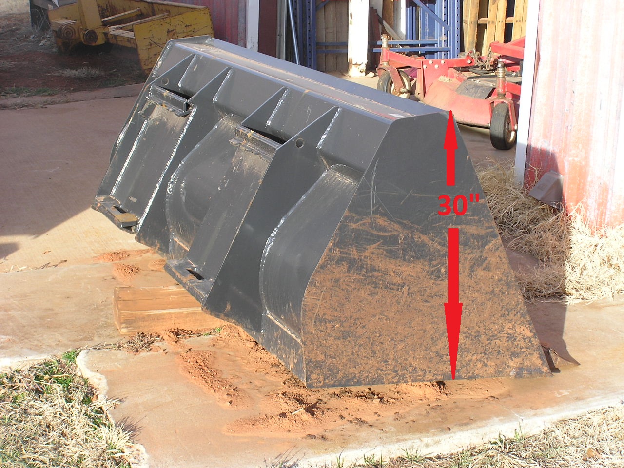

   / High capacity skid steer bucket for my FEL? #12
For comparison info, this is my 1 cubic yard 6 foot wide Versahandler V417 standard, general purpose bucket:

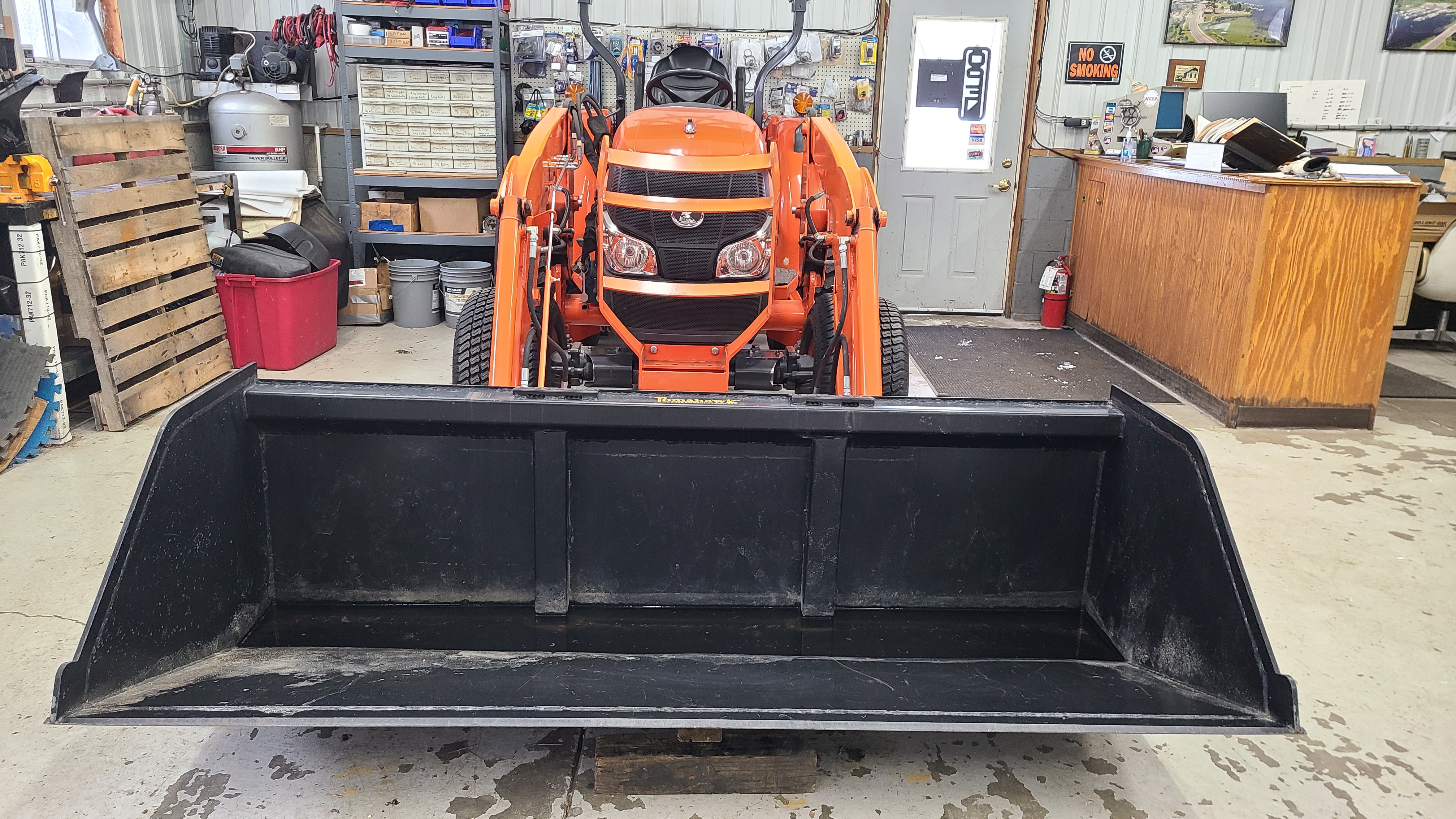

   / High capacity skid steer bucket for my FEL? #13
OK, in the shop now... for the 84in bucket inside dimensions 38" bottom and back of bucket is 24". I use this with a 724 loader and a full bucket of wet snow has some heft, I dont think I would want to have a larger bucket. I do have loaded rears but no 3pt ballast. With the 84" bucket it also gives you some width so you have to watch yourself in narrow areas. I use my bucket as a snow pusher, then pick up and dump at end of run. I like using this bucket better than my 72" snow blower, for anything under a foot and half of snow as I believe it is faster. Also in float I dont grab any dolomite as the blower will. Have not used the blower in a while... here are a couple pics on my 3240.

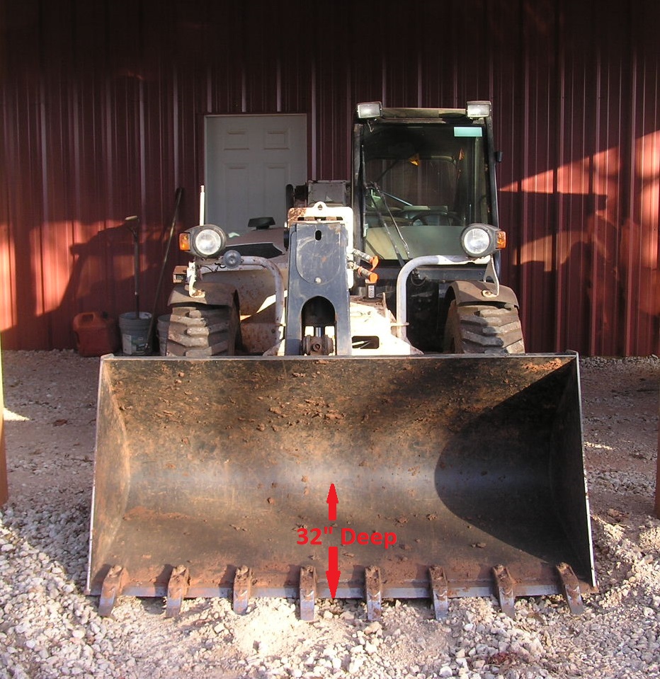

So is it crazy to use some of these high capacity buckets like I linked above on a tractor? I'm surprised by the lack of googe-able content about people doing this, or youtube videos. Am I abusing what are essentially skid steer buckets if I use them on a tractor?
Though of course it's good to see the posts of two of you using larger buckets, but Xfaxman seems to be using skid steer loaders.
Though the fact my dealer showed me some parts without shaking his head "no" lends some credibility to it, since he's quick to judge some of my ideas negatively ;-)
Though it was by email this time, perhaps I simply couldn't see the head shaking.
I would probably get the most volume I could find, but if the thing is 33 inches tall, or more, maybe I wouldn't even be able to see where I"m going, or maybe the bucket can't curl up properly, or, or, or .... I don't know.

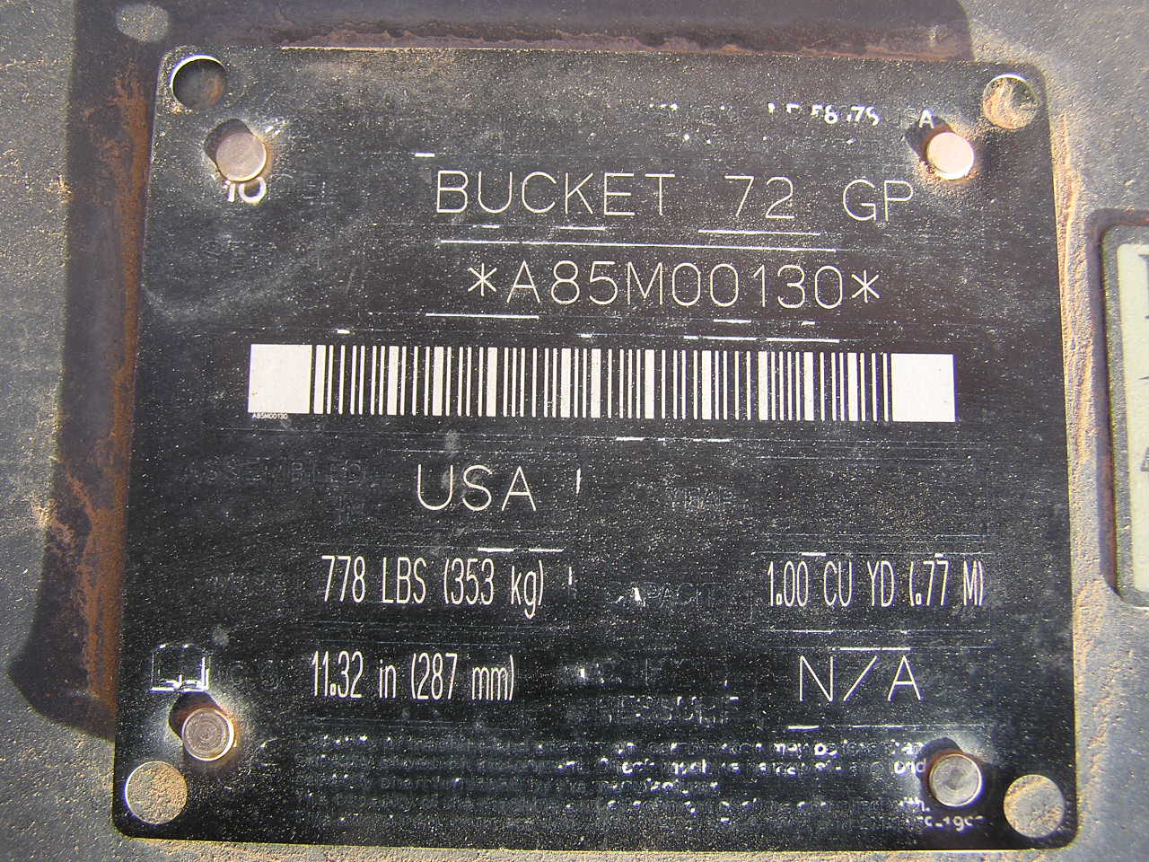

I bought an oversized bucket from my dealer. It's only 5' wide compared to the 6' one that came with the tractor, but holds about twice the volume. Has a cuft size on the label, but I don't recall the amount right off. I use it for wood chips, saw dust, compost, fire wood....thinking about adding a back screen to it for firewood. I added the toothbar to make it easier to rake up around my wood sheds.
