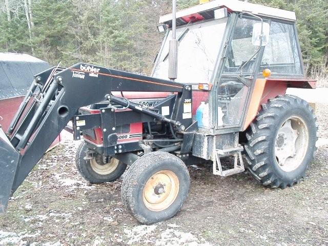

I'm going to need new front tires on my 2WD Ford Industrial, and would ideally like to have more ag type tires. I could go 3 rib, but am not crazy about how they tear up turf. 4 rib fronts offer the vague promise of "flotation". I often have to feed out round bales in extremely muddy conditions, so my thoughts are drifting in that direction.
Years ago I had use of a neighbors IH 684, it had pretty wide implement type front tires. I couldn't help but notice that the front end didn't sink in when I was haying on wetland fields. So I'm wondering about getting 8 inch or wider rims and going in that direction.
Any thoughts would be appreciated. :)

I never liked using the truck tires especially worn smooth tires on the front end as it didnt steer well in the mud without brake steering. They just tend to slide sideways and plow a furrow rather than turning the tractor. I preferred the 3 rib design or even 4 rib in as wide as possible 10:00 x whatever your rim diameter will give excellent flotation and due to the width, give less ground pressure to avoid tearing up the ground so bad. Some of the 4 rib trailer tires (9:00x16) would likely work well also.

I use BF Goodrich Radial Long Trail Load Range R LT 245 / 75R16 on my tractor. They are 10 ply tires that are rated for 3040 lbs at 80 psi.

The tractor I need tires for is new to me, and needed kingpin repair before I used it. I did the repair and tried the loader, moving manure on the level but with a muddy surface. The existing truck tires (good tread but sidewalls falling to pieces) were no less than worthless steering in the mud. Since a lot of my loader stuff is under similar conditions, I need to move on to considering other options. I don't want to give up on increased flotation, I'm wondering about wide (11L) tri-rib fronts. Any thoughts?
