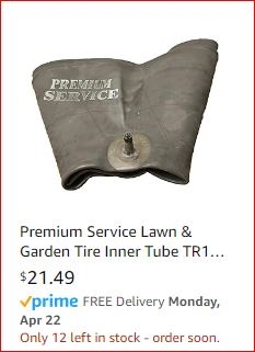

I bought tubes for my 1435 tires (your size) on Amazon and they were the more expensive ones, but they are twice as thick as the first go-around.
Two suggestions come to mind:
Inspect the wheels for weld flash that may puncture the tube because the wheel was originally designated as tubeless use.
Be careful loading the tube into the tire. Some wheels may have a hole for the tubeless valve that's too small for a tube. You'll have to drill it larger
diameter.
