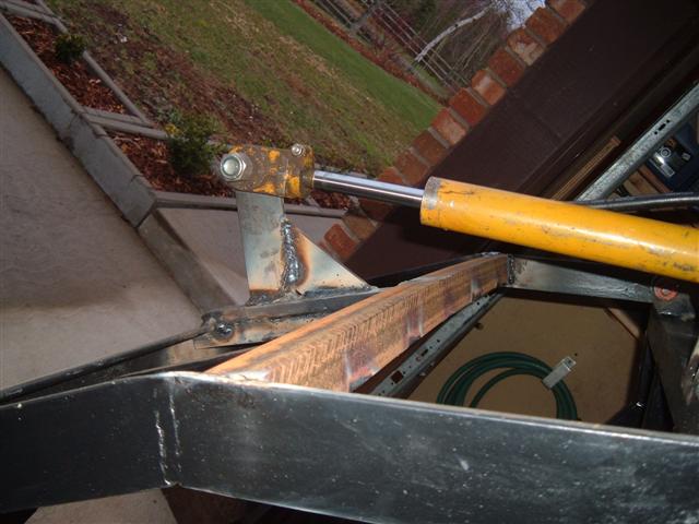

Did some reinforcing tonight on cross members and arm support. I broke the weld where the rod connects three times before I decided to brace it. /forums/images/graemlins/confused.gif It still bows a bit, but it will have to do for now.

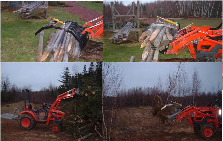

Here's a few action shots, it was starting to get dark in the last couple. I had it in the back of my mind that I could also rip out some small trees and roots as well with it, that's why I added the teeth to the bottom rippers and didn't extend them too far out to still have enough power to curl roots out of the ground without putting too much force on the loader arms.
