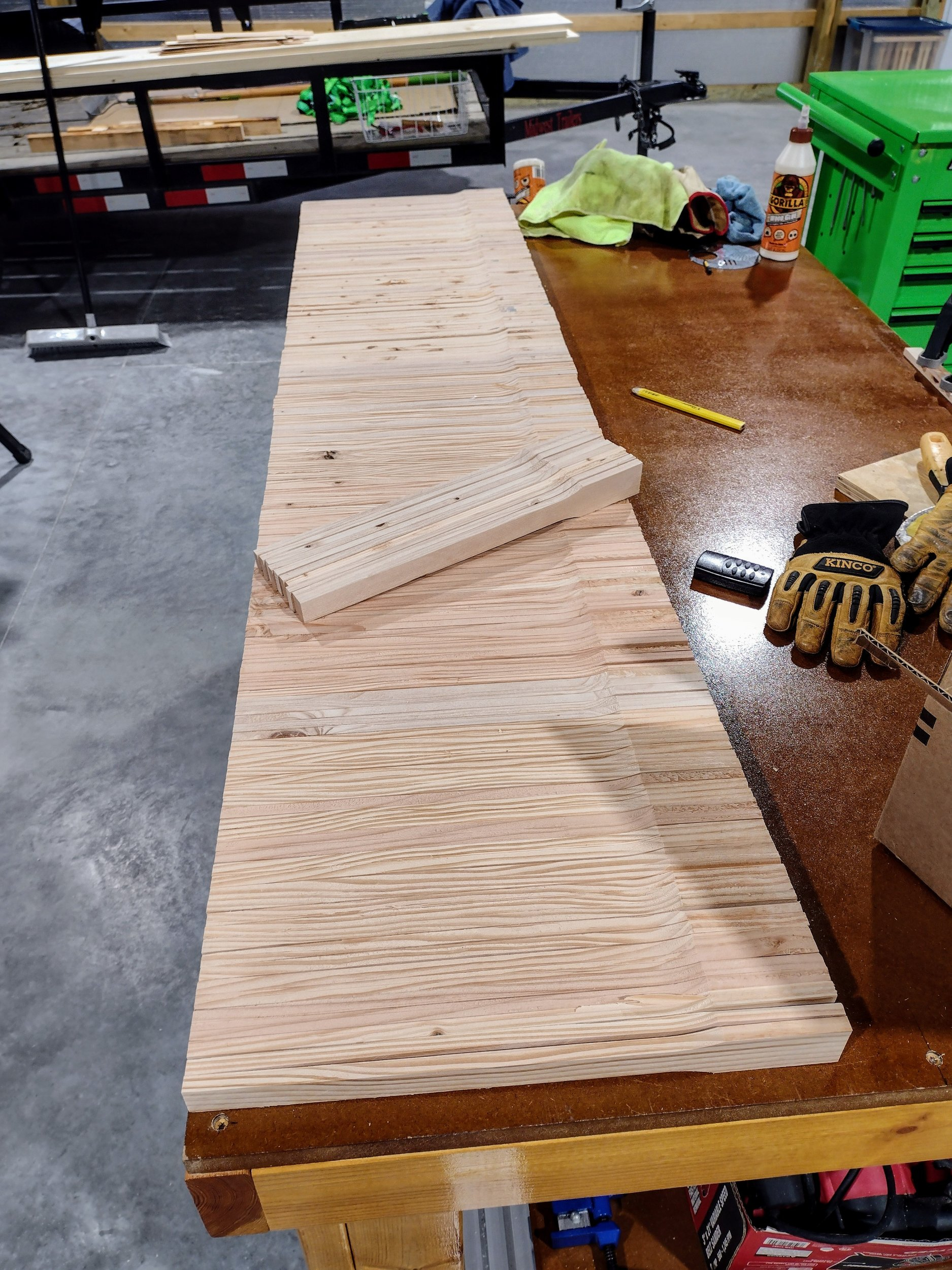

How do you make those sidebars efficiently?
All the best, Peter
I use 2x4s. Cut into 15 9/16” lengths. Then I lay them flat and use a 1” dado blade to create the taper on both sides of the 2x4s. Then I rip them all 3”8 wide. Basically zero scrap!

Thanks! I was having trouble imagining how to make the taper in an expeditious manner.

Some folks taper them individually on a router table, which is much more tedious
   / Honey bees #145
I use a jointer for the taper. Before cutting the ends out, I have a jig made to hold the 2x4 or 2x6 to cut the top & bottom bars notch using the dado blade.
