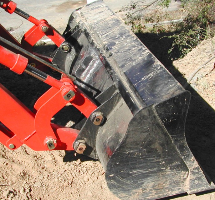

What surprises me is how lightly built some of the buckets really are. Below are some photos of buckets that you might want to review, any of the rolled or folded lip buckets are inadequate (IMHO) if you want to add hooks.

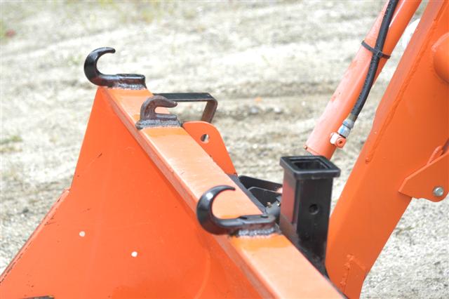

Good side-by-side comparison photos, Bob. I, too, am surprised by
how wimpy some of the standard buckets are. At least the Kubota
and JD tractors offer upgrades to better buckets. I don't know if
all of them do, but the HD Kub and JD bkts are very nice. The Kioti
std bkts are very impressive, too, with doubled top lip and full
side reinforcement. I posted this photo of the CK20 bkt in another
recent bkt hook thread.

There are a couple very long threads about buckets and loaders. What surprises me about some of the buckets is how small so many of them are on some pretty big tractors. I'm sure if you put a low capacity (small volumn) bucket on a big tractor it will "feel" more powerful than the same size tractor that has a bucket that hold 35% to 50% more, but you actually do less work with those tractors. Personally I buy a tractor to reduce my work, simple things like bucket shape, construction and capacity can have a dramatic affect on the total time it takes to complete a task.
For example if 2 tractors, each 35hp have similar capacity loaders, but one has a bucket that is 35% smaller (less capacity) than the other, then the tractor with the larger bucket may get the job done roughly 1/3 faster than the other tractor.
Similarly if 2 tractors come without bucket hooks, and one has a heavily reinforced top lip and the other has a simple folded top lip and you want hooks, the process is easy on the reinforced bucket. But by the time you pay a welding shop ($65/hour) to reinforce the light duty bucket with angle iron, you probably are better off spending more money up front to get the heavier bucket in the first place!

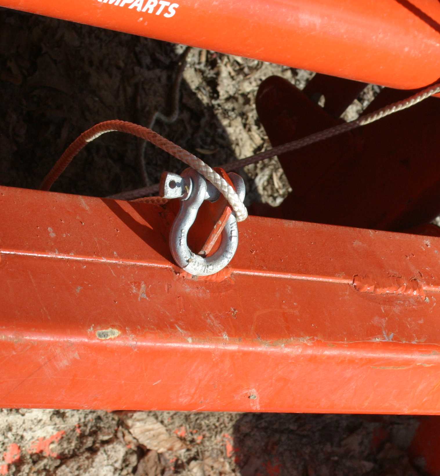

...The final photo is a Kubota B3030 bucket, this is a small & ultra-light 30hp tractor, suprisingly the bucket has a double fold along the top of the bucket and welded reinforcements on the lower corners. It does not have reinforced sides.
I know I was amazed at how "flexible" that top upper lip was on my own B3030. I clamped a 12 inch ( or 14"..??) Cresant wrench on it and could work it back and forth..and though..NOPE!! Aint welding hooks on this thing!! Took a piece of 2 x 3 angle..1/4" thick all the way across it and boxed that top lip in..and welded the hooks to the 1/4" angle instead.
I had a lug/bracket welded to the center..so I can attach anything using a pic. Clevis type slip hook...straight pin type clevis...etc

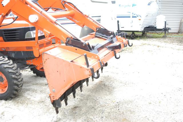

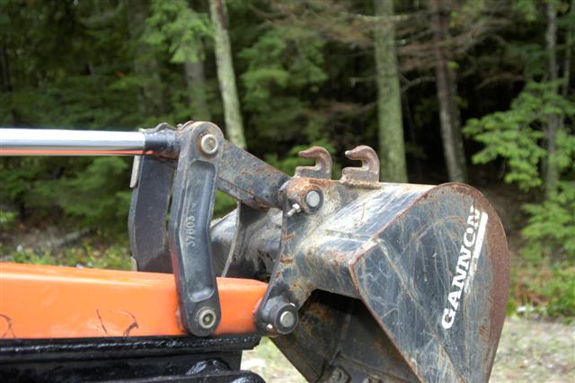

Here's my setup. Used it this week to move and drag logs. The combination of slip and grab hooks works very well for many jobs.
