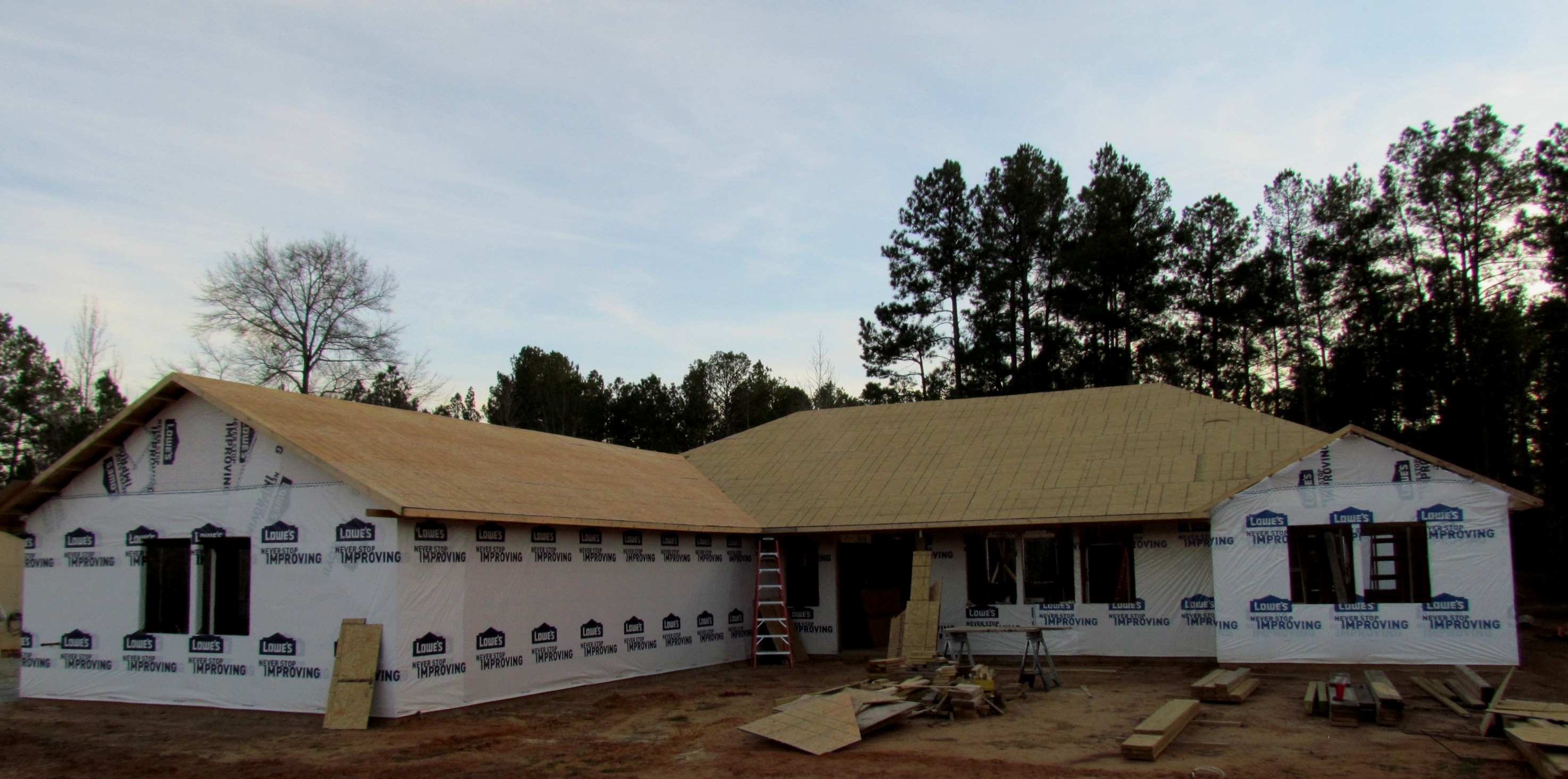

During the week, Dad has been running wire, water lines and gas lines. He's doing a good job and he's just about done roughing everything in. We've added everything we can think of!!!!
On the weekend, I've been installing the decking. Neither of them can do anything up on the roof, so Dad moves the backhoe around so I can get the OSB easily, and Mom keeps me in nails. She will climp up the ladder about halfway and stretch to hand them to me. She refused to go up one more step. :)

Looking good. Hope your back is alright! What type of roof are y'all planning? Composition or Metal?
   / House for my Parents
#230
Going with composite shingles. We are going to have somebody else install them. It's too slow to do it myself and there are too many other things that I could be doing while they are getting that done.
