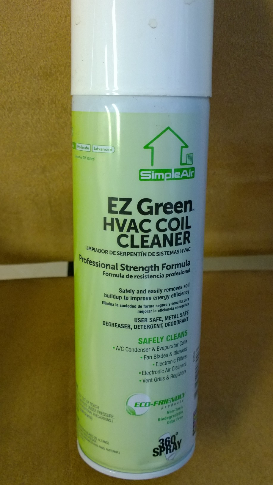

coil cleaner spray from the box store

i get mine at lowes or home depot ( coil cleaner )
   / How do you clean your a/c condensor #10
from lowes:
