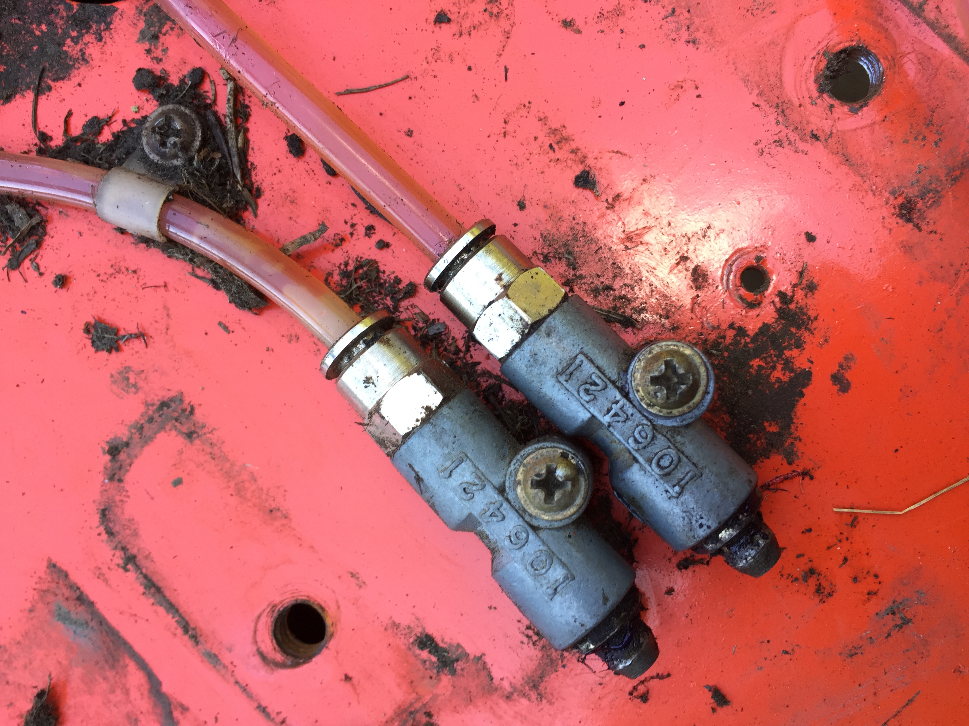

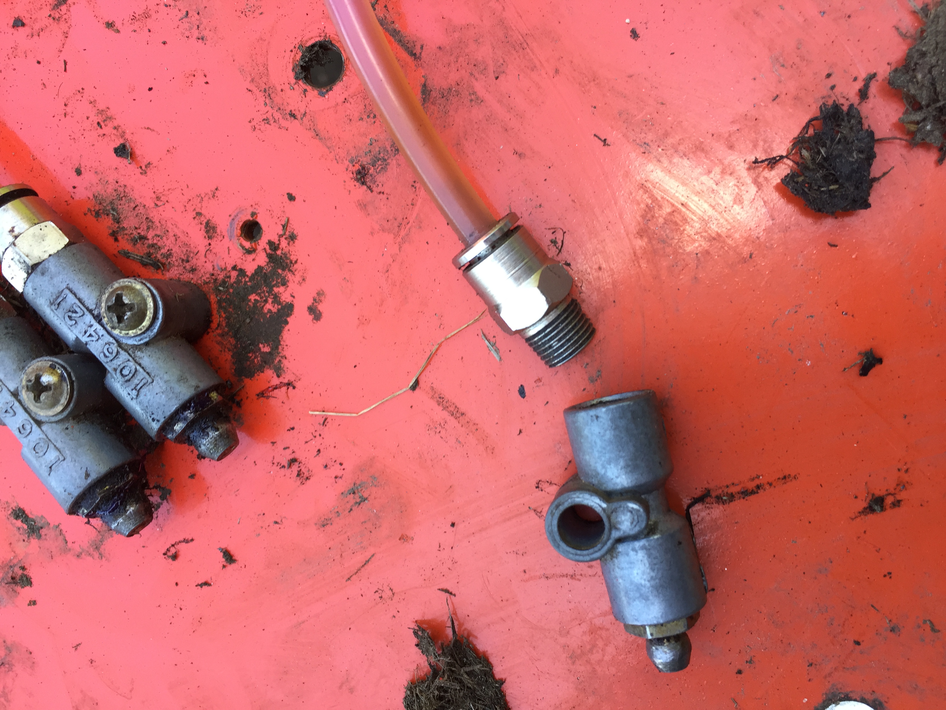

May 21, 2018 / How does this fitting come off the hose? #1 Msamt Gold Member Joined Nov 15, 2013 Messages 424 Location Enfield, NH Tractor Kioti Dk45SE This is from a Kioti rear finish mower, remote grease fittings.I have replacement hose but cannot find how this fitting works, any help? The remote fitting line has been rubbed by a loose belt, crappy design in my opinion...

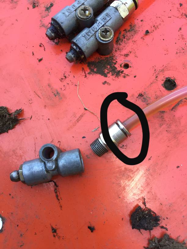

May 21, 2018 / How does this fitting come off the hose? #2 S SiLversLeigh New member Joined Aug 25, 2016 Messages 2 Location st. clair, MI Tractor working on it Squeeze the fitting in where the tube goes in and pull the tubing out. May have to push tubing into fitting while squeezing to get it to release

May 21, 2018 / How does this fitting come off the hose? #3 S SiLversLeigh New member Joined Aug 25, 2016 Messages 2 Location st. clair, MI Tractor working on it Squeeze here
May 21, 2018 / How does this fitting come off the hose? Thread Starter #4 OP Msamt Gold Member Joined Nov 15, 2013 Messages 424 Location Enfield, NH Tractor Kioti Dk45SE SiLversLeigh said: Squeeze hereView attachment 555178 Click to expand... Thanks! That’s what I was playing with, thought there may have been a ferule under it wasn’t sure how hard to yank on it?

May 21, 2018 / How does this fitting come off the hose? #5 kennyd Advertiser Joined Jul 6, 2003 Messages 13,845 Location Westminster, MD Tractor John Deere 3720 CAB/TLB, JD455 Watch this video to see how they work: Quick Release Pliers for Push-To-Connect Fittings - YouTube
May 22, 2018 / How does this fitting come off the hose? Thread Starter #6 OP Msamt Gold Member Joined Nov 15, 2013 Messages 424 Location Enfield, NH Tractor Kioti Dk45SE kennyd said: Watch this video to see how they work: Quick Release Pliers for Push-To-Connect Fittings - YouTube Click to expand... Even better visual! Thanks!
