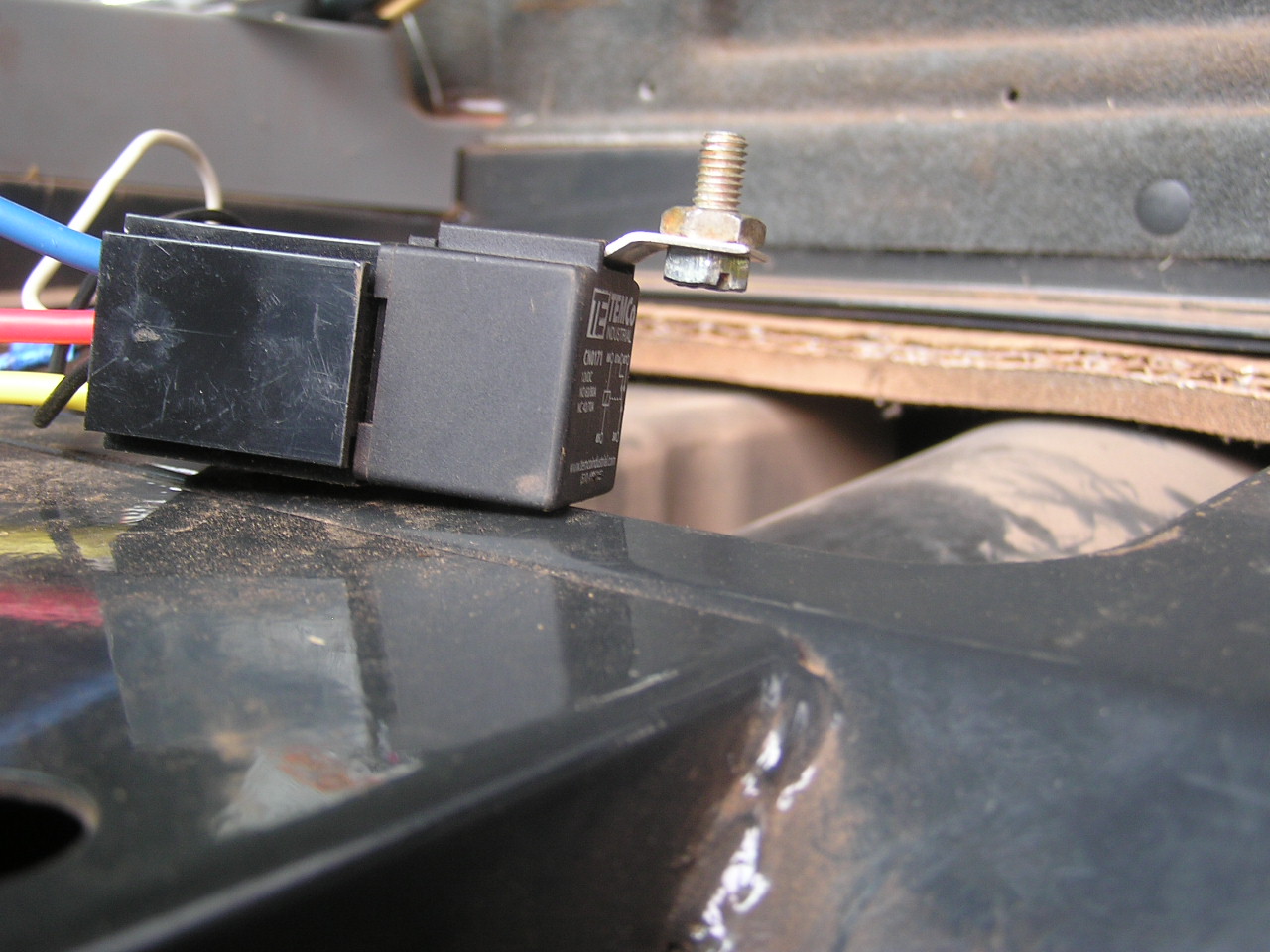

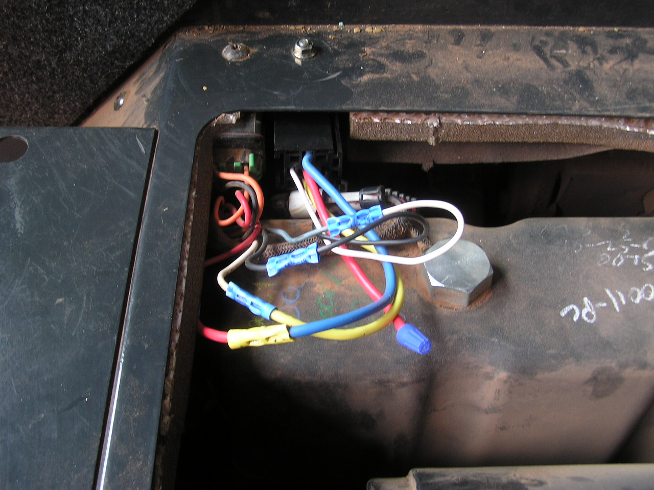

Not many hours compared to yours, about 270 hours when we traded it in to get the Traction Control that is on the new G Series.

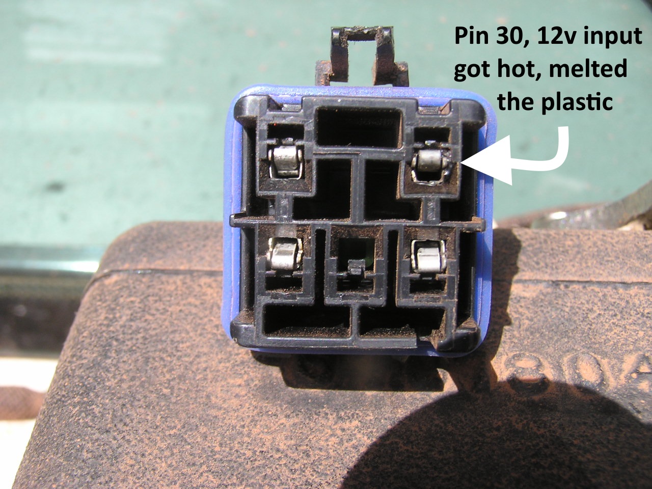

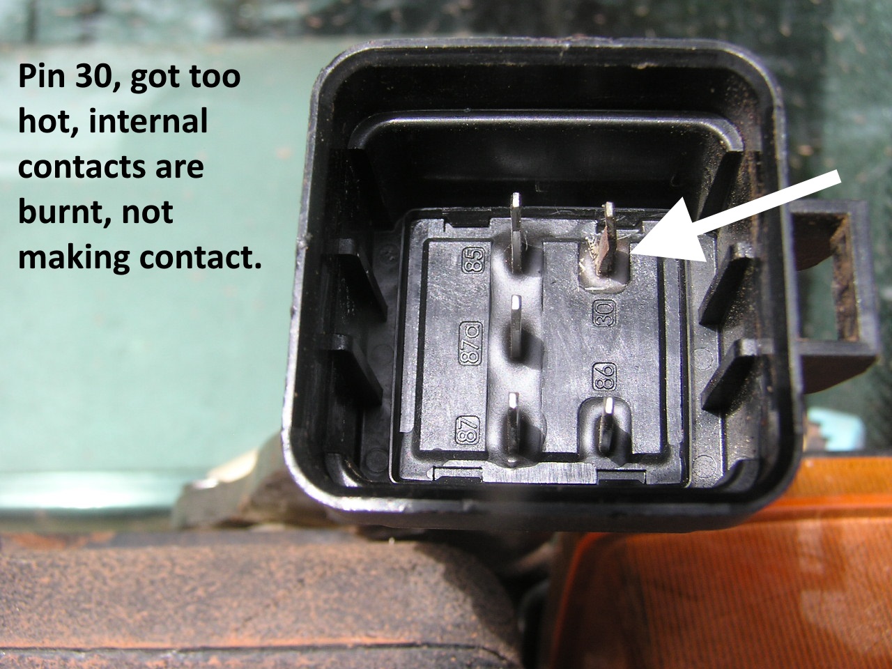

No major issues on the F Series, one problem was the AC condenser fan quit running, replaced the relay under the seat.
It worked a few months and failed with the same relay pin burned. Ordered the next higher amperage rated socket and relay. Problem solved.
Modified the mounting hardware, it was hard to get the nut on the bolt from the bottom, before.
Now the bolt is secured to the bracket and another nut put on top.
