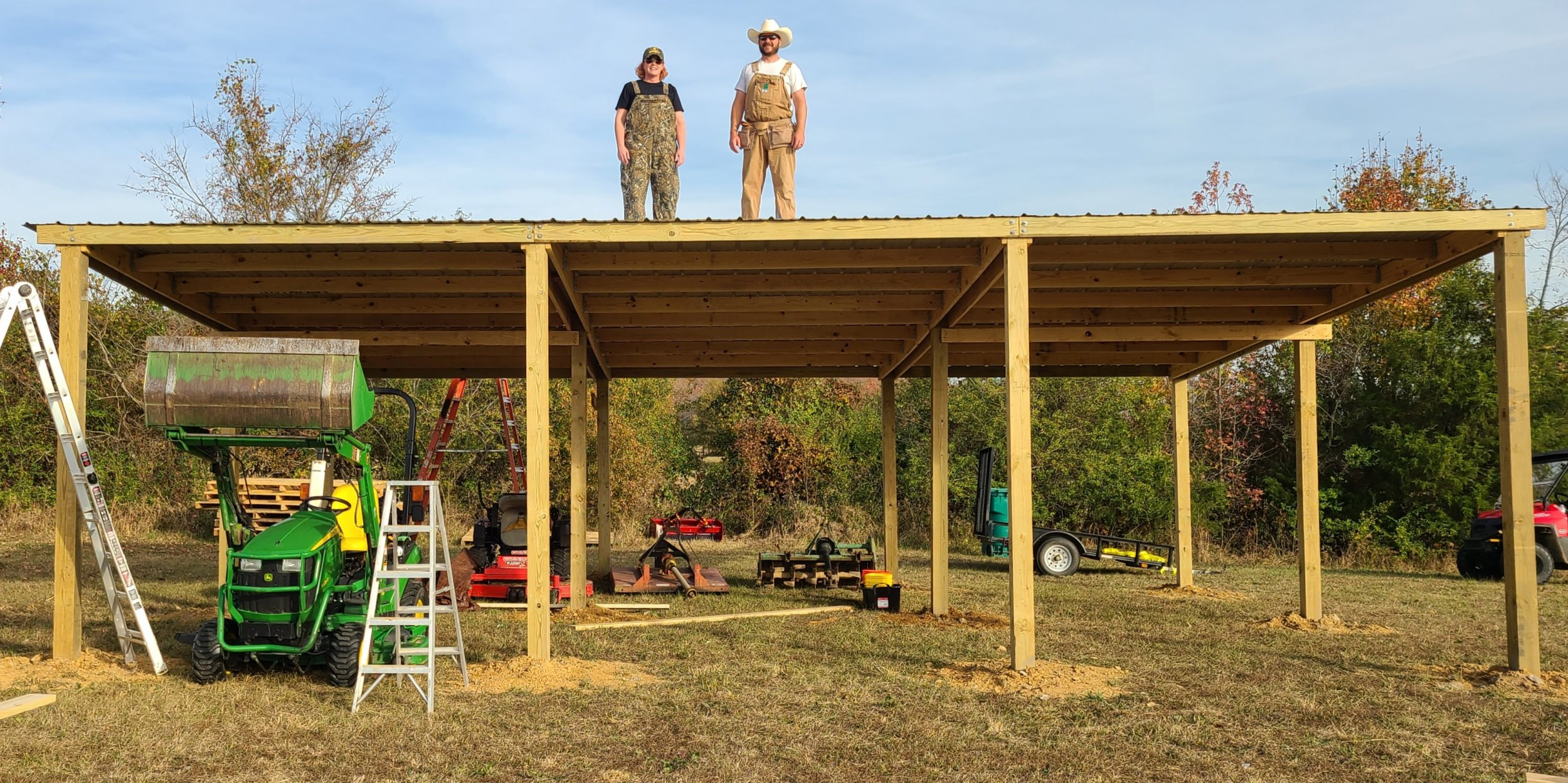

Posts in the middle or not. I opted for posts. That saved the expense of trusses and less square footage for roofing materials. My posts are set in a 12'x12' grid, with a 1/12 pitch front to back. I have added some bracing and graveled under it since this was taken. There was some controversy on my framing job on here, so some will probably advise better ways to frame the roof than what you see here. This works well enough for me.
But how do you support it in the middle with no poles??
