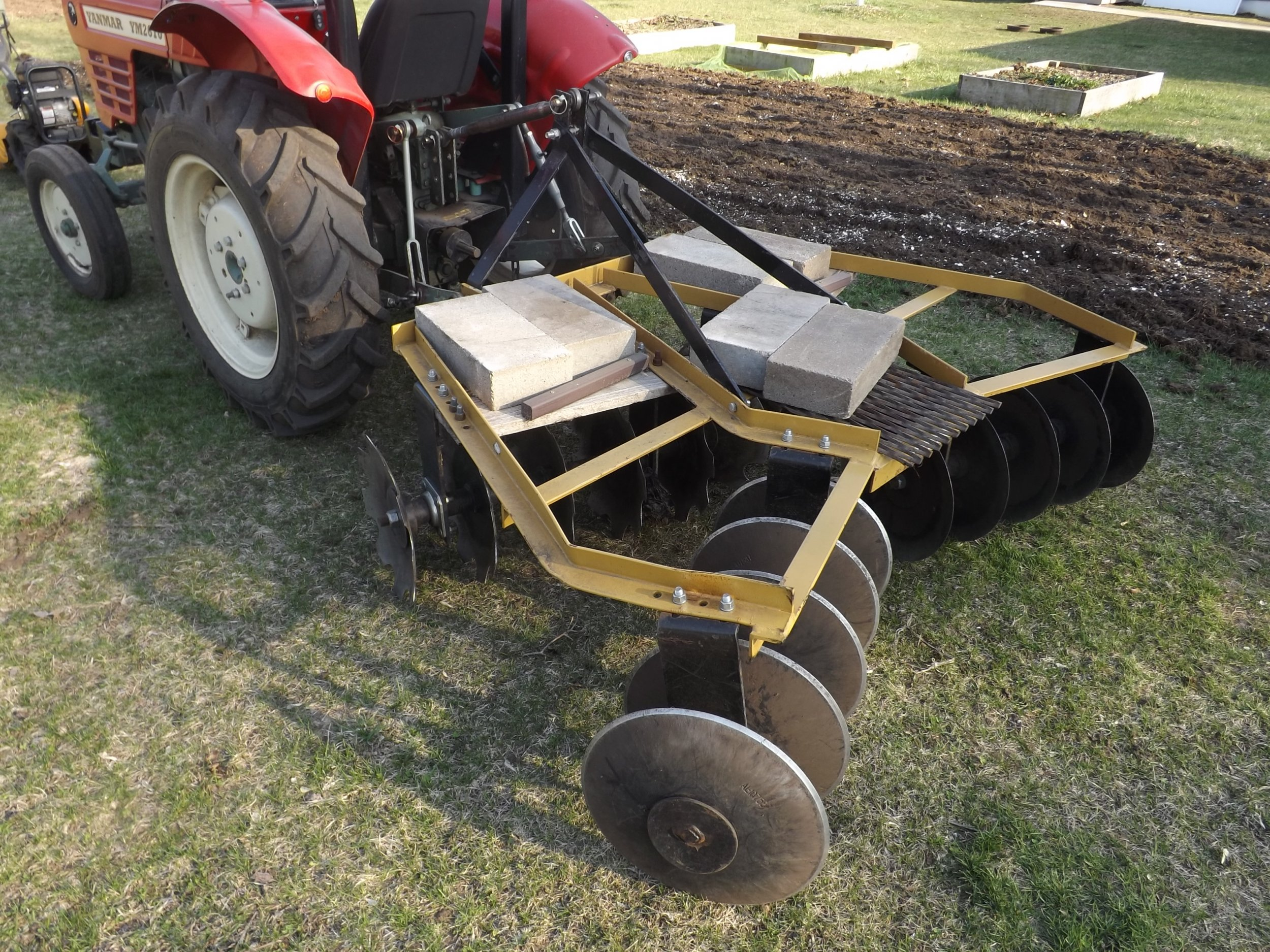

Your machine is in the same power range as mine. My Disc Harrow is a KingKutter 6FT double gang, double row.
Each cinder block is about 30-lbs. That makes 120-lbs of weight total. Going with more, it can get stuck in the fields. IF the soil is soft, then don't run with the weight in the far back. Instead, stack up front. Works better. Let the rear discs do their own work under their own pressure.

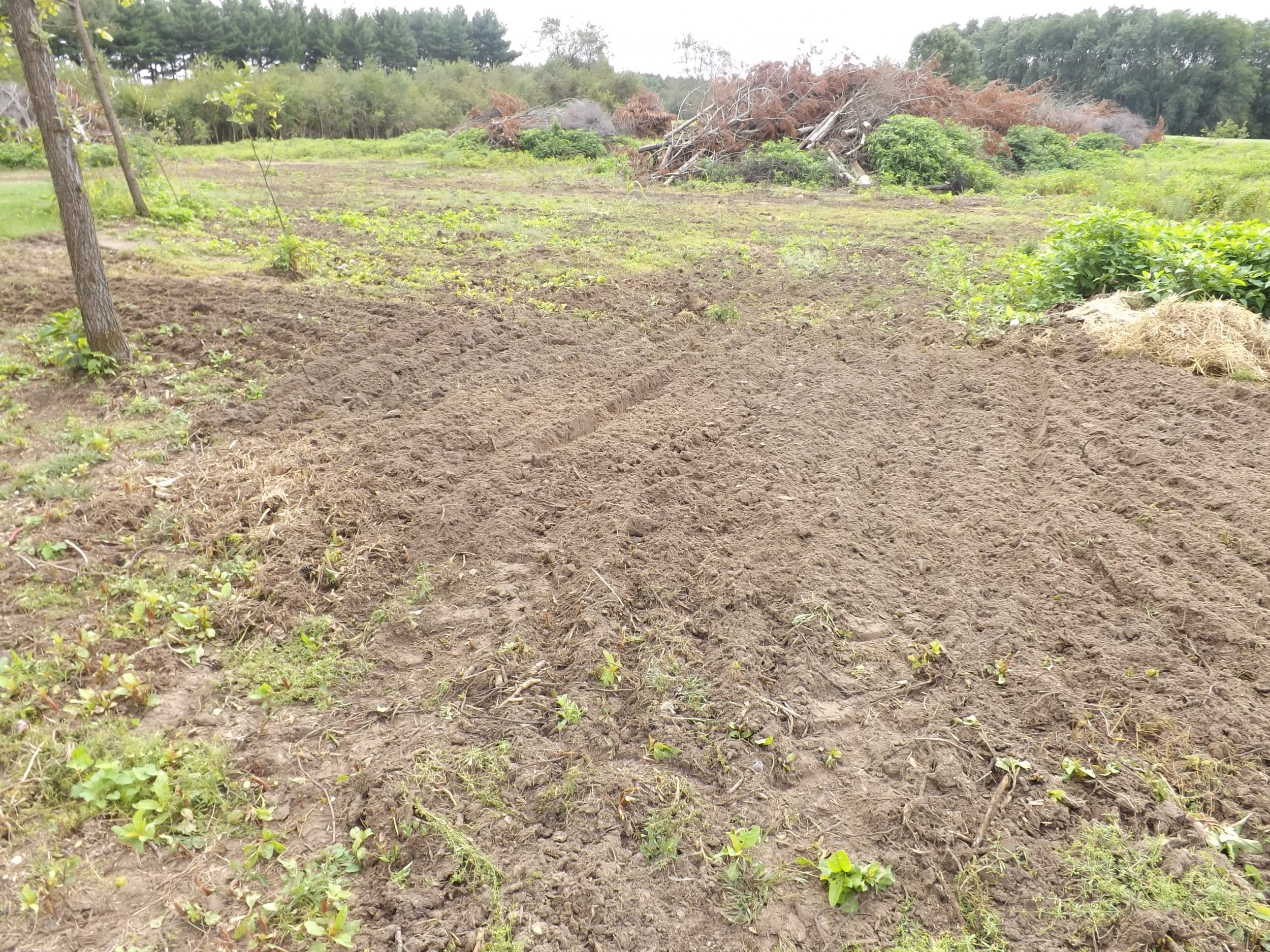

Nice field and pics. At one time this was a cultivated field but that was a very long time ago. Didn't think about the weight of a cow and hard ground but they haven't been in there for over 4 years maybe?

In my pix, there were about 3,000 pines all 6ft apart in dense rows. It was to be a Christmas tree farm, but it went bust. Owners just left it alone for 40 years. Loggers took out the trees, the disc harrow just grinds the old root systems like knife cutters.
One pass on un-touched soil will not show much work. It takes a few passes doing checkerboard style to get it like rototiller powder or PTO tiller powder. Even a criss-cross pattern would work should you have the room to turn around.

As my posted image shows, the King Kutter has notched up from and smooth in the rear.
For adjusting the gang angles depends on the compact tractor. The gray market tractors are mainly rice paddy machines with PTO tillers. Tossing a disc harrow onto them needs some sort of tuning for the angle. It's not hard. Takes just one adjustment and it's tuned for the the tractor. My King Kutter is fully adjustable for the attack angle. Love it! You can see the bolt patterns in my images above.
I've found that adding weight is far superior than the pan diameter increases. Adjusting weight loads help tremendously is various soils in all kinds of conditions. And running with no weights will give the garden or land that really fine and smooth till. This is how plant nurseries use a disc harrow. That smooth till pass allows them to place down the nursery garden black fabric rolls. If adding weight up front the first gang takes the hard work. The rear gang will smooth things out too. Having weight on the rear gang will get the disc harrow stuck and the tractor to stall. Having an increased pan would drive a disc harrow into the ground and can get stuck there. Weights really allow for adjustments on the fly. Been doing this for nearly 3 decades.
