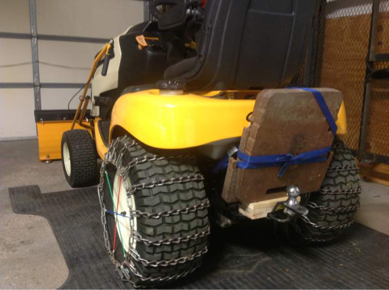

I have a 2011 GT2100 and it can push an impressive amount of snow but a necessary component to do so is definitely weight. I have my rear tires filled with washer fluid and I put 2 100lb AG tractor weights and my 210lb ***** & I can BACK up my very steep driveway with the plow lifted an never slip a tire, I also have a good set of 2 link chains. ( see attached photo) See the video link below for my set up in action.
http://youtu.be/VqlUVg23I9g

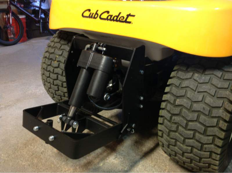

As far as a rear blade working, I just installed a Johnny Products Universal Sleeve Hitch yesterday and I have a box blade and cultivator that I am anxious to try. I tested the cultivator last night and it ripped through hard dry ground quite well, have not tried the Brinly box blade yet but I am confident it will work great also, again, weight & chains will be employed.
These garden tractors are capable of taking on big jobs, just smaller pieces at a time.
John
