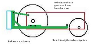

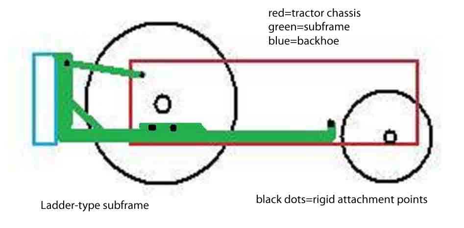

There are two major types of subframe used to mount backhoes to tractors:
The first I will call a ladder frame because it usually has two long beams
that go underneath the tractor (first drawing), connecting at the rear axles
or differential housing, and somewhere forward of the tractor's center. Some
form of toplink is usually required, too. My crude drawing is a side-view
schematic. Sometimes there are "rungs" on this type of subframe for more
structural stability.

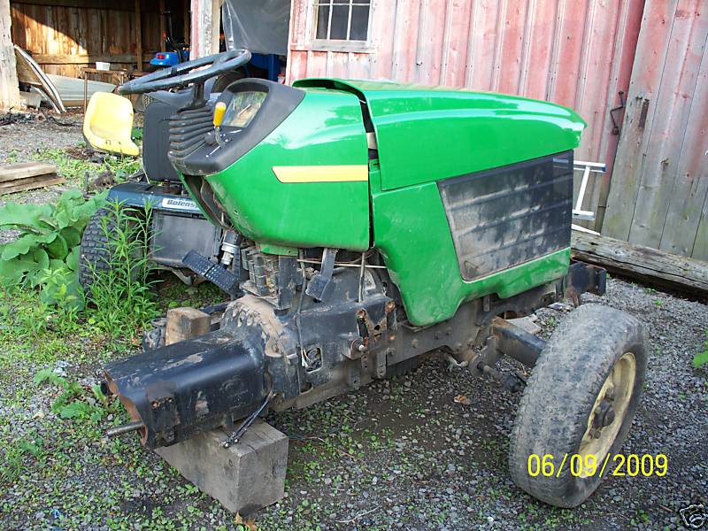

   / how to build your own custom backhoe subframe
There are some rather odd subframes that don't fit either of these
categories. I have seen subframes from Deere for both the 955
and the 4300/4310 that are little more than small brackets that bolt
to the sides of the rear axle housings (photo). This approach has not
worked well, however, as JD later required users of their hoes to buy a
separate reinforcement subframe to add to that. I have posted a page
from JD's Subframe Installation Manual, which is dated 2005. That could
mean that this reinforcement was developed in response to failures
in the field. Like the one in the below photo. Here is a TBN thread
I posted about one of these broken JDs:
http://www.tractorbynet.com/forums/john-deere-owning-operating/146426-jd-4300-broken-half.html
