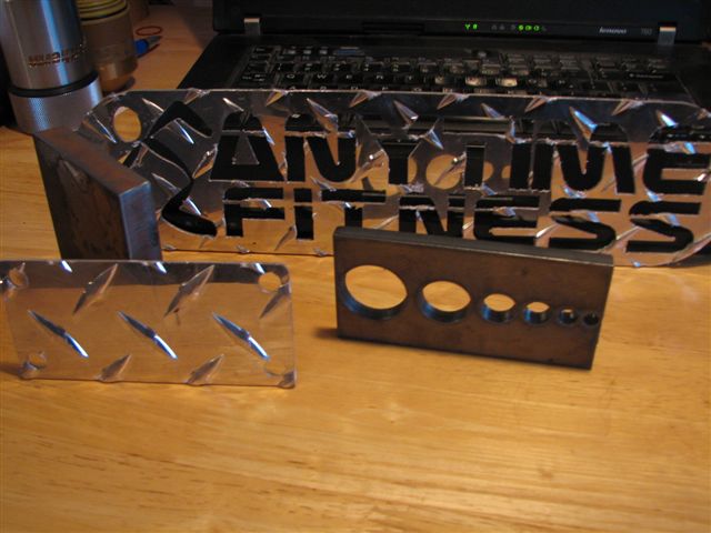

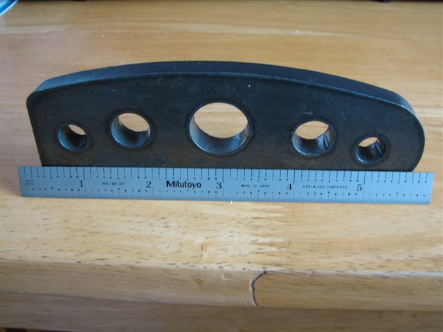

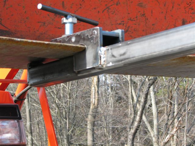

I do a few odd jobs with my home shop machine, it is a PlasmaCam cnc with a Hypertherm Powermax45 plasma......does an excellent job on materials up to 1/2". Here are a few pics of projects done with this....and if the parts are small usps shipping from NH to WV will be $10 or less. If you send a drawing or sketch with dimensions...I will quote the parts...be sure to indicate material and thickness. I will have to redraw in AutoCad (.dxf) format, but I don't charge anything for that. If you are interested PM me your email, and I will contact you.
