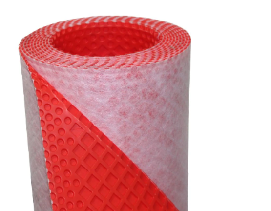

I am filling in a little area in my mom's backyard to build her a shed. To accomplish this I had to create a 2 high railroad tie retaining wall to hold back the dirt on the low end. What have y'all found help the longevity of railroad ties? I am not looking to spend a bunch of time on this, but if there is something easy to do to help them last longer I am all ears. I was thinking putting some plastic between the ties and dirt. Maybe slathering some used oil on the ties before backfilling. Whatcha got?

for the parts below grade, if really concerned you could go foundation waterproofing membrane (or shower tile under layment) on the sides and gravel on the base will give you great lifetime drainage. Cheap and easy.
