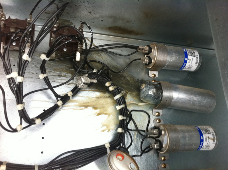

Like others say lay a screw driver on it. There are capacitors made in America that I suggest over china maypops. They are Titan HD capacitors. China capacitors are garbage.
Attached a photo of a nice capacitor blowout for your entertainment.
