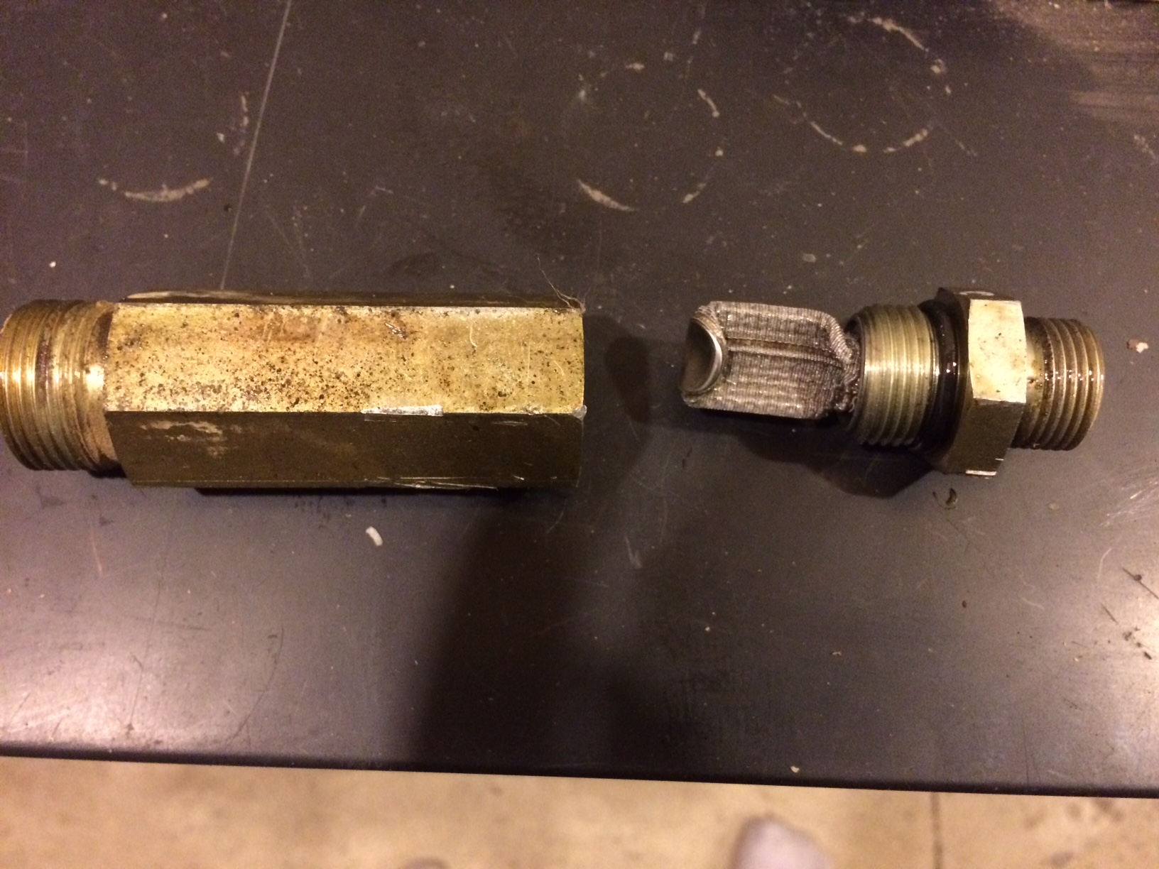

I change only the canister filter in my 3720. The inline filter is removed, cleaned and put back in place. I bought the inline filter for the first change but did not use it since it looked as good as the new one after a good cleaning. The inline filter should be replaced if damaged.
I believe this is in accordance with the service instructions.

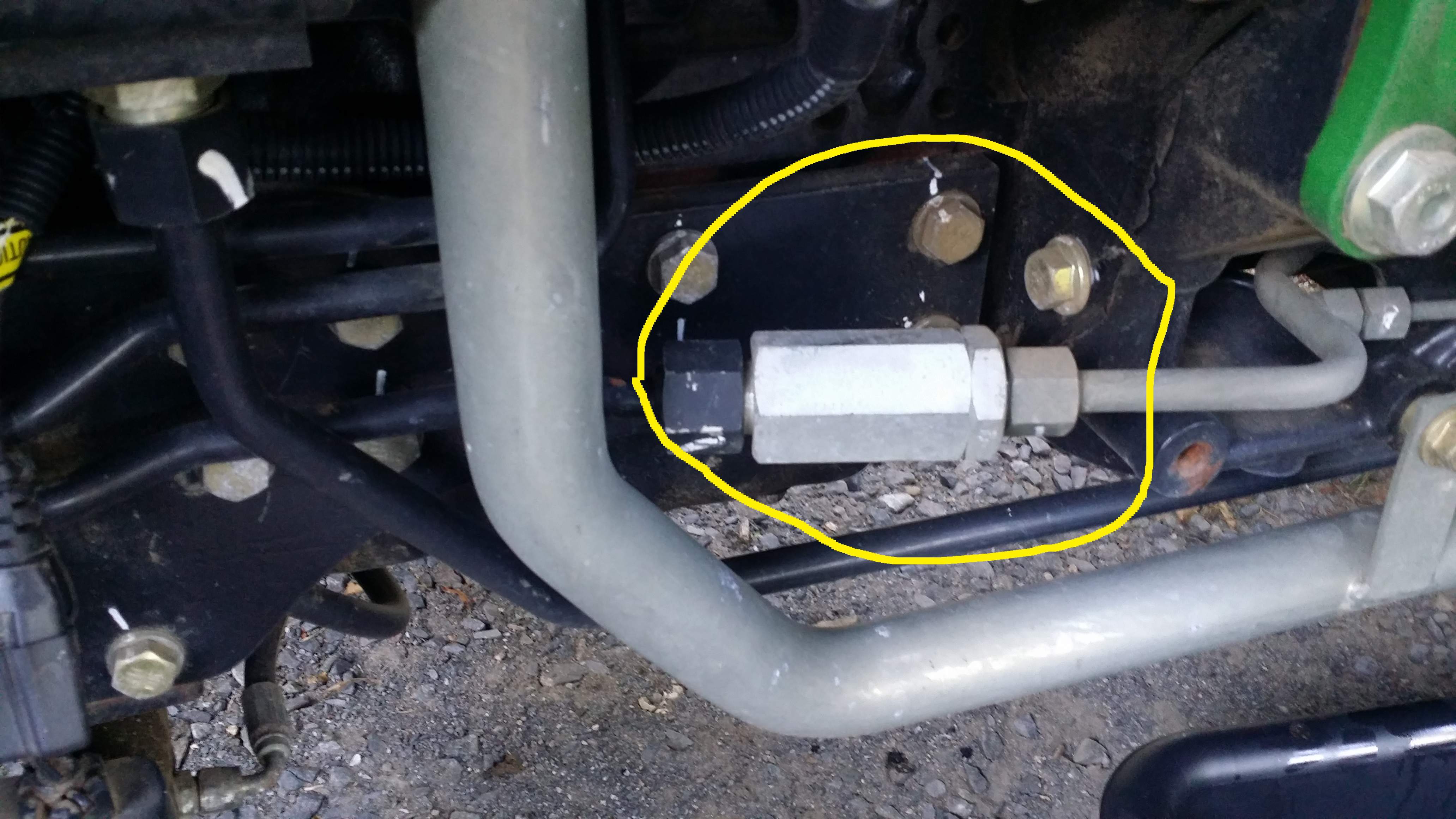

How is the filter removed from the line? Is the dark nut to the right of G supposed to be loosened? Also, once the filter is apart, do you replace the o-rings or just reuse them for assembly?
I"m a newbie when it comes to tractor maintenance, and will be doing my first 50 hour service on it.
According to the manual the way to clean or replace this filter is:
a. Position drain pan under (G)
b. Remove filter from lines
c. Remove nut (H) with internal element from case.
d. Clean case and internal element with a mild solvent
Allow to dry
e. Assemble and install hydraulic filter assembly
