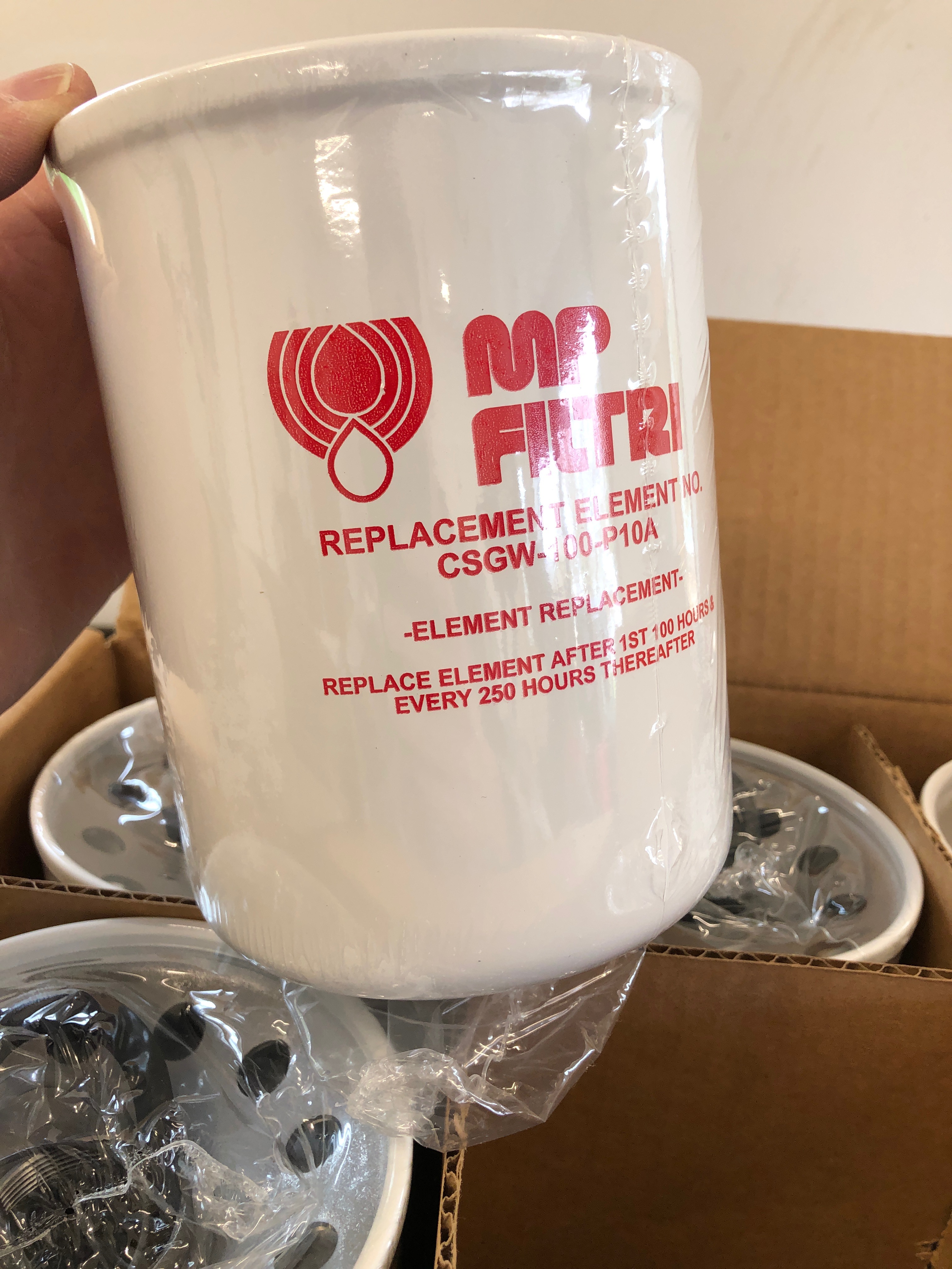

I bought 6 hydraulic filters when I was down at Tazewell and noticed how they didn't have the neat little power trac logo anymore. These filters tell you the manufacturer, part number, etc. I priced these filters on the web and it looks like they go for 30 to 40 dollars. I'm going to continue buying them from PT, just so it gives them a little bit of business. I appreciate the fact that it's a small American company of about 30 employess, probably not making allot of money but enough to make a living and have a sense of pride (the healthy type) in there workmanship.

This filter appears to have a different replacement cycle than recommended by PT.
Replacing the filter every 50 hours is crazy (even though I do it). If there's enough contamination entering the hydraulic system every 50 hours to fill up the filter and reduce flow, there's something fundamentally wrong with the design. A cycle of 250 hours is much more reasonable.
This is only a 10 micron filter anyway. However, the particles that do the most damage are less than 10 microns (because they can easily fit between bearing and other precision surfaces and act as an abrasive under high pressure). However, to avoid cavitation, a 3 micron filter would have to be HUGE. So, we're stuck with 10 microns as a tradeoff. This compromise is common on most hydraulic machines.

The maintainance manual for a Steiner 430 Max that I had said for the the same type of oil change that is recommended on this filter. Like you, I still do what PT recommends with the 50 hr oil change.

Don't forget to add magnets to take out the extremely fine particles that may slip through the filter. The reason the brand named filters have a longer service interval might be because they were intended for a return filter where the oil gets pushed through. As you know on the PT they are on the suction side which is sensitive to any restrictions and would need to be changed out at the reduced interval. That would be a good reason for PT to paint over the filter with their own label so as to not cause confusion with the manufacturers labeled service interval.
