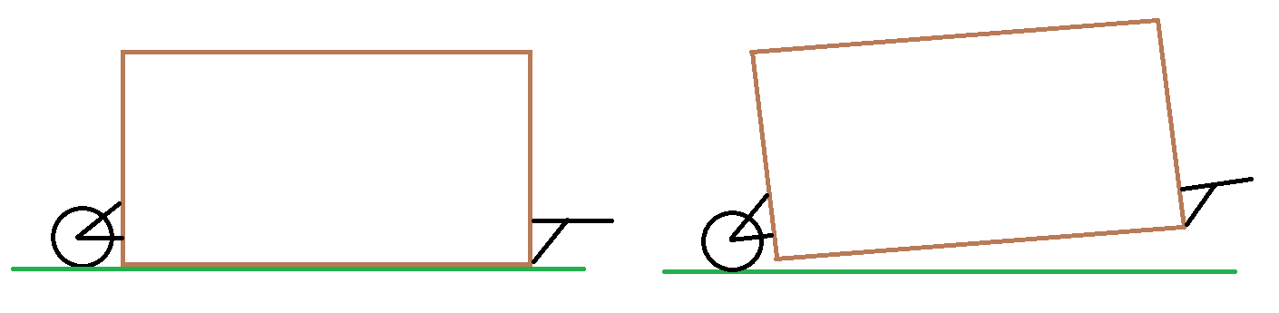

It’s going to be a rear swing arm design with trailer wheels. Right now I’m really digging this linear actuator idea to press down on the rear swing arm and raise the rear of the coop. Keeps it simple and 12V electric gives the option for a 12V LED lights on the inside.
Didn’t know linear actuators existed until today thanks to you guys. Specs say under no load it moves 0.66/sec and under max load it moves 0.56/sec which should raise it relatively even rate.

This is what I’m going for if you can envision it. Will have a bar going between the swingarms that two linear actuators will push down on, one on each side.

I realize this takes a little manual labor but it is the simplest design for what you have.
weld a peg on axle
a pull pin in white holes or make a quick latch . then your pry bar to raise the rear would only take about 5 seconds .
your peg location could change to make it easy to lift .
