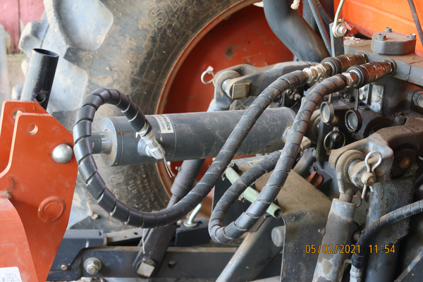

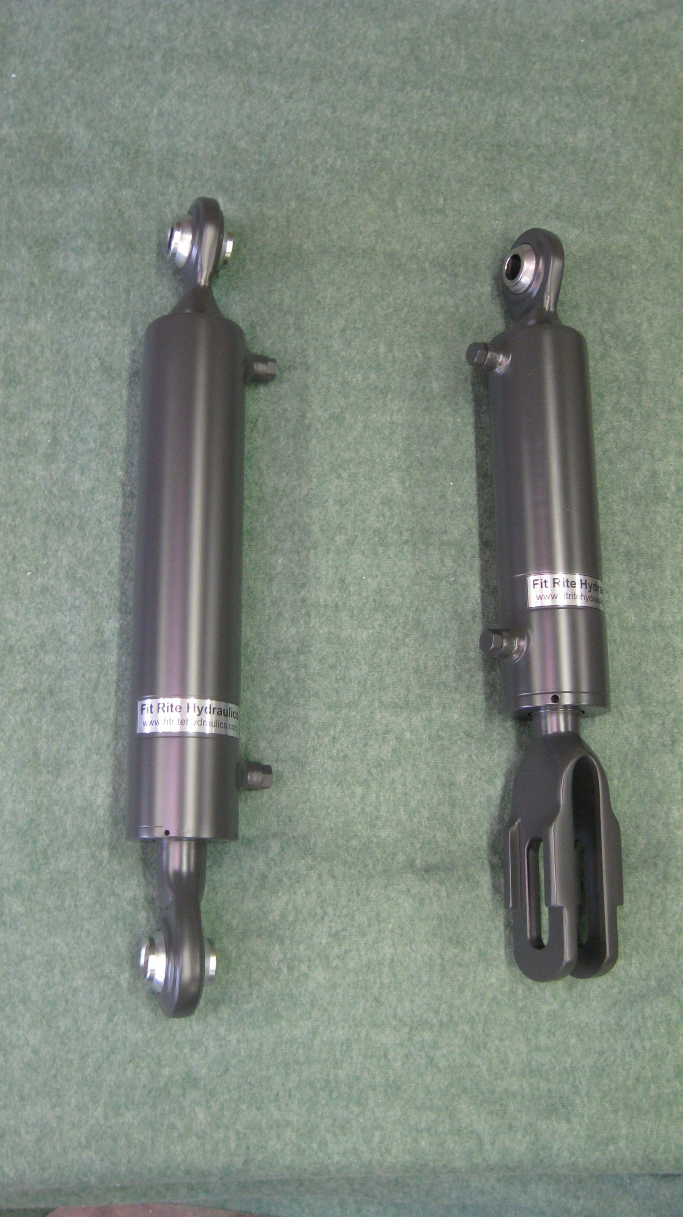

This is what I typically supply for your application.
A 3" dia cylinder with a 1 1/2" dia rod having a working length of 23 1/4"- 35 1/4" similar to the unit on the left in the picture.
A hose kit made with 3/8" hose and 1/2" male AG poppet type couplers, 1@30", 1@36".
A set of flow restrictors, these allow for slower smoother adjustments of the hydraulic link.

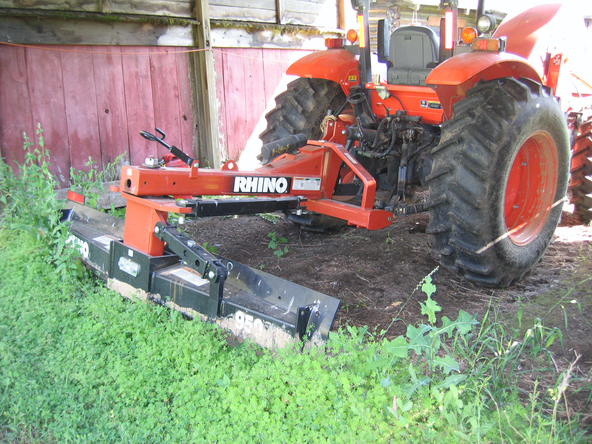

I've had a hydraulic top link on my M6040 for eight years. It's from Fit Rite. It was a real "no brainer" to instal. Much heavier than the OEM manual top link.
No problems what-so-ever and seals are still 100%. Meaning there is no leak down if the 3-point implement is elevated by the hydraulic top link.
The Rhino 950 rear blade weighs 1050# and is VERY easily controlled with the Fit Rite top link.
