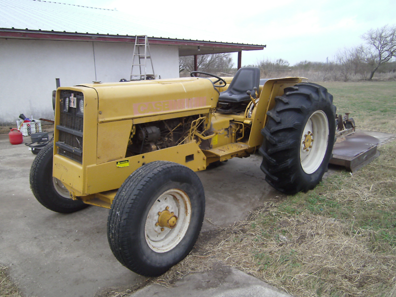

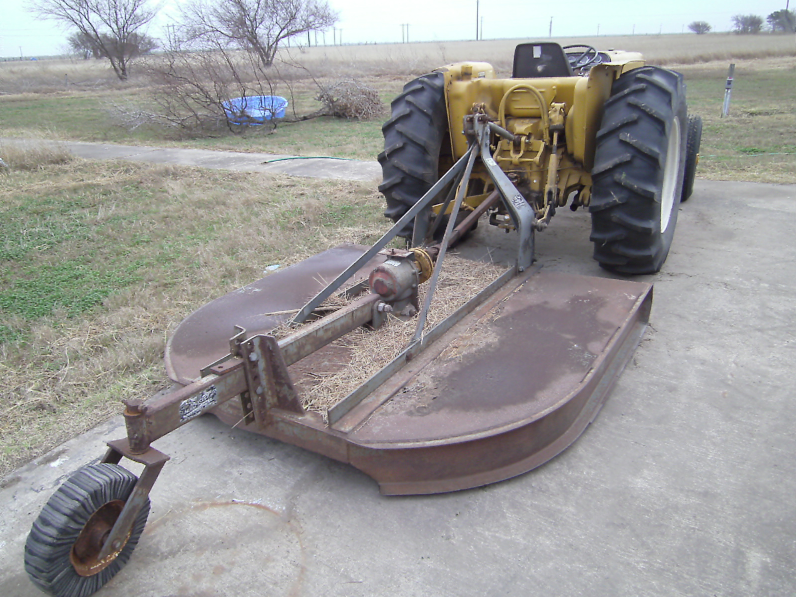

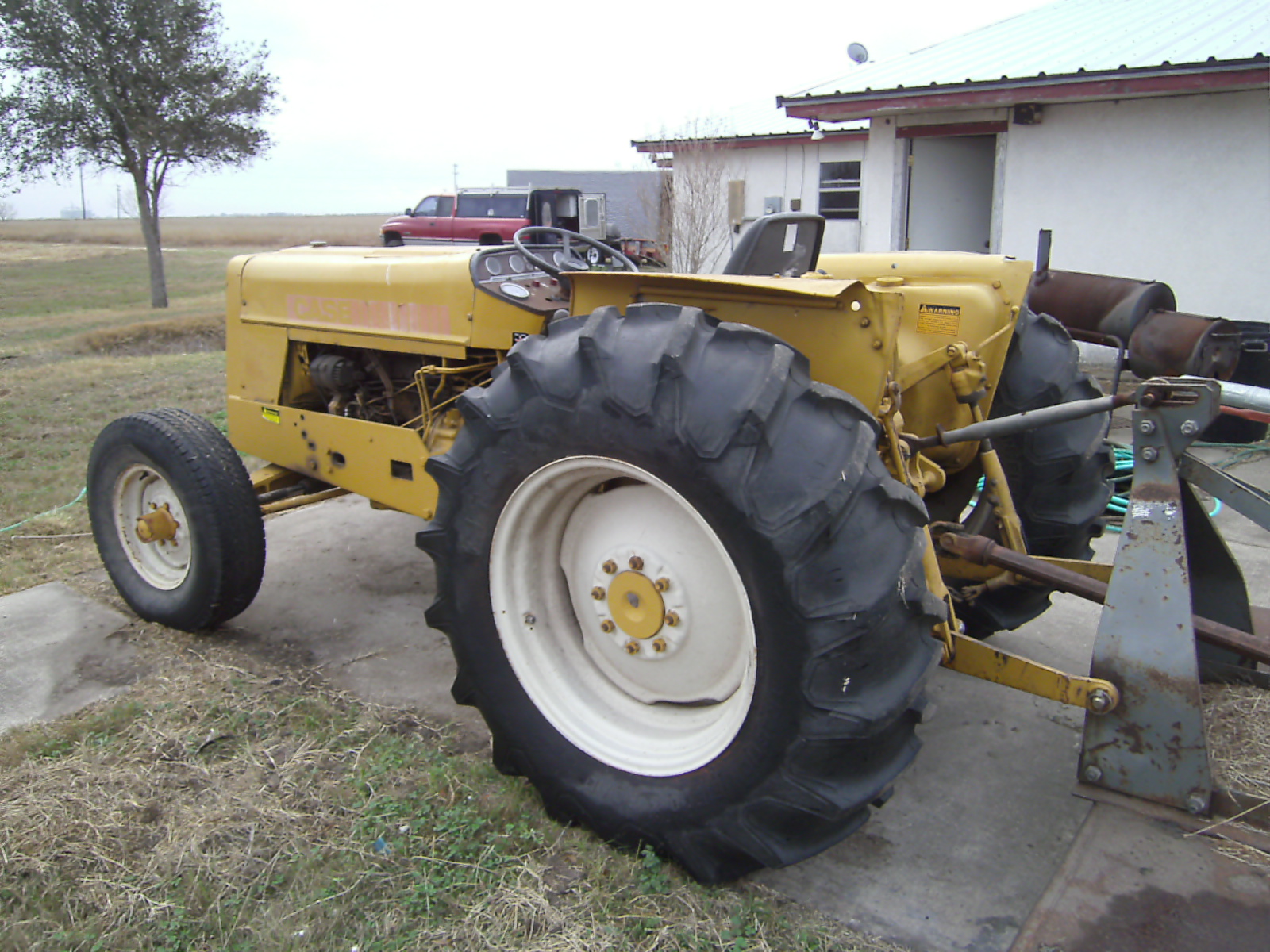

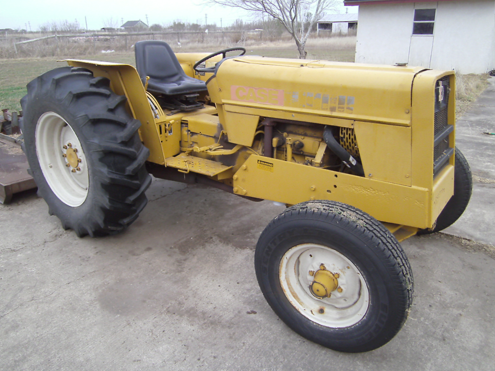

Okay, how's this? Look familiar?
   / I can use a bit of advice #9
There ya' go...!! As near as I can figure, just looking at pictures, it appears to be a 240A Industrial version. The front axle gave it away... If you look on the ID tag, I'm guessing it may possibly say "Made in England."
Here is a link to Tractor Data: TractorData.com International Harvester 240A industrial tractor information
Click on the picture to enlarge. The grill looks the same, and does have the side frame like yours.

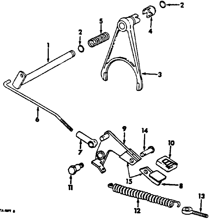

I've also attached an exploded view of the diff. lock on a 454. I checked several other models, and they all appear to be the same, although I didn't check the part numbers.
All it shows iis the pedal, linkage and yoke. What it activates, or where it goes I did a quick look, but did not find. Just assuming it is on the bull pinion shaft, along with the brake housing.
There is a fellow on here that goes by the username of "Art", and is pretty up on the IH stuff. Bet he could tell you more about it, and what parts would interchange, if ever needed.
Oh..., and as for the other original question..., about sharpening the blades. I use my 4" angle grinder on mine. I block it up securely, letting it set down on the blocks. ( chunks of RR ties) Tractor in gear, brakes set, and block the wheels... Rotate the blade to where I can reach it, from the outside, towards the open front, and grind away. The initial grinding may take a while, if the cutting edge looks like, as we here describe as, "looking like a butter knife handle". It doesn't take much to dress it up, if you do it every time you mow, or every other time. Depends on how many acres you mow, and what may have been hit.
I like mine pretty sharp, but I'm just cutting heavy grass, and is my backup, in case the haybine goes down. My older Bush-Hog brand cutter has a detachable side, that allows you to mow hay.
If your mowing where there a small saplings/water sprouts coming up, you may want a little blunter edge to shatter the stubs, so as not to puncture a tire when you mow again.
