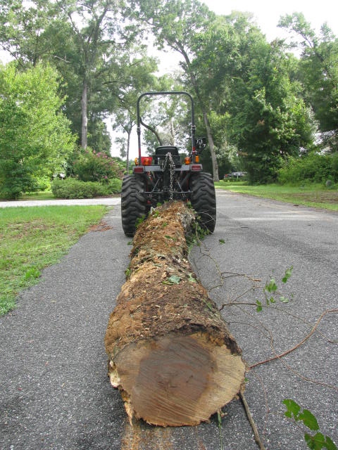

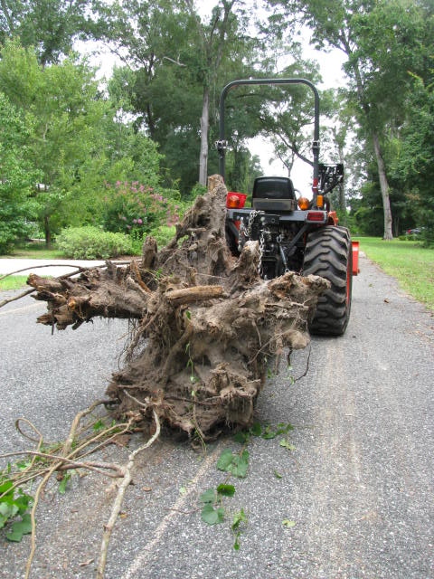

Question to the OP remains open: Did you have the butts of the logs, closest to the tractor, ELEVATED? If the butts are elevated ground friction will be considerably reduced.
If you were plowing with the logs any kind of tire is going to spin.
Also, if you are plowing and the log butt or a branch stub encounters an immovable object like a rock, you tractor will rear up on its back wheels in 1/2 a second. It you are going up any kind of a slope the tractor will go over backwards in 1/2 second.
When I was new to tractors I went vertical in a John Deere 750 skidding one medium size log plow fashion on level ground, when the butt caught a ridge. It I had not been wearing the seat belt I am pretty sure the tractor would have gone over, not sure in which direction. Every pore opened and I dumped a pint of sweat.
O N C E....B U T - N E V E R - A G A I N !

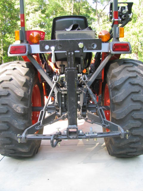

FURTHER ON LOG SKIDDING:
'http://www.tractorbynet.com/forums/attachments/244218-omni-manufacturing-omni-grabhook-hanging.html
