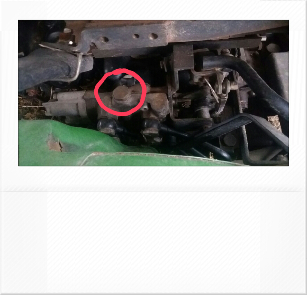

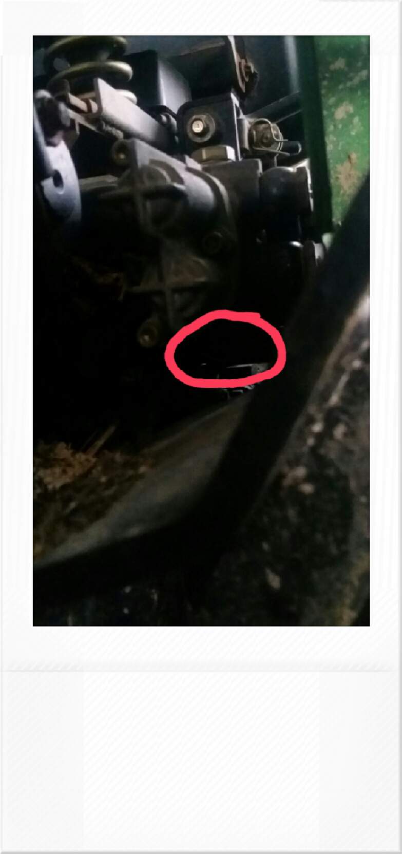

Ok, with that being said I'm assuming I'm going to use the ports in these pictures? image_02.pngimage_03.jpg

First time posting pictures, I hope that worked...can any one tell me which one will be the pressure side of that valve and which is the return?

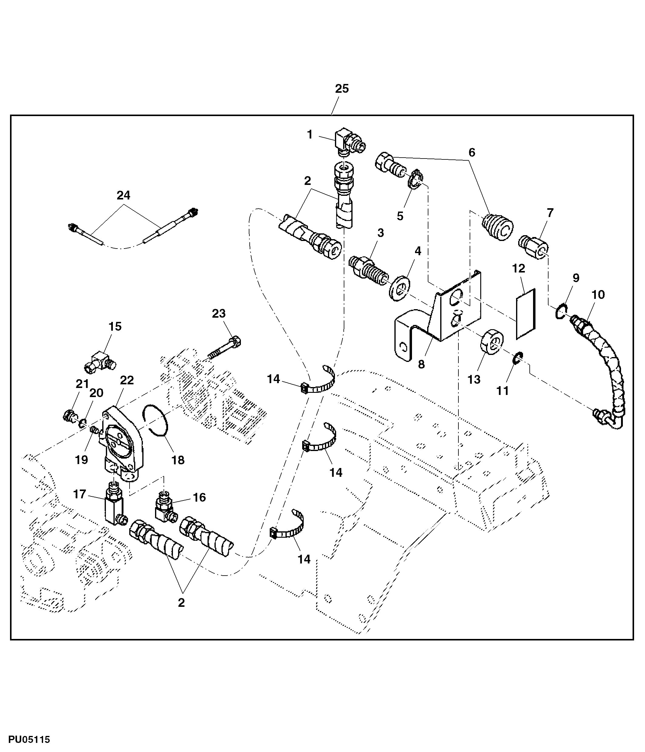

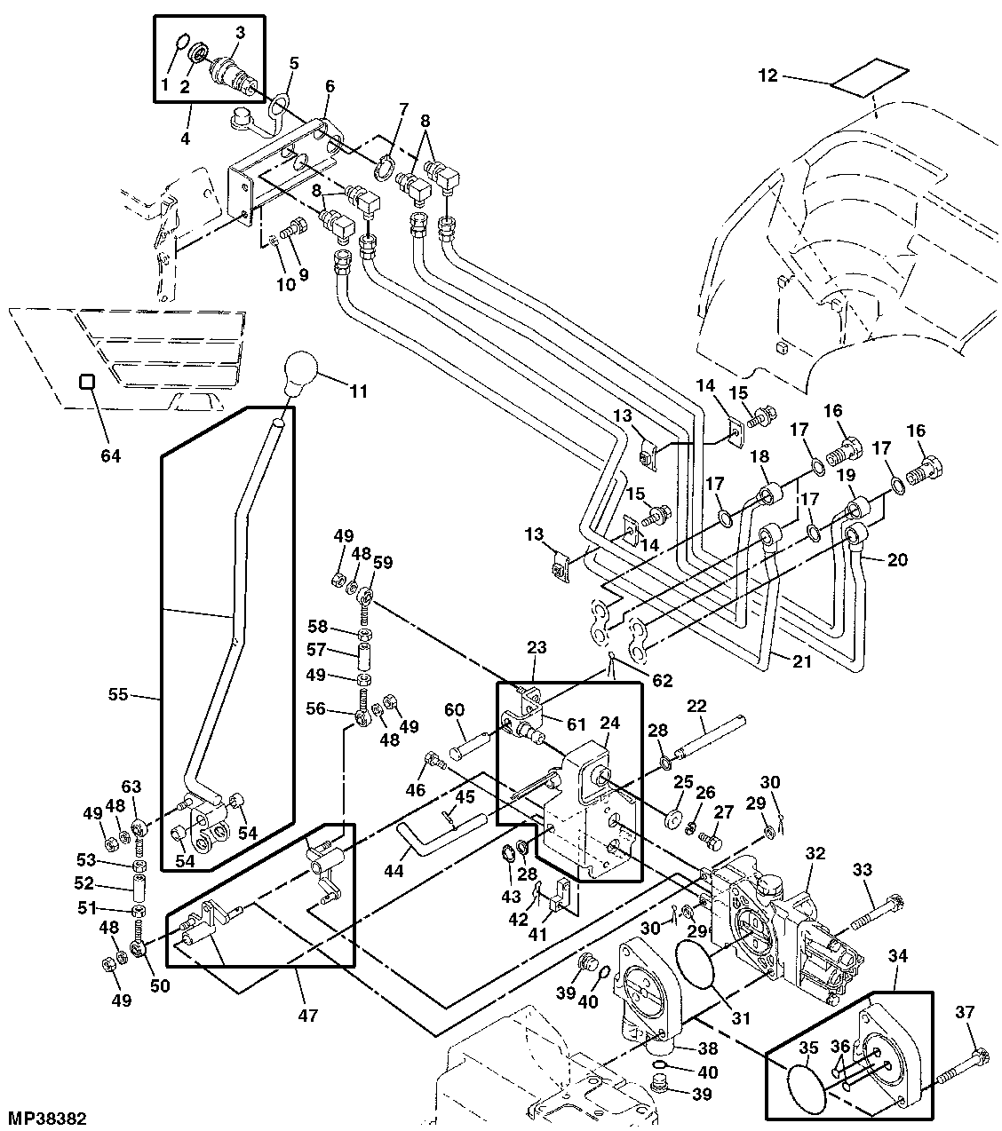

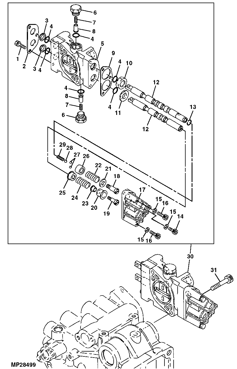

You need have the aux hydraulic BLOCK between your valve and the rockshaft housing like the 4100 uses for rear remotes. JD doesn't list that block part for a 4010 but they both use the same part number for the valve so I don't know why it wouldn't work except for clearance issue with the fender maybe
Picture#1 is 4010 valve/ Picture #2 4100 valve and shows block (#38) /Picture#3 is aux block plumbing for rear hydraulics /pic#4 is the 4010 valve breakdown
