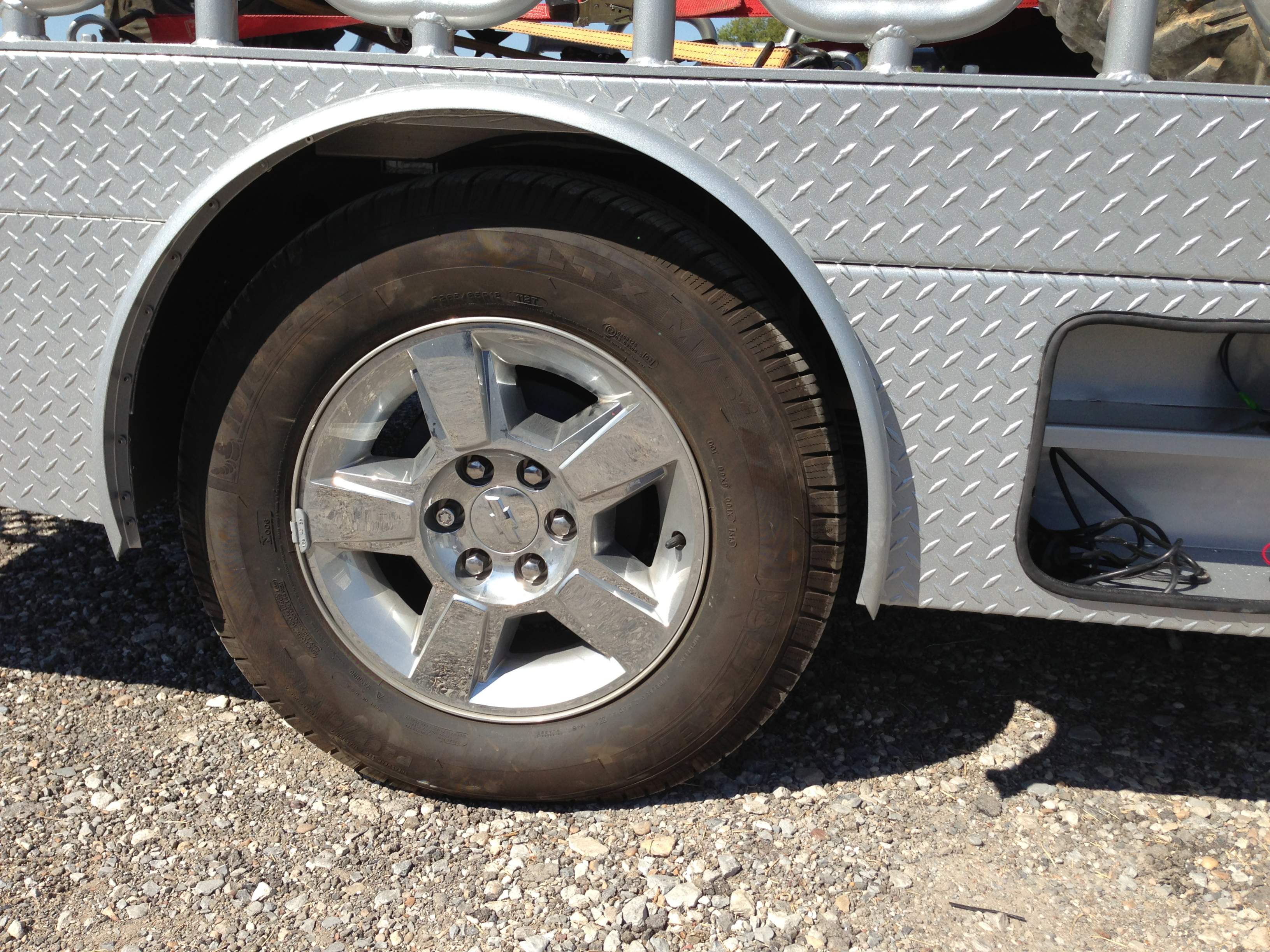

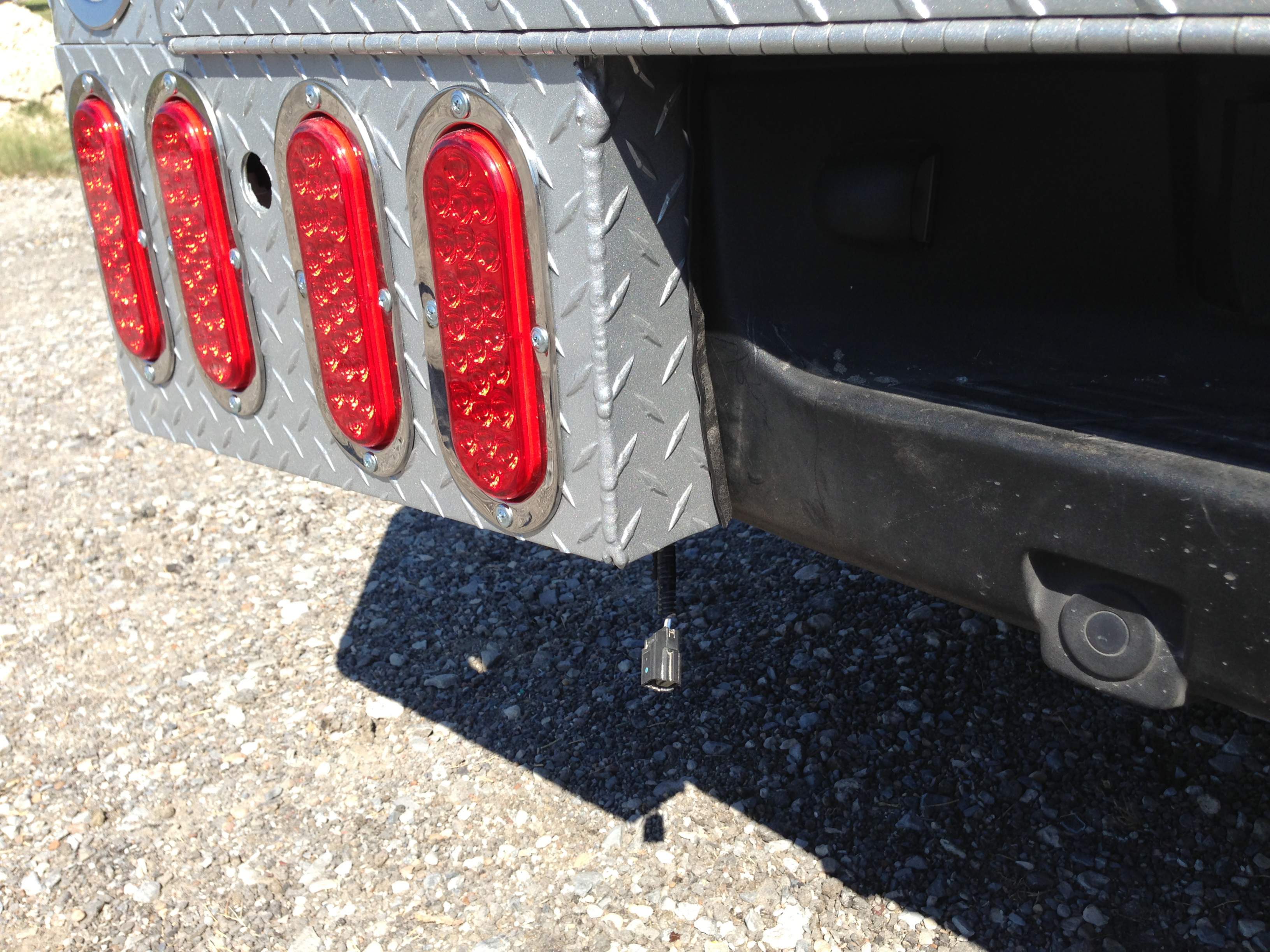

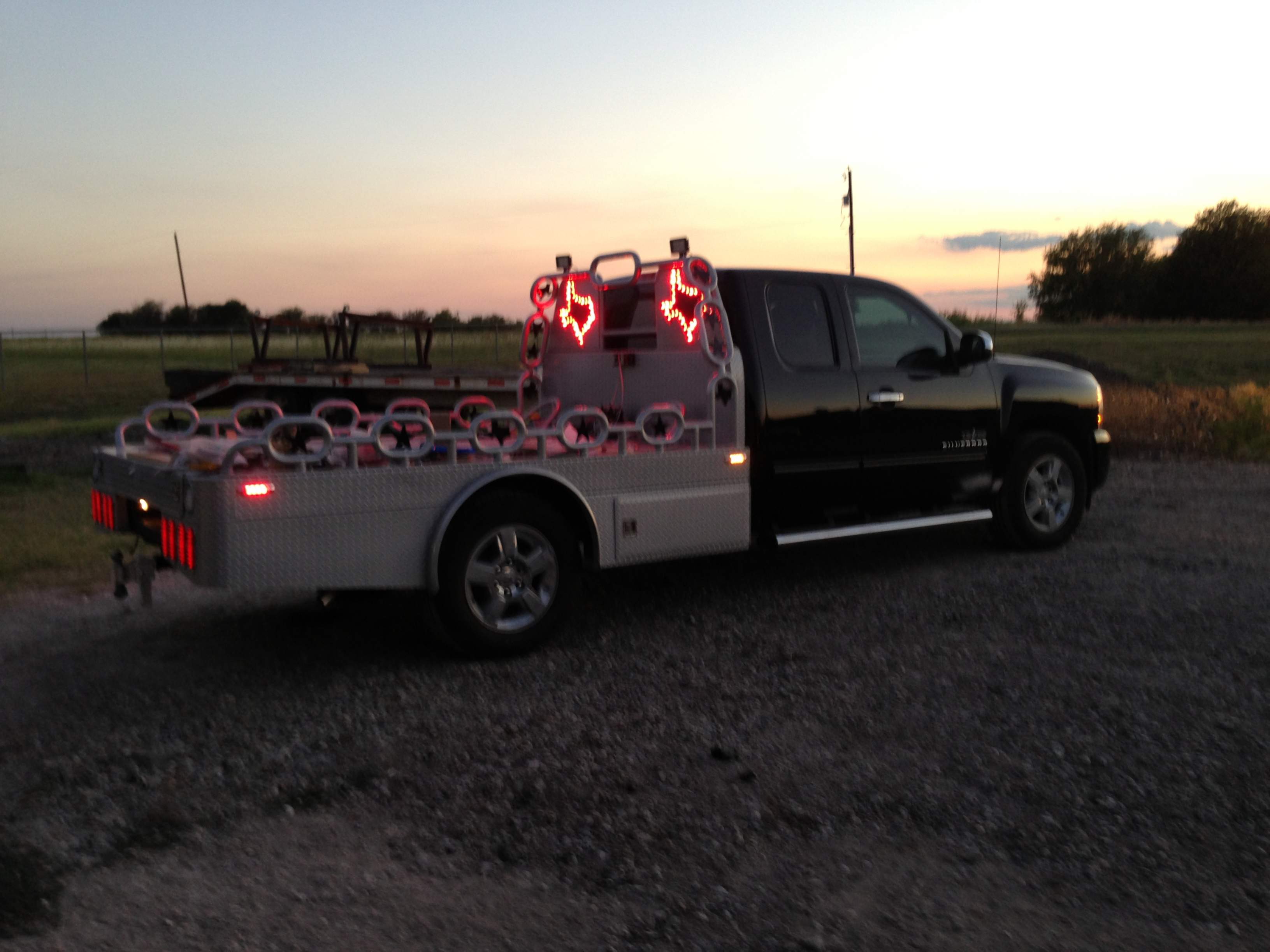

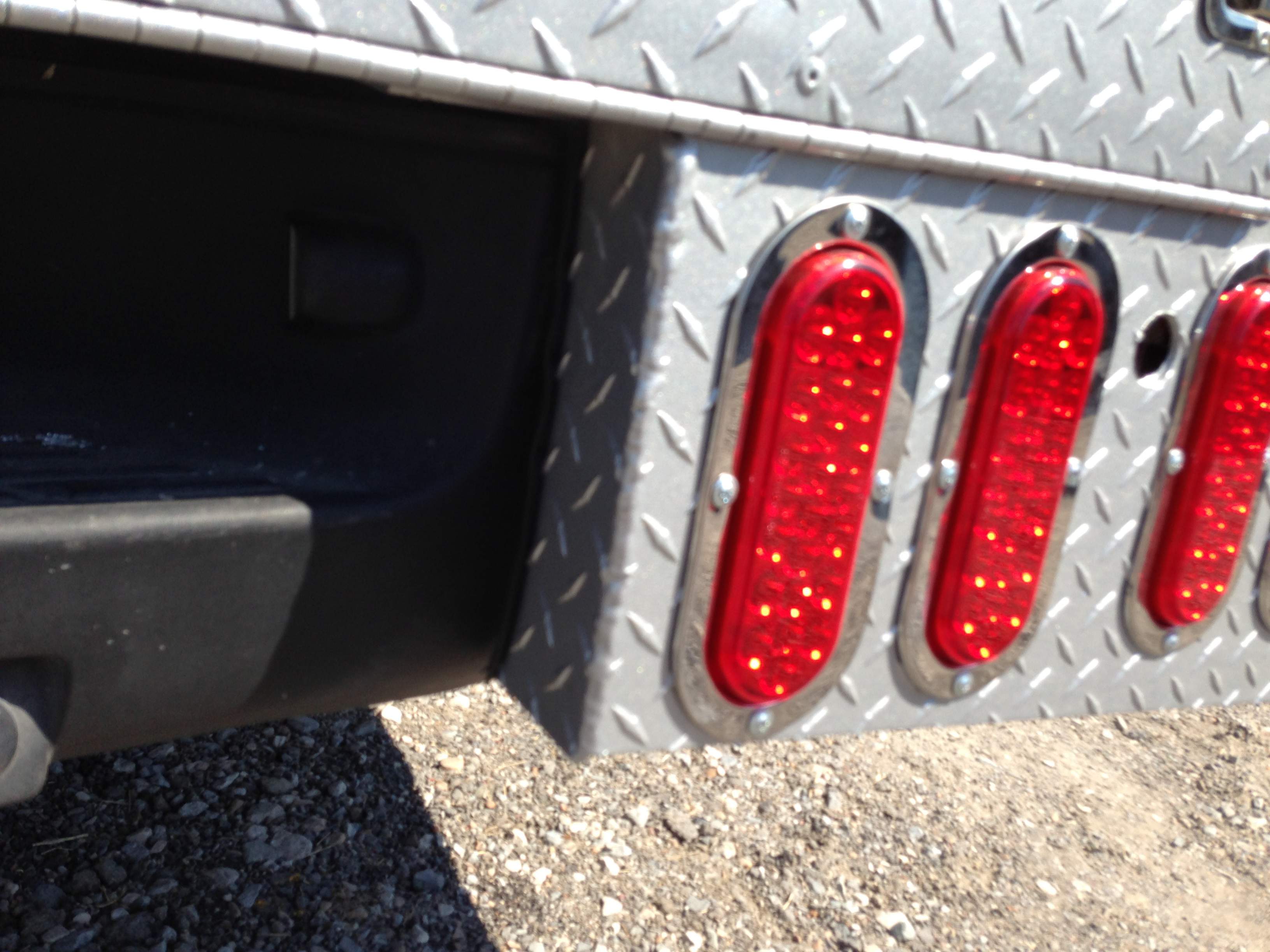

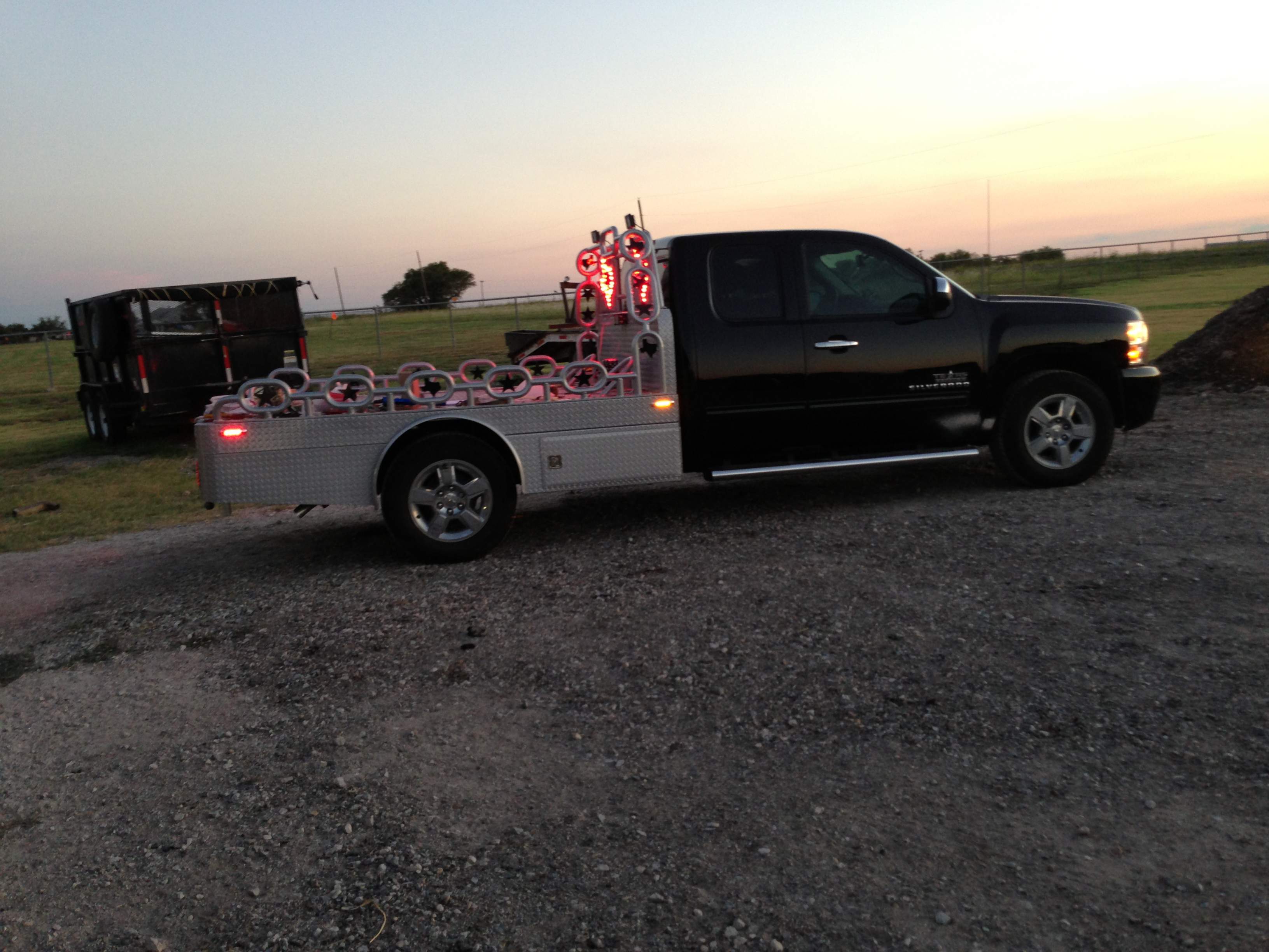

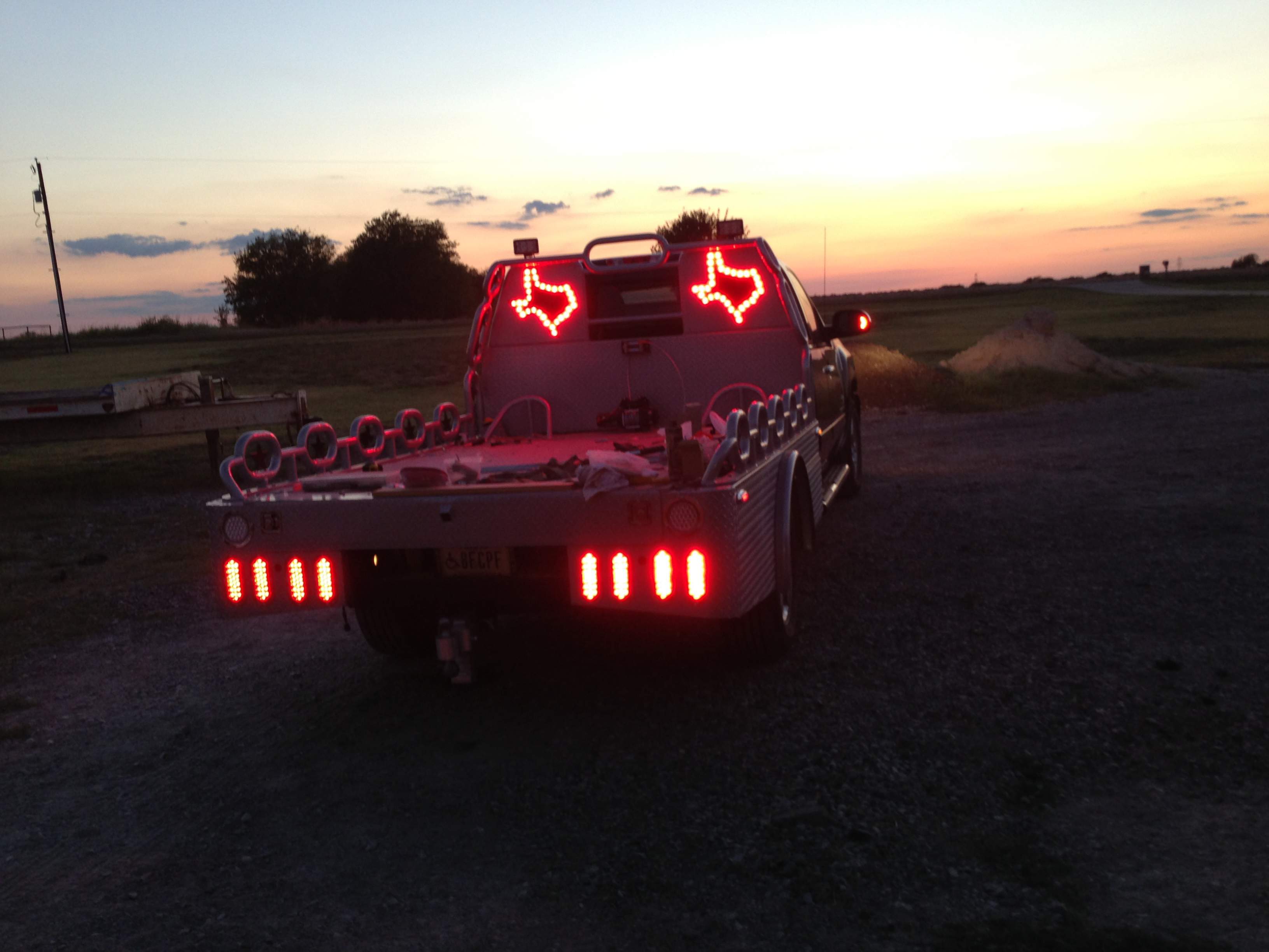

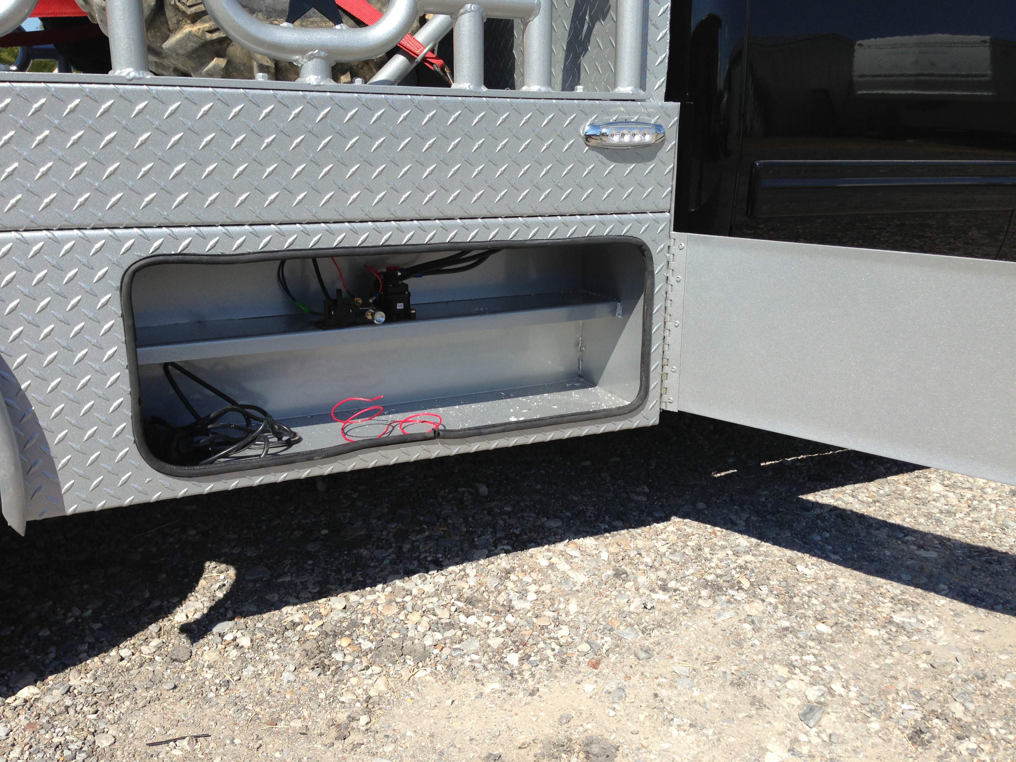

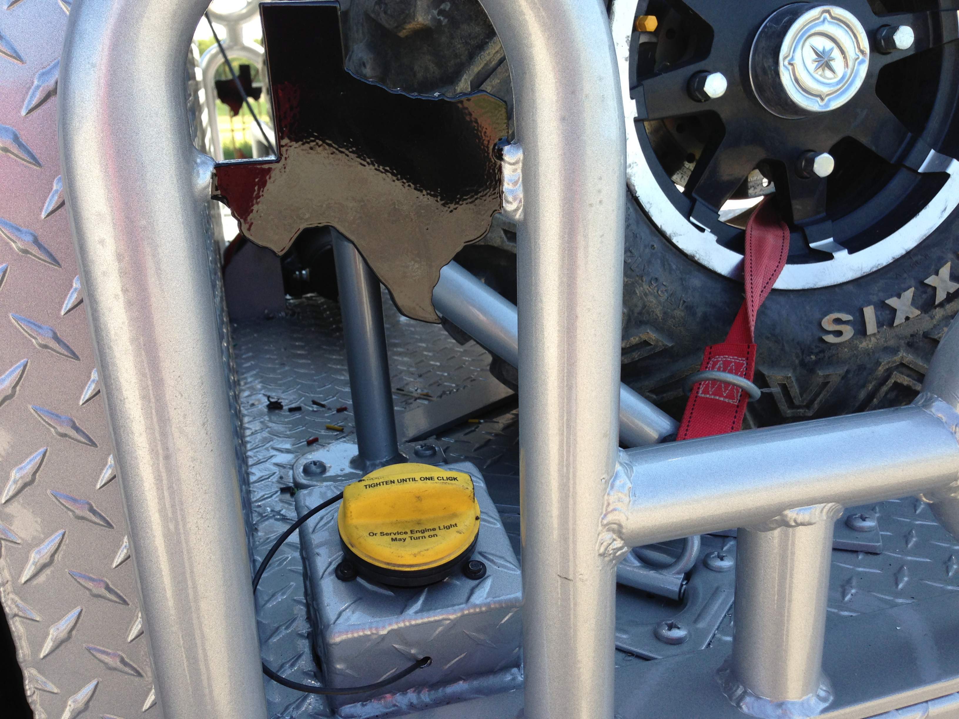

Good news, it is done and doing well in Parker Az last I heard.
Originally the pickup was set up with diodes for using the pickup lights from the Peterbilt through the RV. Sometimes the diodes went out and it was an issue. So the last thing I did was install three way toggle switches in a less than obvious place in the bed. When the toggle switches are in the up position the lights are powered by the pickup, down position, Peterbilt. It's also a nice anti-theft device in that if you take off with the truck and the switches are down you will have no tail lights.

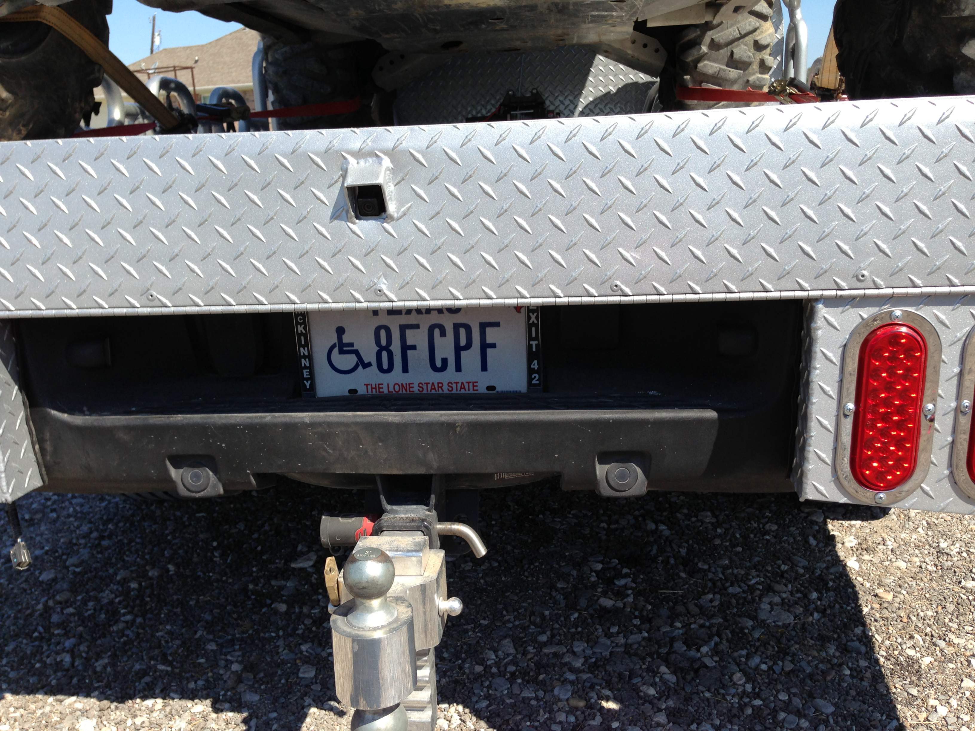

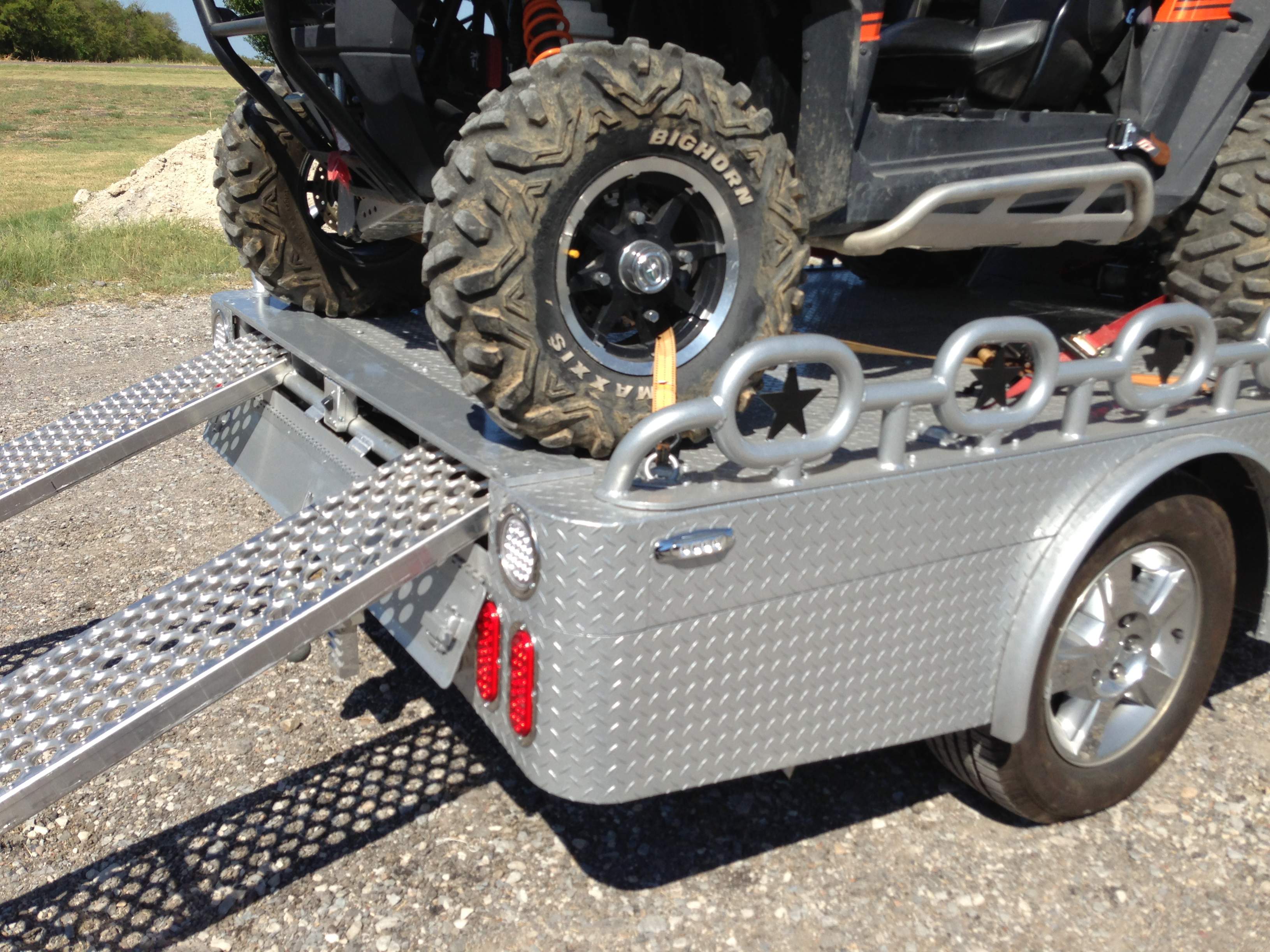

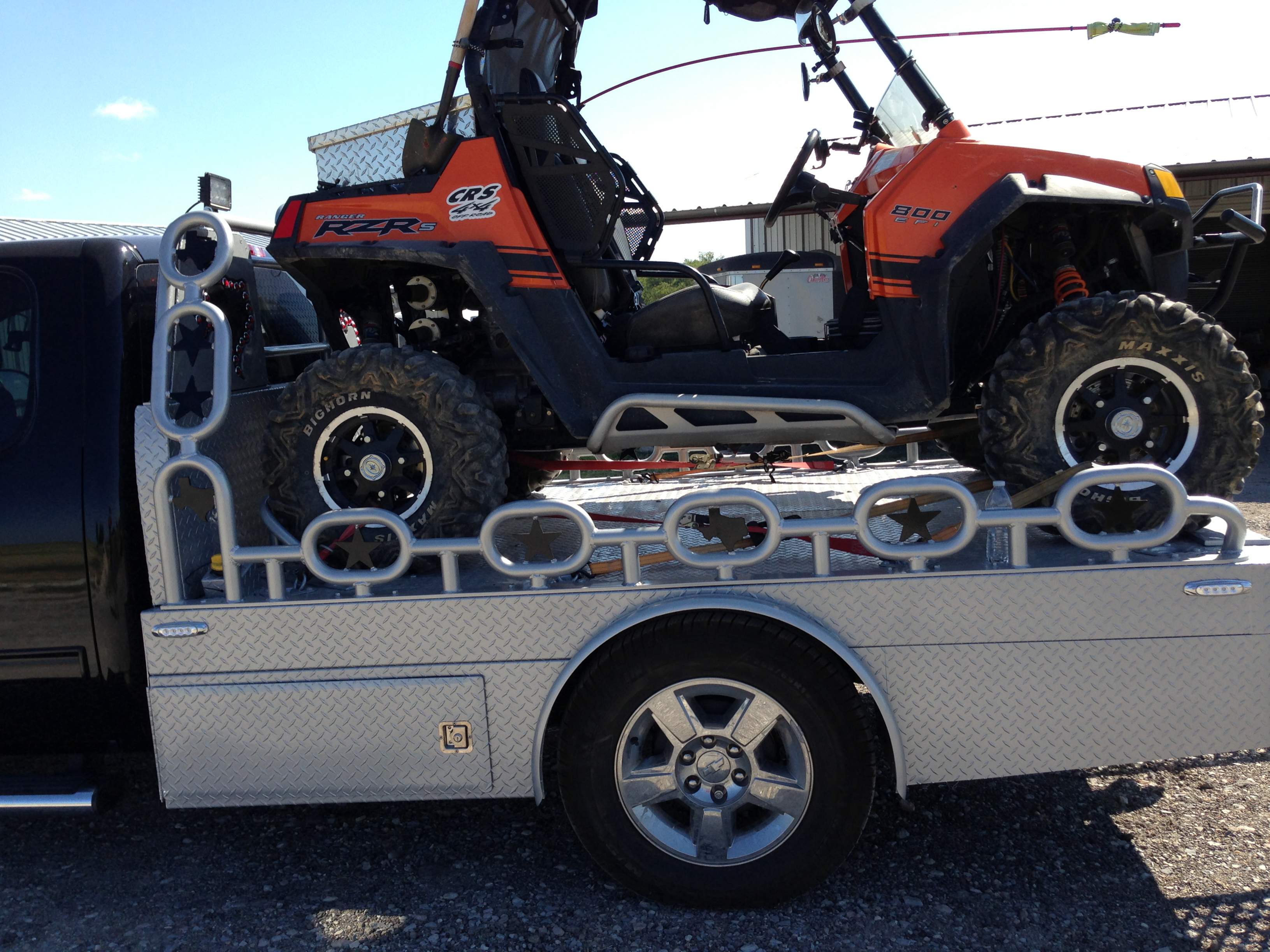

We were able to keep the backup camera along with the backup warning sensors. We wanted to incorporate the original hitch/bumper if we could.

That is the slickest bed I have ever seen:cool2:. You and 4shorts are amazing fabricators!:thumbsup::thumbsup:

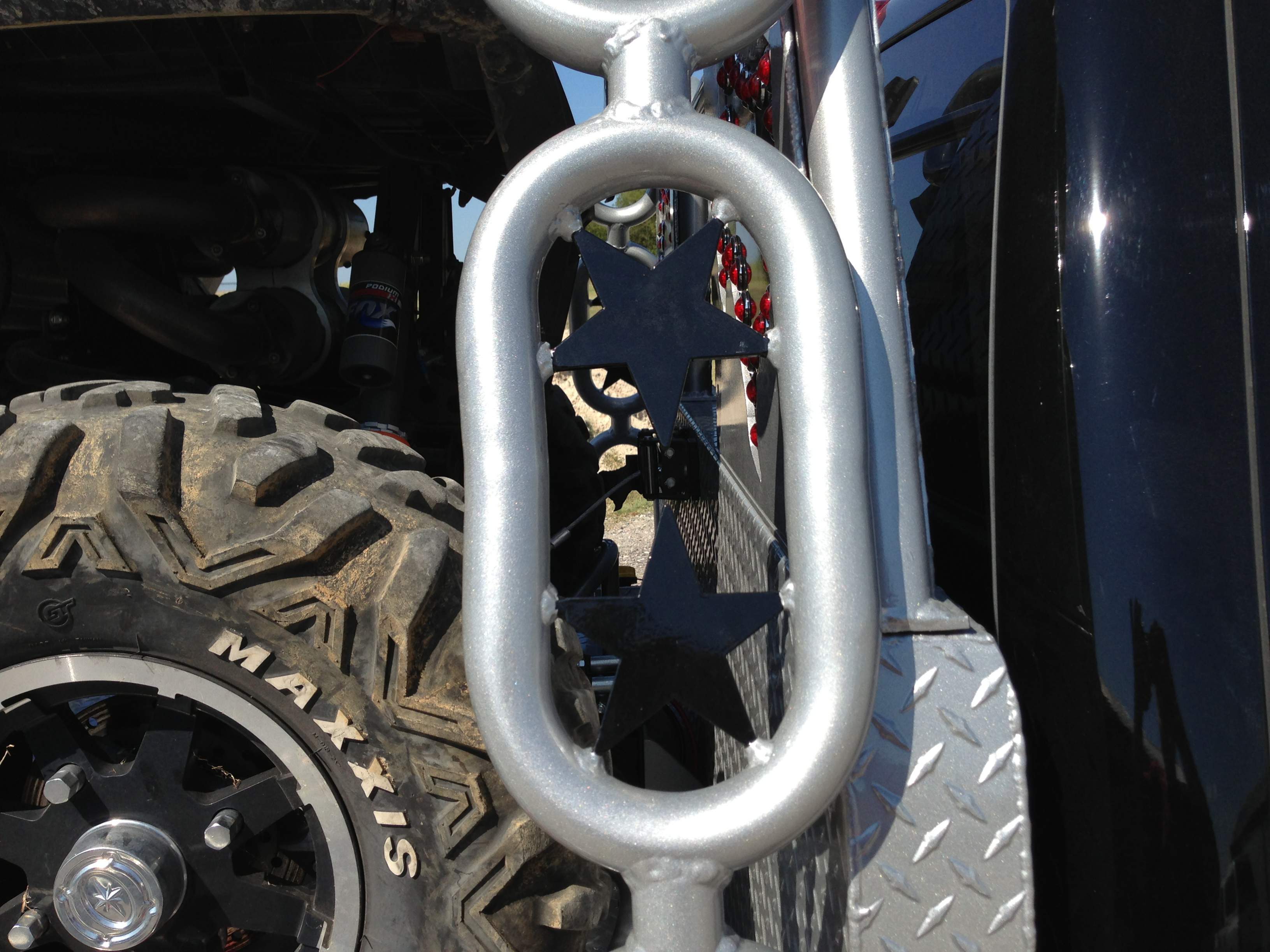

Looking good Harvey! When I looked at the links with the stars and the Texas in them my initial thought was that you cut the shapes out of the middle of the links, then I realized that I could see through the links so that was not possible - good optical illusion.
