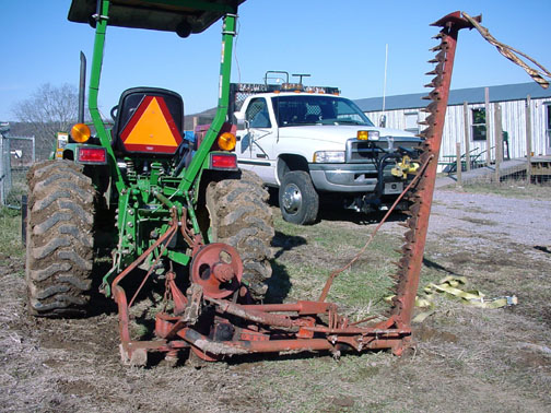

Hey guys,
I just acquired a 6' 3PH IH sickle bar mower. This unit has a belt drive attached to the PTO shaft and has a long pittman bar on it...which is obviously rotted out. wondering if any of you old IH guys might know a model number or a group of model numbers that this unit might fit into. I have look for a ID plate, but I can't find one. No serial #, no model #. It does have some IH casting numbers on several pieces, though. Anybody got a idea what model number, or better yet, have a setup manual for this mower? I can post some pics of it tomorrow, if that helps.

IH models 10,16,21,24,28 use a pitman that is 35-11/16" long
Models 12,25,27,31 use a pitman that is 31-3/4" long
If there are no Case IH dealers in your area you might try a farm supply or any equipment dealer who also sells Tisco parts can get it.
   / IH Sickle bar mower #6
We do have some new ones in inventory. The bolt pattern which you can take from the metal ends and the length are the critical parts.

This one mounts on my three point hitch. There are casting numbers on some of the parts, but I don't think that would help. There are three chains on this unit, also. 2 chains are on the right hand side (facing implement from back) and 1 chain is on the left hand side. The one on the left is connected to a arm that runs length wise through the mower housing and emerges on the other side, connecting to the swingarm (sorry, don't know the tech terms on these) close to the sickle blade. It appears this somehow keeps the sickle bar from sliding on the ground during transport. Acually, this is what I was working up to, to ask. Where does the chain on the left side hook up to on my tractor to lift the sickle off the ground when the 3ph is lifted up. Ok, do I have everyone confused now??
   / IH Sickle bar mower #8
If this one is anything like my JD one, you locked your 3PH in one position, with the frame of the mower attached to it. One of the chains went to a rocker arm, so when you raised the arm, the sickle bar only raised--not the 3PH.
Think about it in those terms and see if it makes sense.

Post a pic, we will have it figured out in a jiffy. I am almost sure that there is a break-away on it also. just in case the cutter bar hit an object hidden the grass. it will not break away from the tractor but it will allow the cutter bar to pivot rearward.then all that you did was back up to set it back in place. does the belt turn a big flywheel(sometimes call a balanced head)?

Ok, here is a pic of the unit. Another guy on the YT board thinks its a c-28, but looks like it may have been modified. He thinks it was originally a fast hitch type. Take a look and see what you think.
