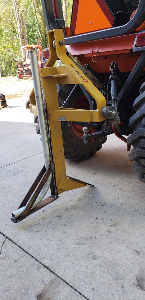

Haven't seen any post on this, but thought I'd ask. Considering an invisible fence (DIY). Has anyone come up with something for a compact tractor to break a small trench without tearing up your whole yard? Looking for suggestions, ideas, or something maybe you've used. Going to be maybe an acre in size. Yea, I know about using edger's, but that's too much like work. LOL.

edit; (I just noticed you mentioned not wanting to go the edger route.. It wasn't bad at all if you get a robust edger like I did. I think it was belt driven, stout machine. If you go with a subsoiler you might be creating more work getting the dirt back in the trench. Just my observation)
When I installed mine I rented a walk behind edger. It worked good but I seem to recall walking backwards gave a better result.
Make sure you have a brand new blade, best $6 you'll ever spend.
I didn't sweat trying to get all the dirt back in the trench, I bought several bags of sand to bring the tiny trench back up to grade.

Picture from FB showing how subsoiler was modified.
   / Invisible fence #8
I had an Invisible Fence professionally installed, they only buried it about 3" below the surface. They used a lawn edger to cut a slit and then pushed it into the slit and stepped on the dirt to close it. The wire is single-strand 12-gauge and the cut was about 1/8".
So a tractor feels like way overkill for this. A gas-powered lawn edger can be rented for about $15 nearby.
