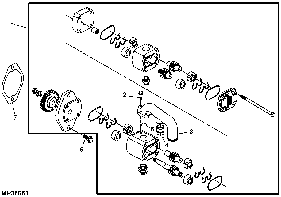

For a loader , there are better ways to control a loader than tying up the SCV ports and valves.
Just purchase a proper closed center joystick for the loader. Then tie into the high pressure supply line to the rockshaft / SCV valves with a simple T. Then return the oil with a t into the line from the scv's down to the transmission. Or use a ported filter cover.
Using scv's just wears them out and make them leak.big $$$ to repair. Loader joy sticks are cheap.

For a loader , there are better ways to control a loader than tying up the SCV ports and valves. Just purchase a proper closed center joystick for the loader.
b&d
How will a closed center valve work correctly on this type hyd pump???? I think later model JD CUT's are open-center not closed-center hyd's. On a lot of JD utility model tractors rear remotes(scv's) is JD's only loader control OPTION.

b&d
Oh darn. Wrong 4520, should have seen that
