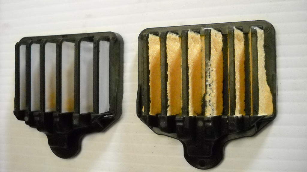

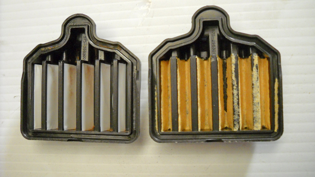

Got the saw added gas and bar oil and started cutting up the big logs into rounds. After about an hour I stopped to sharpen the chain. I pulled the air filter to clean it and found that the entire interior carburetor area was full of dust and worse. I thought, Oh carp, they didn't install the filter right at the factory. I cleaned it and replaced it making sure that it was properly installed and went back to work.
After another hour I stopped again to sharpen and clean and again the carb interior was loaded with dust. I then took a better look at the filter and thought, I've never seen a filter like this. It's just a fine mesh. I went online to look at factory filters, and they don't look anything like mine. The mesh on mine seems only to be the backing for the actual filter material. I think One Hung Lo got a bad batch of filters and just installed them as he was told.
Anyway, the saw is now difficult to start and seems to be down on power. I think the motor is dusted and shot. I'm going to take it back to HD and see if I can convince them to swap me for a new one.
Pics of the original filter on right and new on left.

The air filter on my saw is a very fine white mesh, but if it's installed correctly, it doesn't let anything much into to the carburetor.
Down on power mean it doesn't rev up when full throttle, or doesn't cut very fast or revs don't stay up when cutting? It's possible you changed the geometry of the tooth on the chain or depth gauge when you sharpened the chain. Um, try the saw again, with out the filter installed, see if it comes up to power. I'll assume the exhaust isn't plugged with soot.

Unfortunately the the area behind the filter, the throttle plate and venturi were loaded with dirt. I’m sure the fiter was installed correctly the second time. The hard start and power may just be dirt in the carb, but who knows.

The plastic mesh filter that came with the saw has the advantage of not icing up as easily as the flocked filter that you bought. But it lets more fine dirt through. I've never seen a mesh filter in real life. Here on the coast we get the flocked filters. Arguably that's what your saw should have come with. While it get colder there than here, icing up filters is not going to be a problem where it's dry.
I agree about the Echos- I got a CS-352 for brush. It's lighter than the equivalent Stihl and easy to start. But the flocked filter on it does let some fine dirt through. I added some oiled foam filter material in the air box where the majority of the air comes in which helps but doesn't completely fix it. My Stihls, even ones with flocked filter, don't have that problem. The larger Echos have different filters that may be better.
