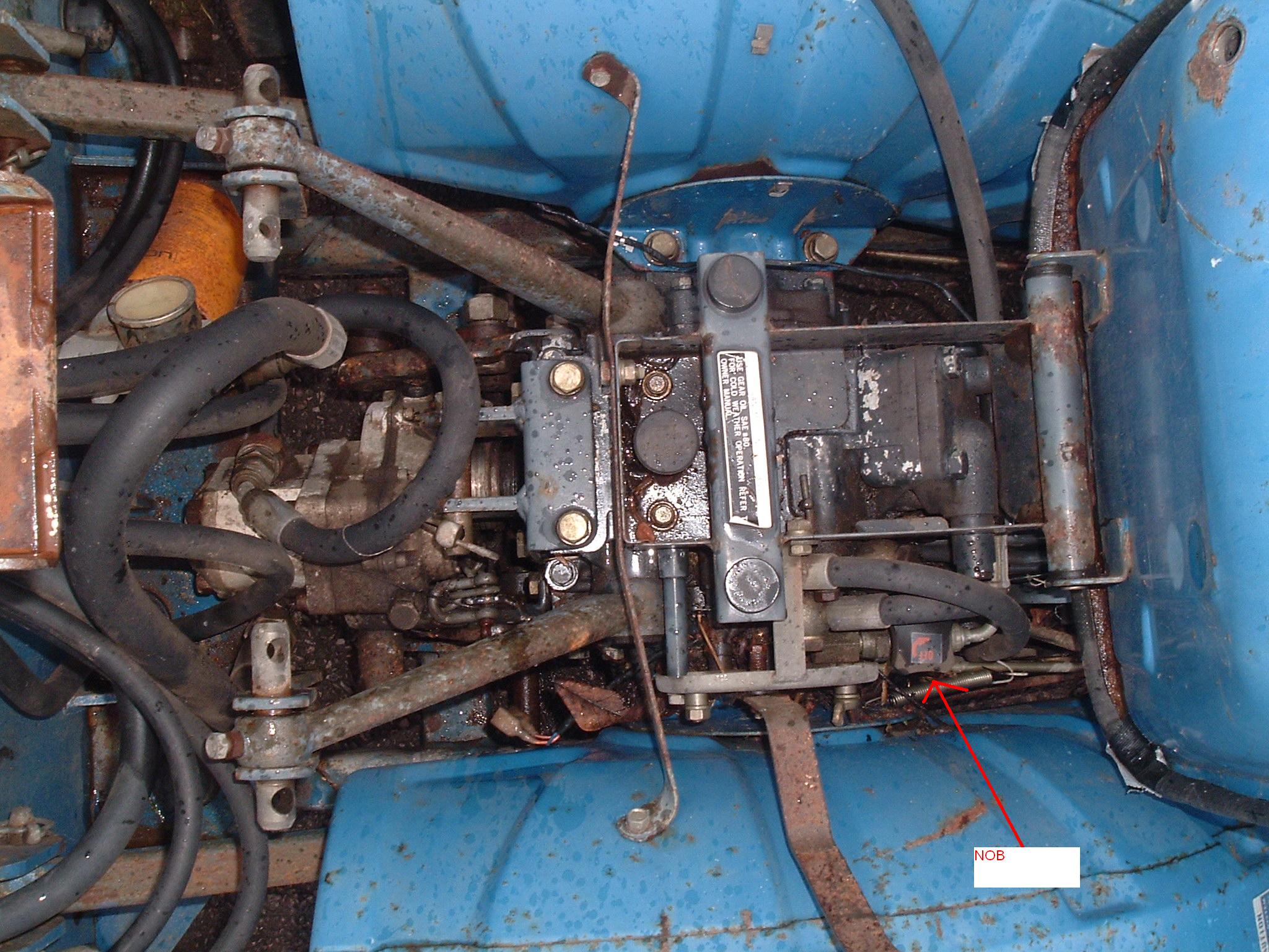

Do you have a knob directly under your seat between your legs, that controls how much the 3ph recieves power???????...........in other words if I tighten this knob all the way in, the 3ph doesnt move, as you describe. If I barely open it, it is very slow; but if I open it all the way the 3ph speeds up as it goes up and down........Maybe this is your problem??????.......just thoughts Bud...........God bless........Dennis
Mines a different machine, however would the control under the seat also control the hydraulics to the front end loader?
   / Iseki 3 point & PTO #8
Marcle,
You have the "Knob" under the seat.
It cuts off the hydrolics to the 3pt and send it to the FEL
It should be all on or all off,
If it part way you'll be slow but both will work.
see attache markup of your pix.
BTW: You should clean the input pickup screen
it were the hard line goe into the side of the transmision.

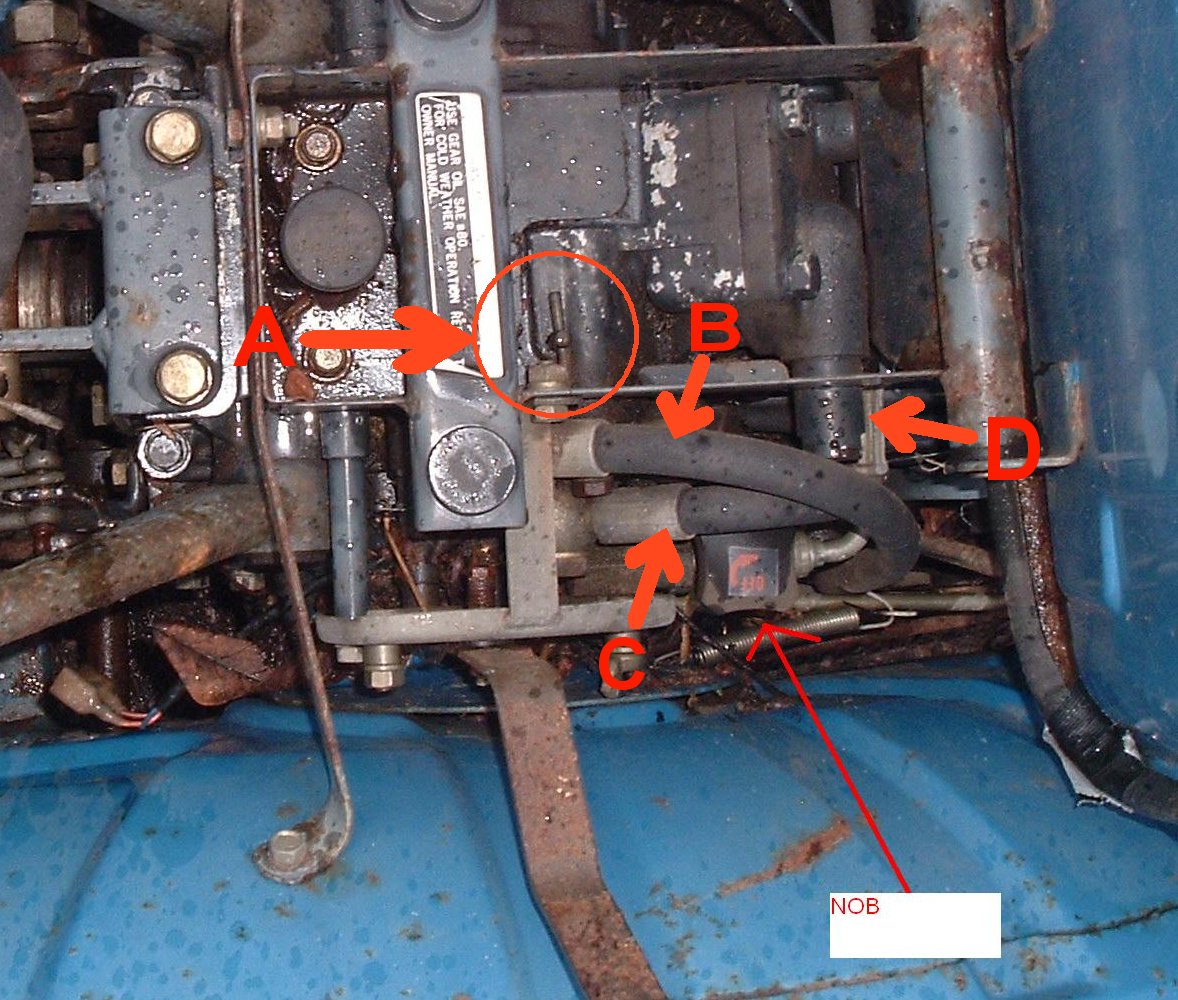

Hi Dave,
The knob you've labelled is for a hydraulic take off on the back of the tractor, in my case not connected. I've arrowed a flow control valve knob (A) which controls the rate at which the 3 point link arm raise and lower. B and C are the hydraulic hoses which go to the front end loader. D is the non user pressure relief valve. Before I change any settings I'm going to fit a pressure gauge to check what the pressures are.

I haven't figure it all out,
I get a headack every time I look at it.
Mine is the same as yours
but has an Aux port quick connect ,that I've never used.
You should have 3 hoses going to/from the FEL control valve.
1 high presure input
1 low presure return
1 high pressure return conected to down stream devices.
Not sure what that relief valve control.
It look like it for the 3pt only.
I haven't played with any of the knop becaue mine wirk fine as is.
But my 3pt doesn't gou up or down. Not an issue becaue backhoe make it useless.
I beleve the Knob I show would have to be turned to allow fluid to get to 3pt.
But it's may be as you said for the Aux port.
I don't think the little Tee handle (3pt lower speed) has anything to do with
the FEL.
Hard to tell what OEM and after market for the FEL
would be nice to have a barebones Tractor next to mine.
