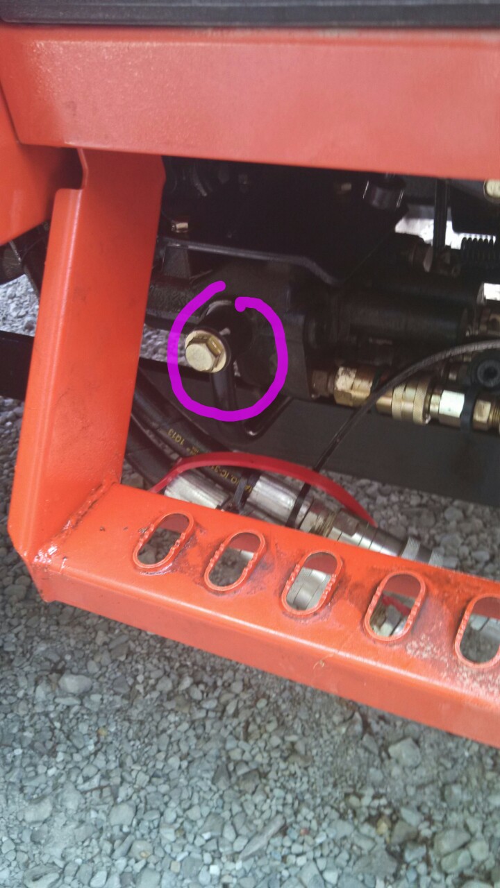

A couple of days ago in the then 90+ degree heat and 3/8 of a mile from home hauling construction fill for a neighbor I heard a loud pop after I tried to raise the full loader bucket. Hydraulic fluid was coming out at a fast rate. I shut It down to try and find the leak but that was not very easy. A couple more startups and the neighbors help to spot the leak and we narrowed it down to this banjo bolt/O ring. The O ring had popped up out of the groove because the bolt was very loose. We put the O ring back into the groove and tightened the bolt and all is well. This occurred at 195 hours, and I lost over a gallon of fluid in seconds. You might want to put a wrench on that bolt. IMG_20130916_143208.jpg

I had a seep at that bolt, caught it before a major leak, torqued per manual. No more leak. Amazing how many of us have the same little issues.

not sure if you've ever checked your wheel bolts and loader frame bolts but it would be a good idea as wheel. i had several wheel bolts loose and one loader frame loose

Thanks. I checked mine today and it was a little loose and wet. 58 hours.

Several times now.. tnx. But I never thought to check that hydraulic joint bolt
