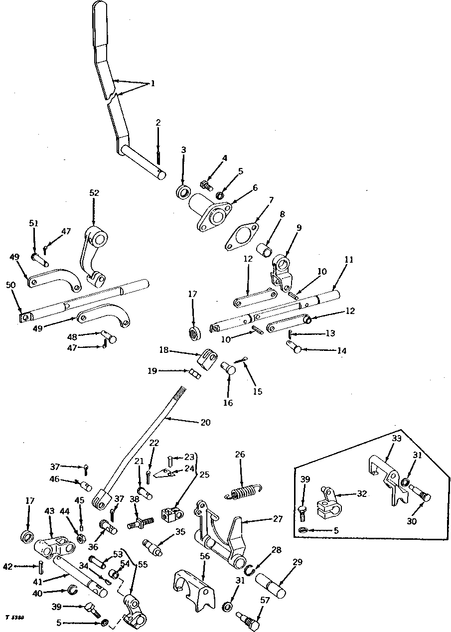

2010 JD gas: The PTO will engage with the lever but quickly slips out. Can the pto gears and shafts be reached by removing the rear plate or is it more complex than that. My friend who traded me this tractor is a former MF dealer and is very familiar with the gears on the MF but never entered a JD. Any quick suggestions or warnings for one Pro and one amateur. Looking at the parts schematic, does not look like any clutch type mechanism.

You can adjust engagement by turning clevis(parts key #18). Which rear cover removal are you referring to. If a friend traded me a 2010 he wouldn't be classified a friend any longer. :)

The rockshaft housing needs to be removed to access the pto clutch and linkage. Before removing the rockshaft housing, be sure to remove the top cover so you can disconnect the internal oil pressure line.
