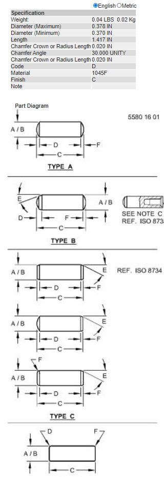

I think retaining pin should just tap out. Removing pin may require some "heating". Spec's for pin are listed in photo below.
One needs to drain the hyd oil in order to remove/inspect L/D control shaft. Be sure to place L/D control lever in "D" or minimum before removing shaft for easier reassembly.
