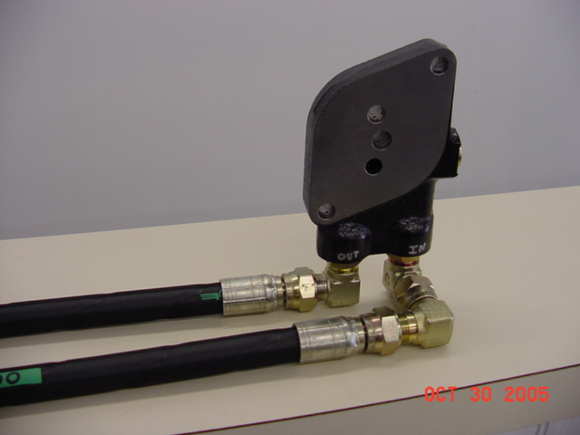

Hey Everybody, I am in the process of installing a two spool valve on my JD 2320 so I can have two sets of coupler's at the rear of my tractor for attachments. I know that I need to attach the new SCV to the auxiliary plate just behind the loaders SCV, but the thing I need you guys help for is which plug on the bottom of the auxiliary plate is the Pressure and which is the Return. I know there are a few guys on this forum that have done this, so wondering if you guys would share your knowledge. I guess I can do a trial and take a guess at it, but not sure what will happen if I feed pressure into the new SCV in the wrong direction. Any input would be greatly appreciated

Here you go, don't forget to install the little set screw/plug or nothing will work correctly.
FYI the 4110, 2320, 2520, 2720 all use the same setup so don't limit your searches to the 2320. There are quite a few great threads on adding remotes to 2520's.

Thanks kennyd,
I was actually thinking the opposite so I'm glad you clarified that with me. I was planning on going 3/8" hose to the valve and 1/4" hose from valve to couplings. Will this work fine?
   / JD 2320 3rd and 4th SCV valves #4
Yup, good plan.
