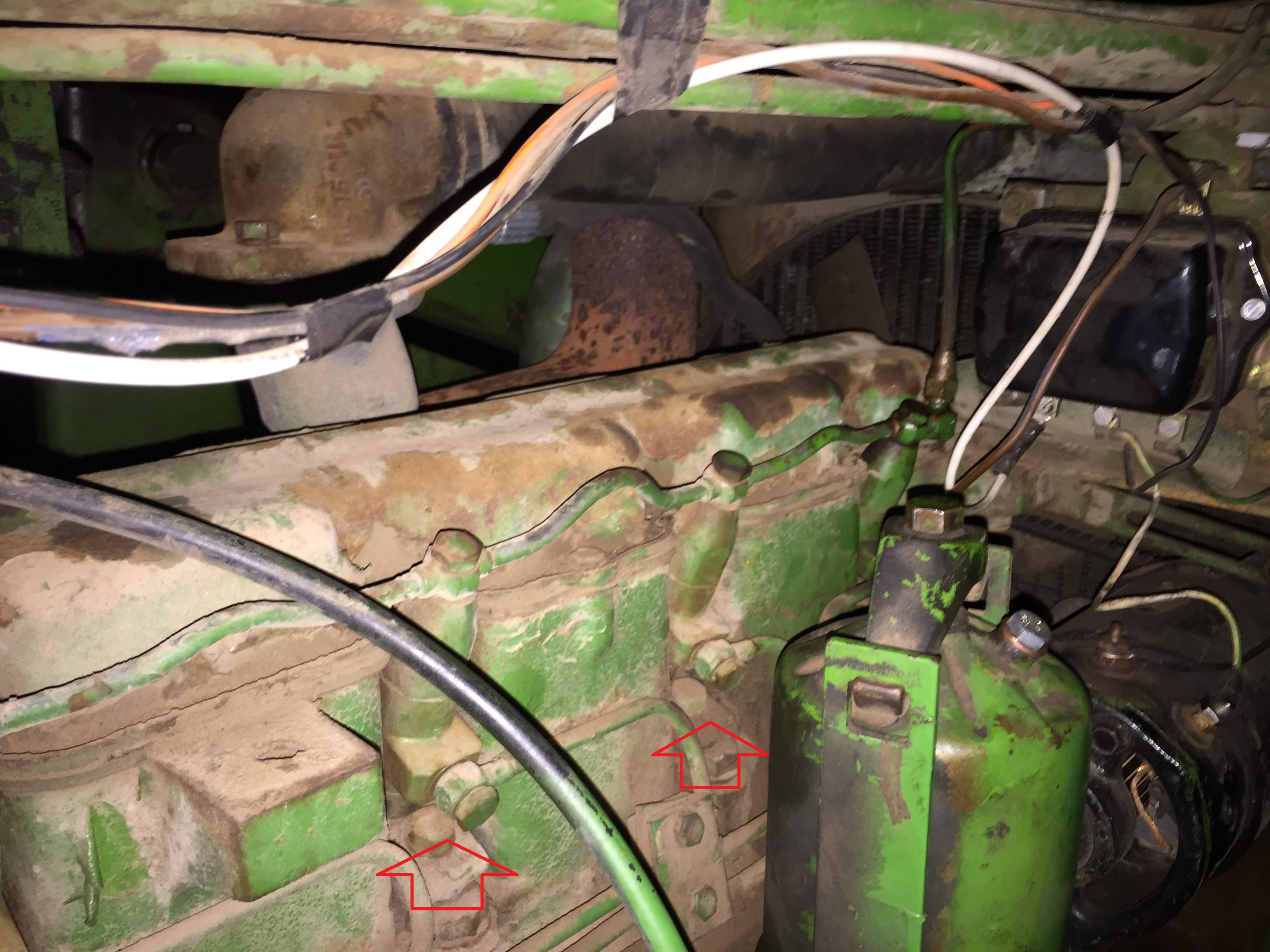

I got the fuel filters to bleed. I disconnected the line at the injector pump that came from the fuel filter, gave a hand prime on the lifter pump and got fuel. Then I opened up the fitting shown on this photo and cranked the engine. Air spat out a bit, eventually it started, ran a few seconds then quit. That fuel line where I got air to spit goes back to the fuel tank. So I do believe it's an issue of air in the lines. However, I just don't know where to bleed now.
You bled the return line that goes from the injectors to the tank (as you described). It got some of the air out of the lines, but not enough (can't really get all of it). What you want to do is open the fittings at the bottom of the injectors and crank the engine....that is the supply side on that model injector. You can see the lines that come from below and connect on the bottom of the injectors...they're coming from the injector pump. Crack all of them, and crank the engine. You're almost certainly going to get air, and it should start...let it run, and tighten each fitting once you don't see bubbles coming out.

Are you referring to these fittings?
