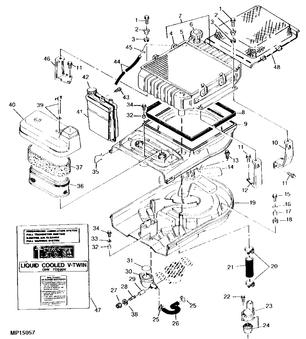

The book says to be sure the cooling fins are not plugged....are those kind of like heat sinks? just metal fins coming off the engine?? Because i have a liquied cooled system would I still have cooling fins? if so...where are they!? i swear this engine was installed upside down, i can't get to anything!
I'm going to fill up with ethanol free gas today with some more seafoam.
Oh...the coolant level in the off-white plastic tank (reservoir?) tank is good...but i opened the radiator this morning and it seems low to me...but there is no fill line inside the radiator...how am i supposed to know how much fluid should be in the radiator itself?

I just put two pints of water in the radiator....its not filled to almost the brim where the radiator cap goes on. Can i have too much fluid in there?
