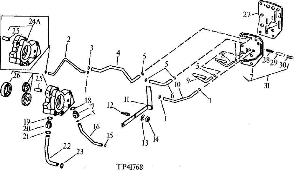

I have a JD400 67' and I removed the reverser valve, in doing so a long (appro 12") tube came loose and I cant see where it plugs into. My manual says it goes to the reverse clutch but I cannot get my hand/arm in to feel for the hole. If anyone can give me a ball park area where the tube will go to at least I will have a chance. Photo would be better. I have tried a cheap camera scope but did not help. I can send photo via email of the tube and the reverser opening in the transmission.
   / JD400 Reverser Valve tubing #2
Here's the parts schematic for the lines. Sorry but it's been too long since I've seen the inside of trans to give any more assistance.

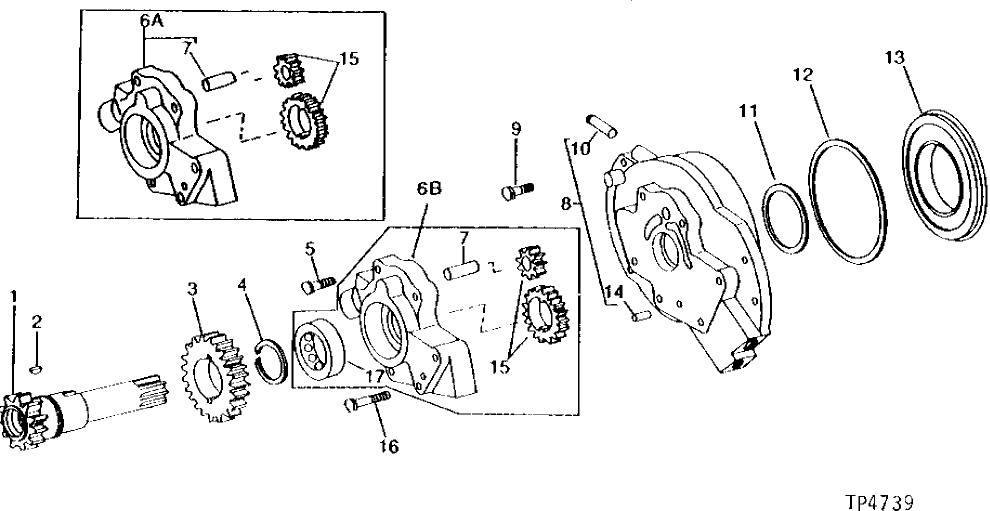

Look at part KEY 8 in this drawing. At approximately 4 o'clock position are two ports. One is for the forward clutch pack, the other for the reverse brake pack.
I am not sure which is which, but hopefully you only will have one missing a tube. Since I have a 50/50 chance, I'll guess the lower is the reverse brake.
