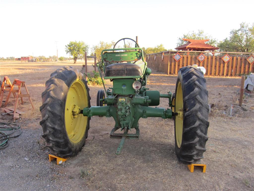

The square seat on my 1949 JD B is attached to the battery box. So that's what I'd do to get that type of seat on a pre-48 B.
Good luck.
