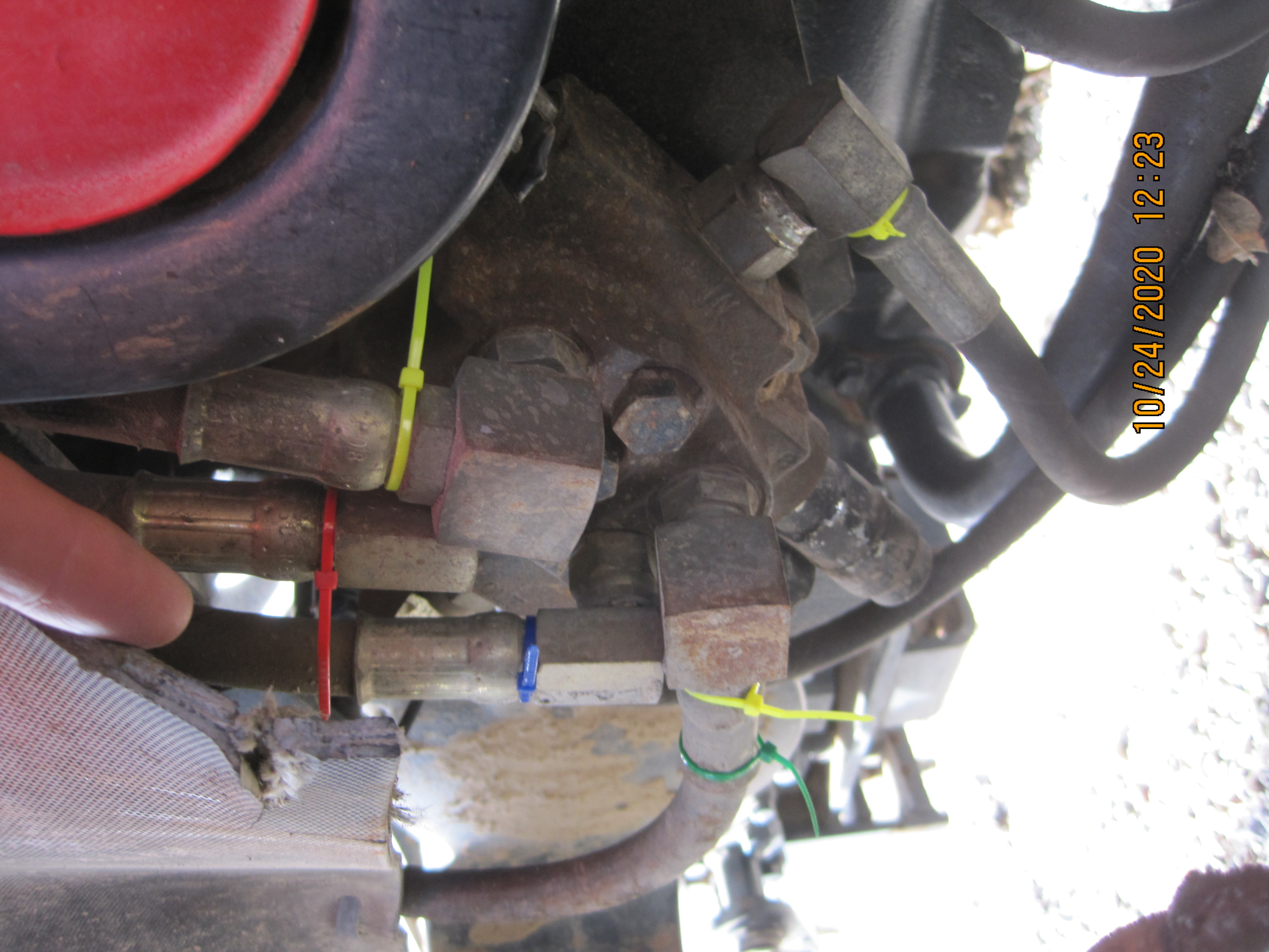

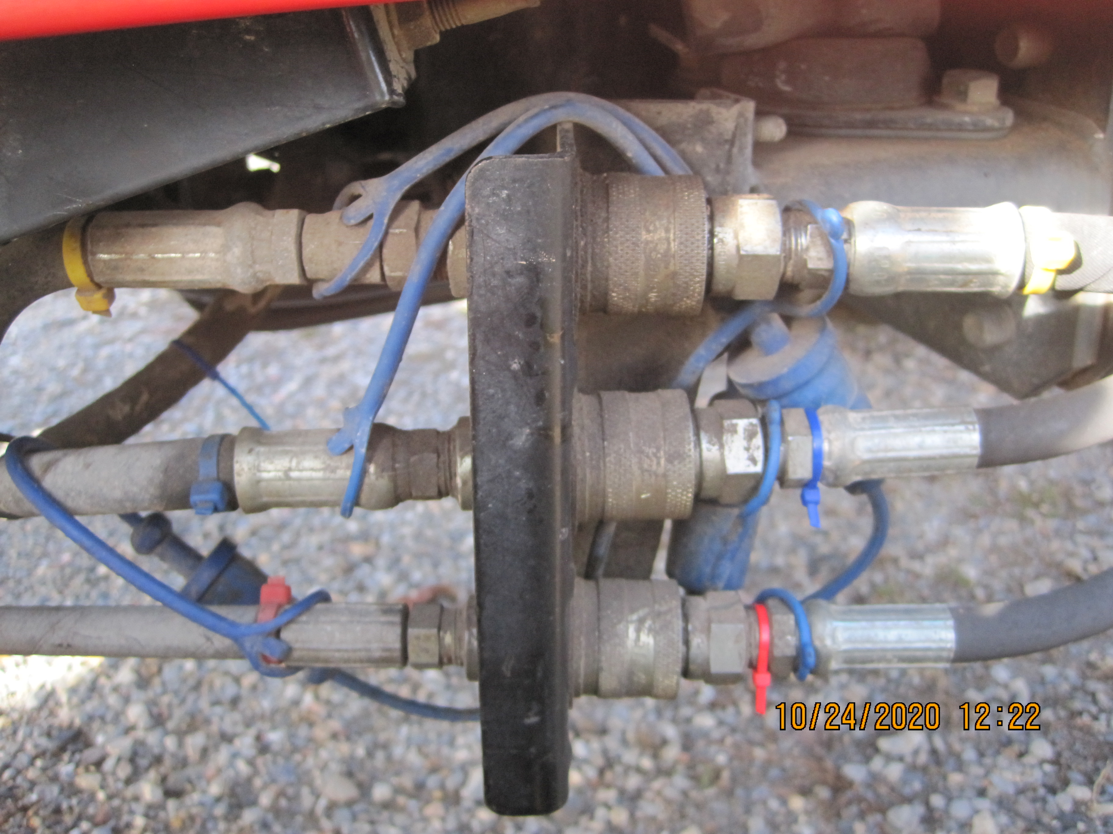

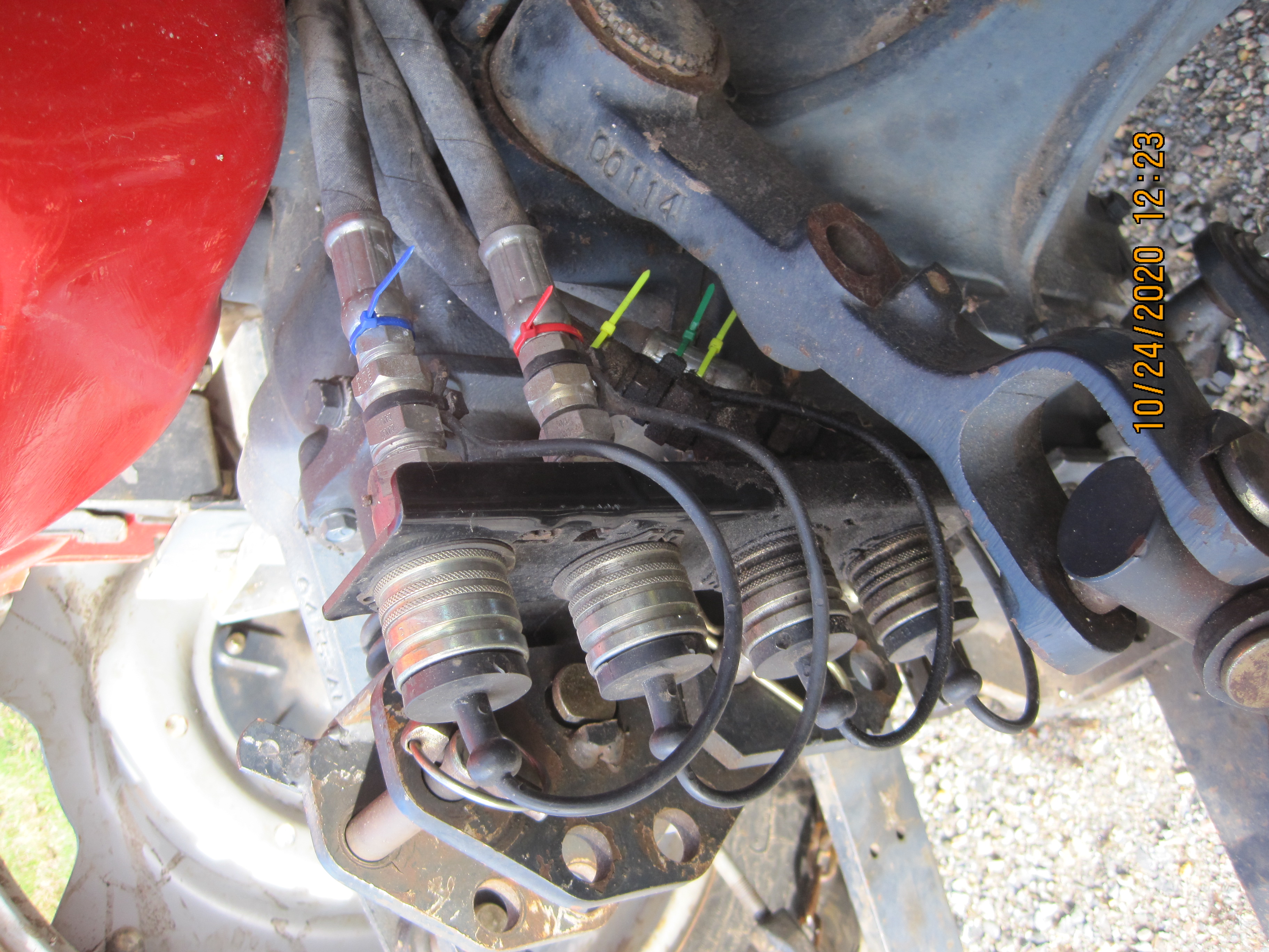

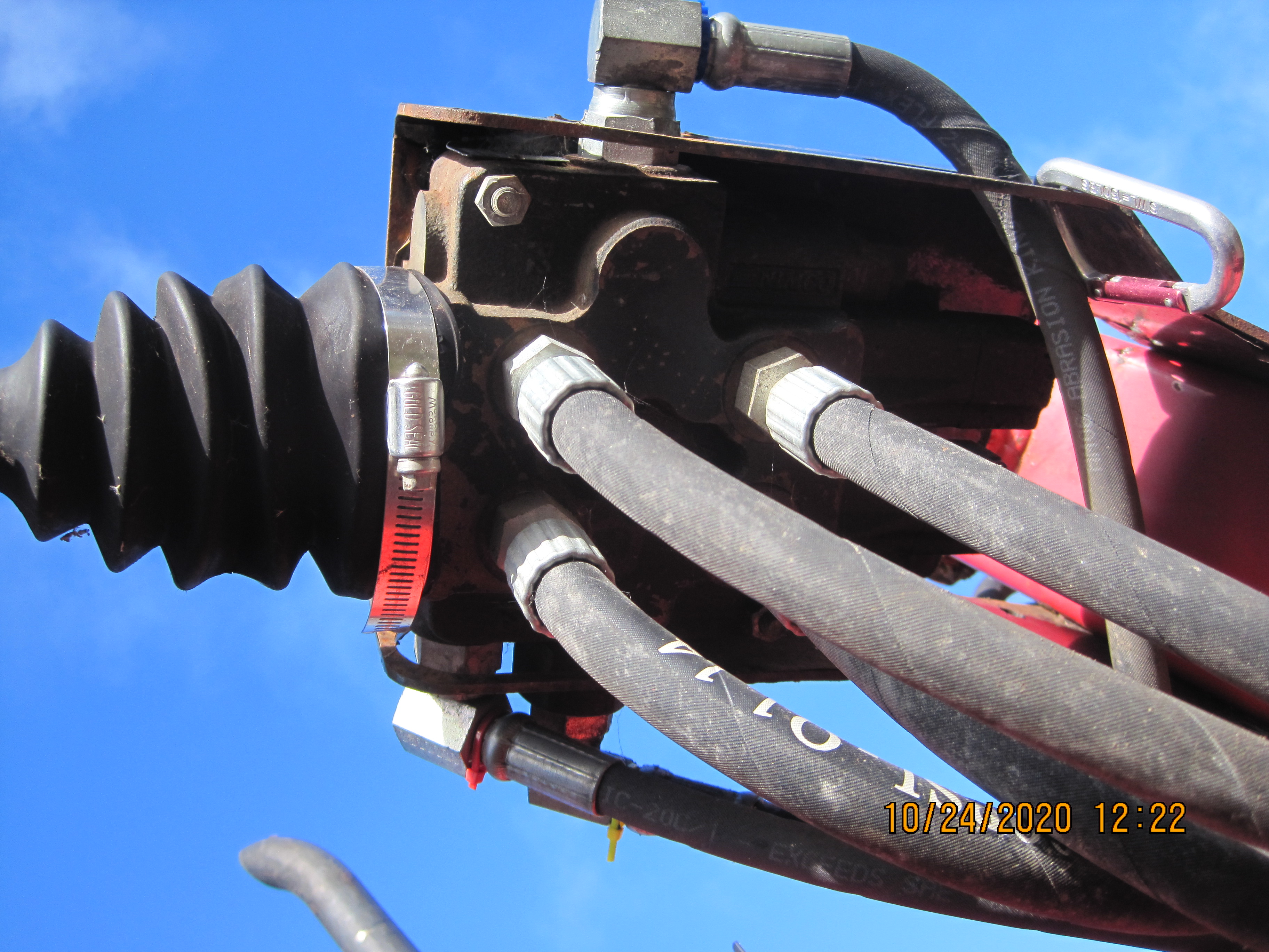

Changed from a Mf 35 to a Mf 1455. I'm not liking the complexities of the newer tractor. It has a 1040 loader with a loader mounted joy stick. On the right side of the seat is another joy stick to operate the dual remotes on the back of the tractor. From top to bottom, the remotes are labelled blue, red and the next two are yellow. It's unclear to me which ones work together (delivery and return) and also which outlets do the front to back and which do the left to right function. I'm going to try to post pictures. Help with understanding it's operation would be appreciated! Note, the " yellow " tagged lower hose in the photo, relates to "in" port for the joystick. I ran out of different colours.
That yellow hose comes from the loader mounted joystick. In which I also used blue (delivery) , red (return) and yellow( delivery to the remotes joy stick !). IMG_2677.JPGIMG_2676.JPGIMG_2674.JPGIMG_2675.JPG

I would expect that the top two connections are one valve and the lower two are the other.
I can't see any reason that they wouldn't be paired that way.
Also if you can watch the hoses and operate the valve you could see the hose jump when the valve is actuated.

From your pictures, Blue and Red would be a pair of connections.
While the Green and Yellow would make the second pair of connections.
