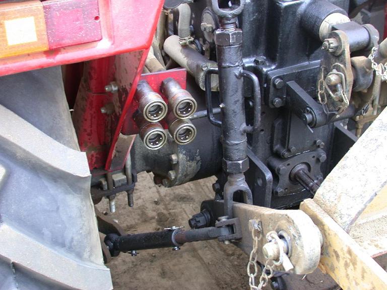

I don't know if the rear tractor hydraulic system is closed or open center...maybe you can tell me? I'm trying to get this information for the Top and Tilt system.
I was told that I will not need the joystick controls because the tractor has 2 sets of rear hydraulics on it...is that correct?
Thanks
   / KAMA Hydraulic Question #2
Your tractor has an open center system which means the hydraulic pump is always pumping fluid. Fluid is continuously flowing from the tank thru the pump thru all valves and back to the tank.
As I indicated in a post in a different forum, you already have two rear remotes which can connect to a hydraulic top link cylinder and hydraulic side/tilt link cylinder. You should have 2 levers on the fender that will control these rear remotes.
   / KAMA Hydraulic Question #3
Mad was right in the other post. All you need is the cylinders, hoses and end fittings.
   / KAMA Hydraulic Question #4
regardless... you need to get some plugs for those disconnects to keep dirt out.
