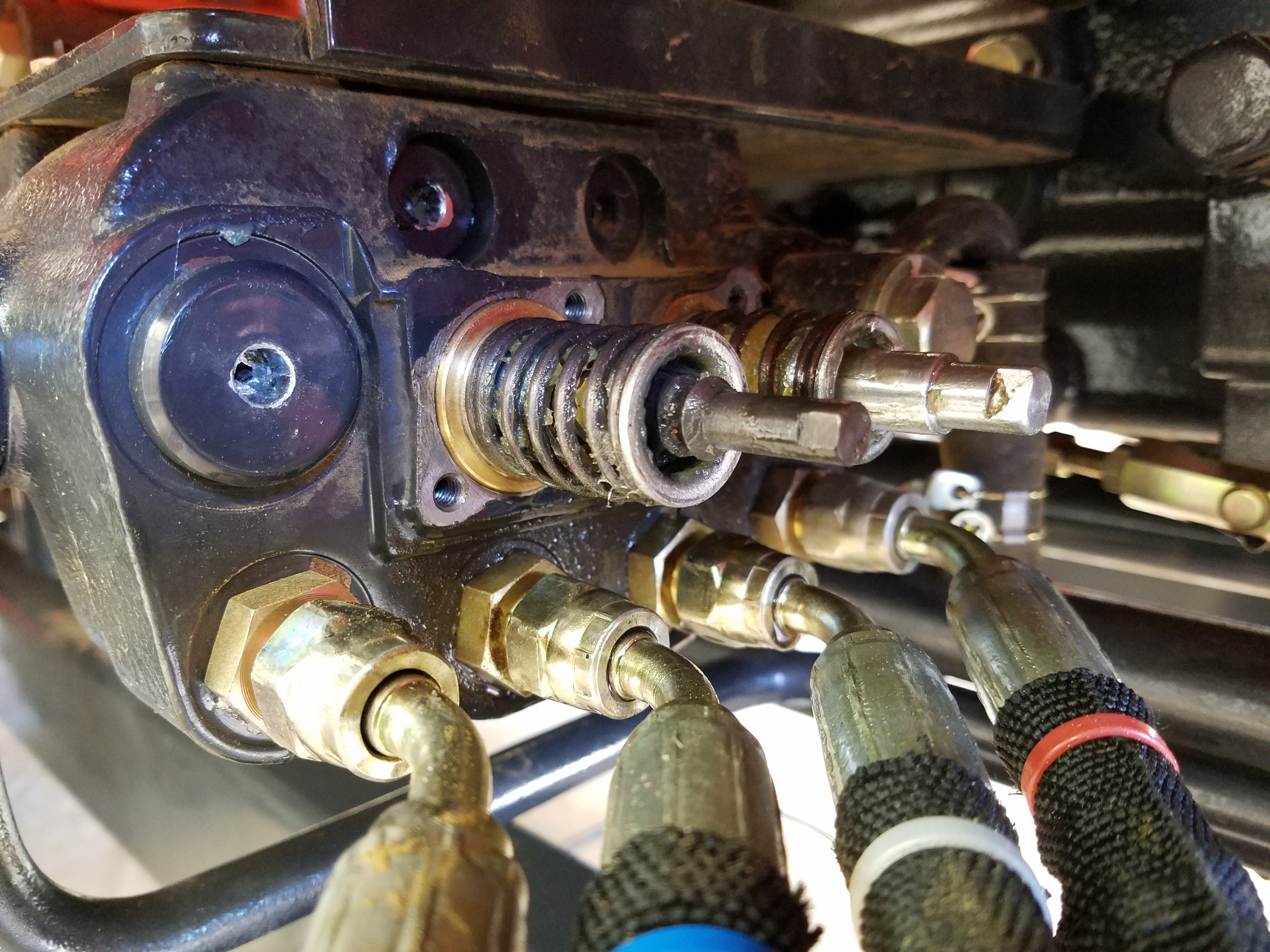

The joystick controls have all been working fine. However, now I am unable to get it to go into the float position. It's as if the float position is no longer there. Has anyone had this problem?
/ Kioti CK35HST - FEL Float Issue #2
ptouch, I haven't had that problem, but it is not uncommon. There are springs in there that can break or wear out. Rebuilding the valve is not too difficult usually, and usually takes care of it. This is by no means Kioti specific, it happens to all detent valves.
Oh, and welcome from a rural area in Southern California. ;)
Also, the valve can be left connected to the control lines and pulled out next to the right rear tire to work on it. No need to disconnect everything. Still a big pain getting to it under the seat though.

Hi Davrow, Thanks for the information. I believe that other than a little HP, our tractors are the same. I just finished removing, cleaning, greasing, and re-installing the covers on the front of the hydraulic thingy (technically speaking). It sounds like I need to do the same thing on the other end of the Hyd. Body ***'y (as the manual calls it). Yea, it probably is a pain getting to it under the seat but, hey I wouldn't have it any other way. I'll give it a shot and post the results. Thanks again for the advise.

Hi Devrow, Well I have been through the spools on both ends (item #'s 5,6,10 and 11 of the Body Assembly (item # 7 - see attached diagram). However still no float position. In reading the manual (always the last resort) under "Disassembling the Joy-Stick Valve item #6 it says to remove the load check plugs (item #8) with the O-rings, springs, and load check poppets from the check valve ports. The first thing that is confusing to me is that the manual refers to "load check plugs", and "check valve ports" plural. Yet the diagram only shows one item #8. Enee Wayz, moving on. I did attempt to remove the Load Check Plug shown in the diagram using a Craftsman T40 Torx Bit Socket, but it wouldn't budge. It just stripped the inside of the load check plug where the socket goes in. Please also see attached photo for image of what I believed to be the load check plug . It was also, interesting to note that the diagram shows the whole body assembly up side down from how it is actually installed on the tractor. Any thoughts on this mess?

ptouch, looks to me like you wanted steps 1, 2 & 4... steps 3, 5 and 6 are not for your issue. Item 10 is the float spool, that's where I would expect the problem to be. And it looks (from the drawing) as though the spool itself is removed from the other side of the valve from what you show in your picture.
/ Kioti CK35HST - FEL Float Issue #6
Plug 8 is on the other side of the assembly from in your picture, too. I think you were trying to remove 16... those have weld tabs to keep them from backing out or being removed.

davrow, I have done steps 12&4, and everything looks good. That doesn't surprise me since the controls were all (except for the float) responsive and smooth prior to spool removal and inspection. You know, I'm beginning to think it may just be in the cable adjustment. Of course, I probably should have checked that out in the first place, but noooooo. I always say "why do things the easy way when there's a hard way that they can be done.

As for your load checks, you well have 2 plugs that are the same and some what inline with each spool. On yours they are inline and just above each spool and set in the housing a little.

Thank you for the location info on the load checks, and sorry for not getting back sooner. I did remove them and check them. they look ok and seem to be functioning properly. As it turns out, while working on the tractor today I finally found the problem. I finally tracked it down to the hydraulic hoses that come from the loader to the tractor. While reading the shop manual I derived that the only joy stick detent position available was supposed to be the lift/lower float position. Mind you, I only had one detent position on my joy stick control lever. The problem was that it was on the bucket dump position, and it caused just the bucket to in effect float (not the lift/lower). Before reading that there was just the one detent position, I thought that the one I had on the bucket dump position was just a (practically useless) feature, and that there was some other issue causing the "no float" issue for the lift/lower function. So, now the light starts to come on. At this point, I begin to suspect that the hoses from the FEL were incorrectly connected to the hoses from the joy stick valve body. Enee Wayz, even though the color identifiers on the hoses indicated that each of the hoses from the FEL were connected to the corresponding hose on the tractor (i.e. yellow to yellow, blue to blue etc). That was not the case. I was able to connect each of the FEL hoses to the correct and corresponding hose from the tractor (Joy Stick Valve Body). And, Wha La. Everything is working fine now. Some times it takes sooo loooong for me to get it. Thanks again for the help. You too Davrow.

Arc weld, I believe that the hyd. hoses were color coded by the manufacturer prior to shipping. Then the connectors were color coded with the rubber plug thingys when the dealer attached the FEL. Yes, I did assume that the hyd. hoses were correctly connected. That is until I had checked everything else that I knew to check. So by the process of elimination. It had to be hoses from the FEL connected to the wrong hoses from the Joy Stick valve body....and that was what the problem was.
